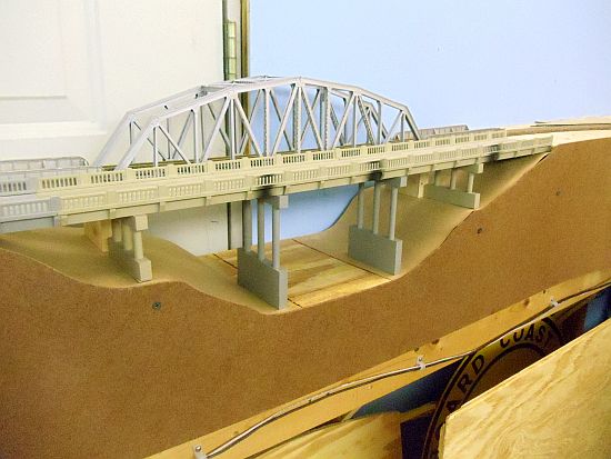

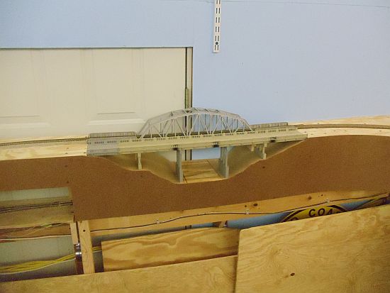

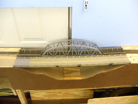

Next is the installation of the highway bridge.

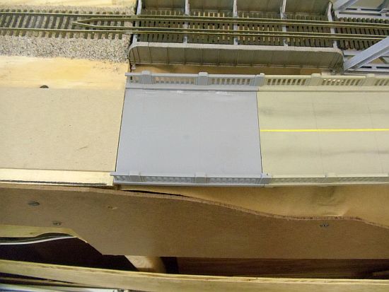

I added a new section to fit the bridge in order to get the proper length.
I couldn't match exactly the railings on the end section piece but I think it looks okay. I'll put a speed limit sign in front of it.

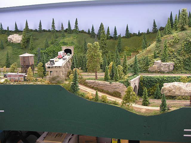

By the way, the highway bridge and the bridge supports came from the old layout. Here is how it looked on the old layout.

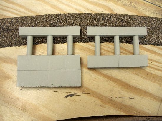

As I mentioned, the supports were from the old layout.
I measured how much I needed to remove from the old support and used the Xacto razor saw and removed the unwanted portion. In the photo below you can see the original height and the one with a portion removed.
I used sandpaper to fine tune the correct height.
And the new support is in place.
I repeated the process for the other end.

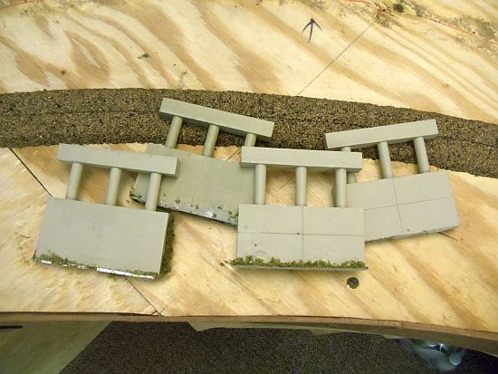

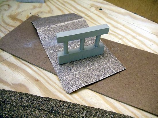

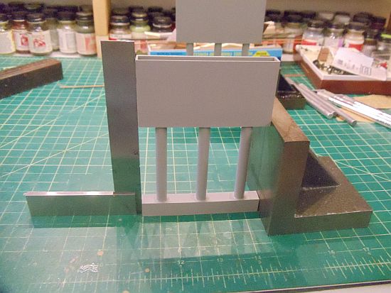

I built two additional bridge supports for the center portion of the bridge. By the way, the bridge and supports are the Rix Products Early Highway Overpass.

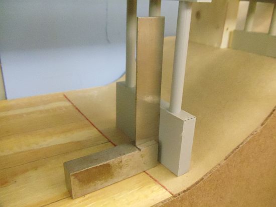

I glued the poles to the top section (in the photo, the top section is on the bottom) of the support. I used the square to ensure all was level. I think I've mentioned in the past level is good.

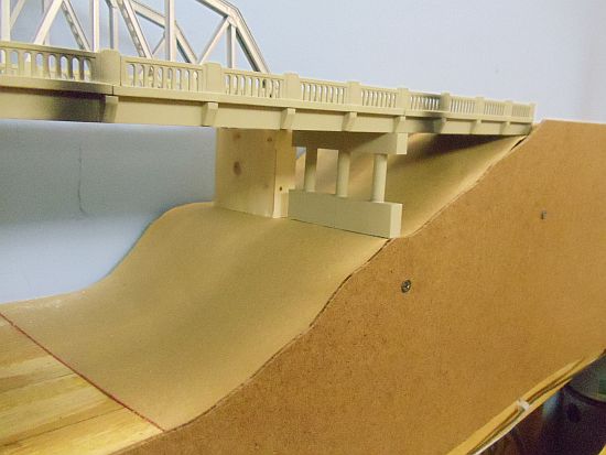

I then placed the completed support section under the bridge where it will be located.
I then marked the location on the paper for the support.
Once in place, I raised the poles and pushed the top up against the bottom of the bridge ribs.
Once I made sure all was level and straight, I glued the poles in position.
Here is an overall view of the railroad bridge and the highway overpass.
