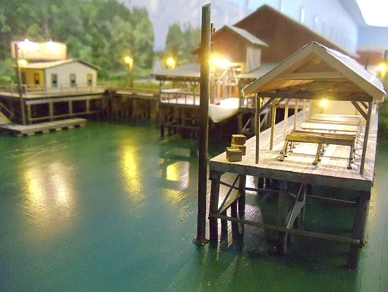

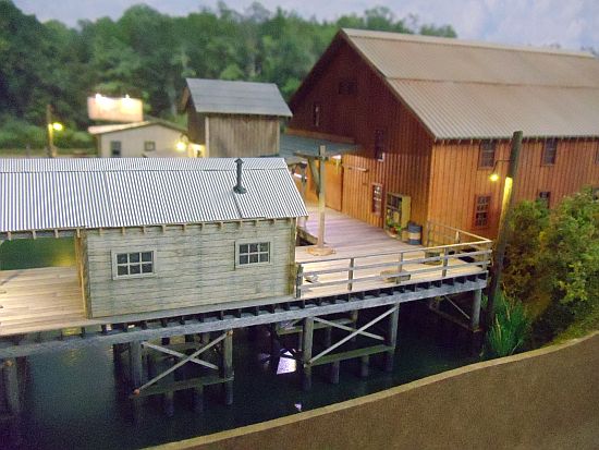

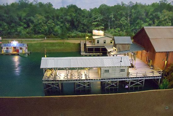

I last showed the little panel with the on/off toggles for the Delwin's diorama. All the lights are in place now.
Here is the diorama, the little panel can be seen in the bottom of the photo.
1. Controls the utility pole lights.
2. Controls the office billboard and exterior lights.
3. Controls Bud's Gas & Bait lights.
4. Controls the boat lift shed and the net drying shed.
5. Controls the large Delwin's billboard sign.
6. Will eventually control the country gas station and Three Fingered Freddy's Fireworks.

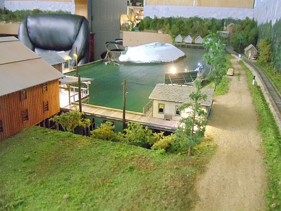

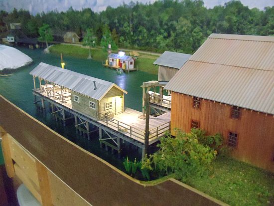

Here are a few photos of the diorama lights.
Here is the country store and Freddy's.

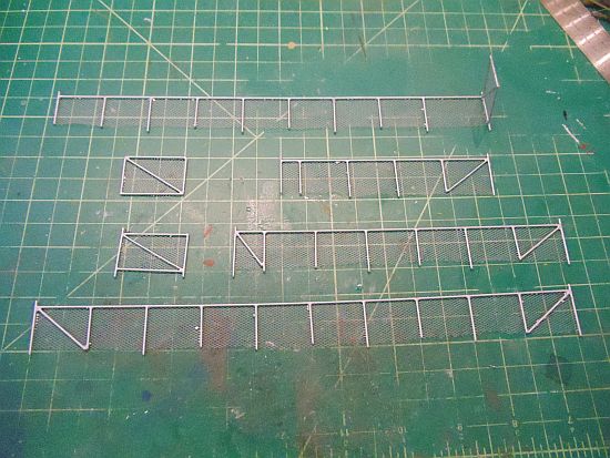

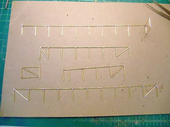

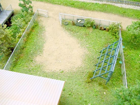

I wanted to add a fenced in area around one side of Delwin's. I got some round brass wire from Details Associates. I don't remember what size I used. It was either .019 or .022" diameter.
I drew a fence pattern on some extra cardboard. I cut the fence posts(wire) to length and then taped the wire down. After taping the horizontal wire I soldered the vertical post to it.

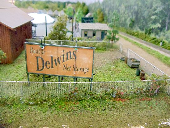

Fast forward and here is what I finished up with.
I test fit the fence in place to make sure it all fit per my measurements.
For the chain link fence material I used wedding veil stuff. It's called tulle.
I cut the material to fit the fence and used a toothpick to apply super glue to hold it in place.

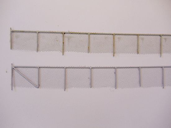

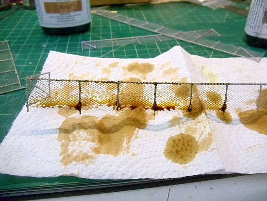

I wanted it to look like it has been in place for several years so I used Hunterline A&I Rust and Cordovan stains on the entire fence.
Ok, so I did a little bit of a saturation but it all came out fine.
Here is a before and after staining look. New on bottom and old on top.

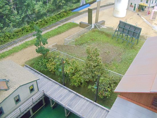

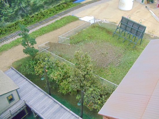

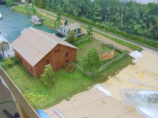

While the fence was drying I prepped the area. I used some light earth to represent where the grass was killed to add the fence posts.

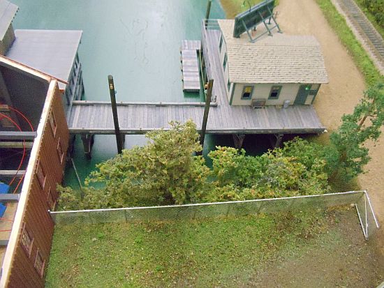

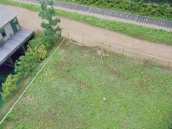

After the first section of fence was installed I added some additional scenery between the fence and water.

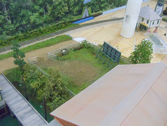

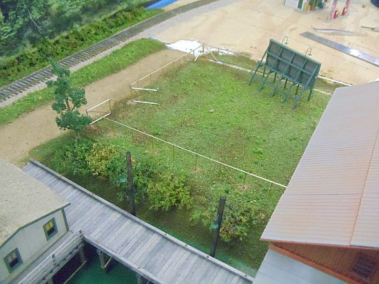

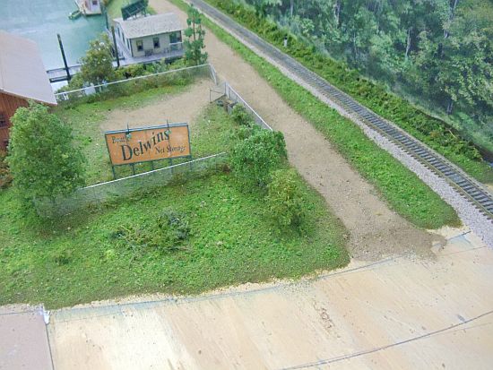

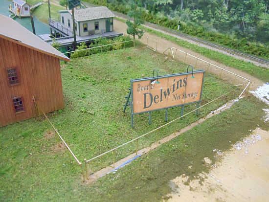

I installed the remaining fence sections and place the large billboard within the fenced area.
I added more scenery stuff and a few small details.
I added some weeds and vines at the bottom of the fence.
In the next photo you can see the matte medium glue is still wet.

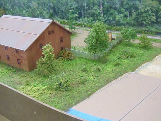

I then extended the road a little.
A little more scenery material to the area.

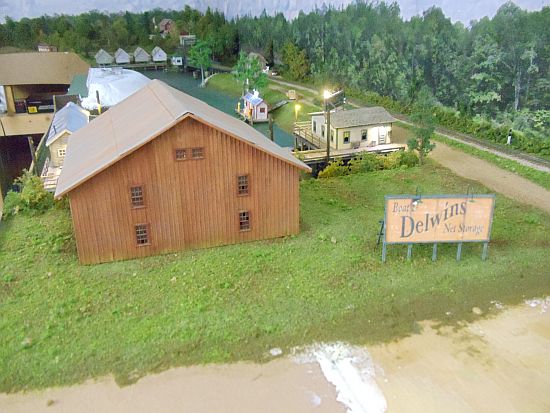

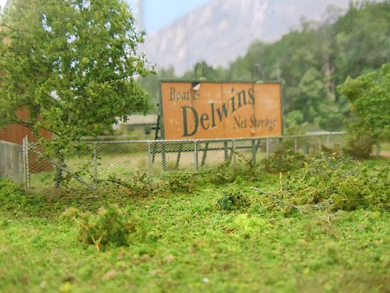

And a ground level shot of the fenced area and billboard.

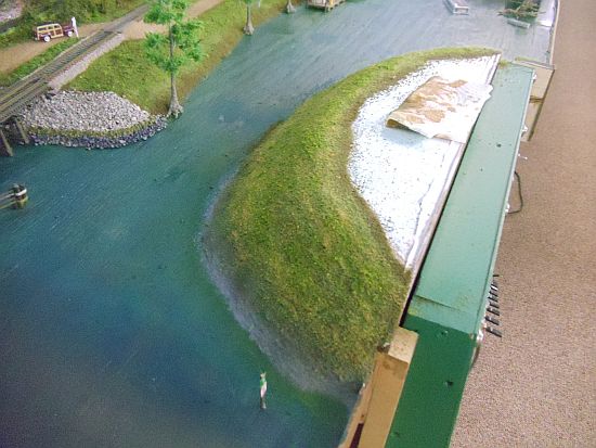

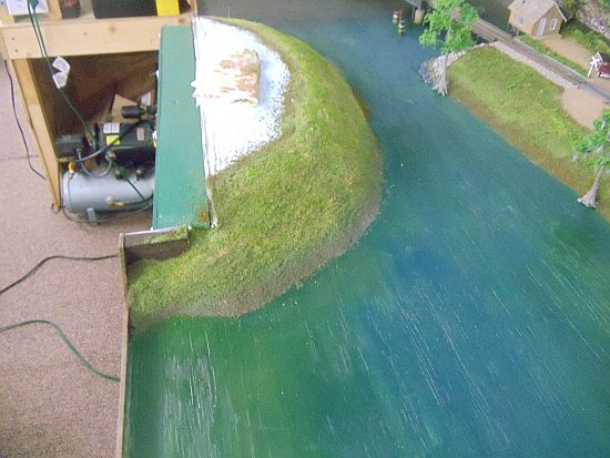

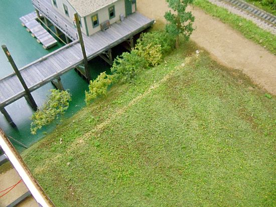

No need to describe what is happening here. The "clothing optional" area is getting some ground scenery.
Finally, my photo essay update is finished. I'm sorry the narrative isn't as detailed as the original but things happen, we move on. The next area I've been working on is the area to the right/south of Delwin's. The two structures here are the country store and Freddy's Fireworks.
