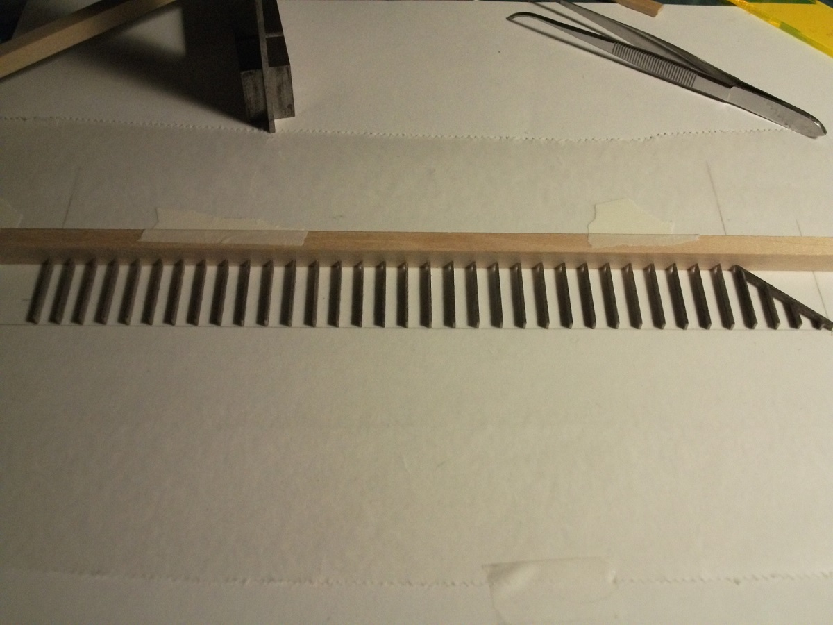

Once this building finsihed, I've  build the loading dock, this dock are build from template provide in the kit, with a wax paper taped on it. It's the first time I use this technic and I've found it very useful. I used A small piece of wood to make an exact spacing between each piece of wood.
In my cas the dock  located in the side of the mill is longer, in fact it have all the length of the mill, SO I've just redo a small draw n the template and in this particular case, the small piece of wood for making space eas very usefull

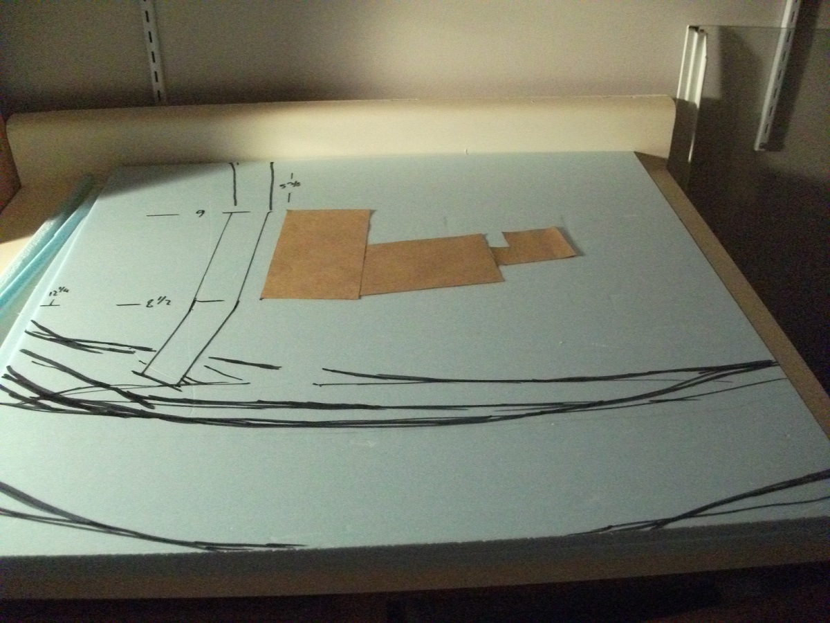

Finally I've begin to work on the dio base. Bob suggest to do a 24" x 24" dio,
In my case the Dio is 26 x 24"
I've first cut the base in blue foam and draw the different zone with black pen . Then I've make several template with wax paper to transpose all the mesurement for cutting the other layer of foam.
Finally I've buy several woodland scenic mold for making my rocks, Her's the begin of the plaster work on the dio, with an overview with the building.
