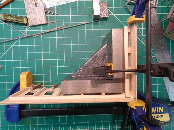

In an attempt to decide on lighting and interior I glued the front and right side walls together.
I made doubly sure it was square as the glue dried.
Back in a few.
I left the walls clamped over night.

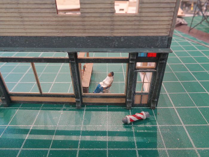

I found some barber stuff and tried to see if it would work on the right store front. Looks okay her, however, all is not what it appears.
This photo was taken on the work bench.

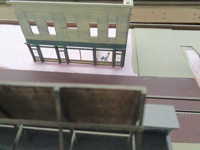

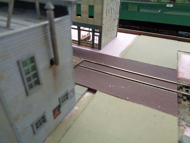

The planned location of Grumpy's is on the east side of the Tahope Main Street and across from another structure as shown below. In the photo below, Grumpy's is set off the road on the right as the stairs and second floor deck are yet to be attached.
Continued -
This is a good view but again, not what it appears to be.
Two issues come into play here.
!.  Grumpy's center store front will have an awning, partially blocking the view of the store on the right, the barber shop.
2.  When the upper level is added, it will be more difficult to see the complete store front from anywhere close to street level.
I'm pretty sure this just answered the question to light and have interior or not. So, no lighting or interior. Instead, I'll concentrate on the exterior details.

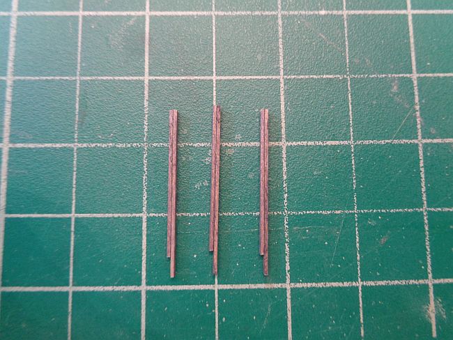

I wanted to add a little more detail to the deck so I turned my attention to the deck posts. These are usually 4X4 posts and I didn't want to just glue them flush to the top of the deck.
I decided to use HO scale 2X4s and glue them together.  I cut three 8.5 HO scale inches long and three 7.5 inches long.
I then glued the two together as shown below. The 1 inch difference is the height of the deck plus the top boards.
