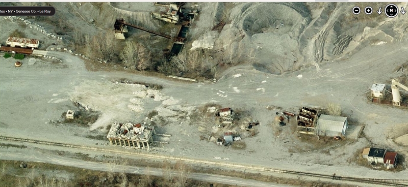

I found a better picture I had captured on Google Maps a few years ago. It's a clearer picture of the six concrete silos I was going to model with the two tracks under it. The last I remember this scene was when they still used the silos to load cars.
And another picture a bit further to the right of the previous photo showing the rusting equipment.
Picture of where I figured it should go. The one foot space behind it is to hold the bin of crushed stone and auger to load the bins. The idea was to just model the rock bunker being fed from a conveyor out of the scene.

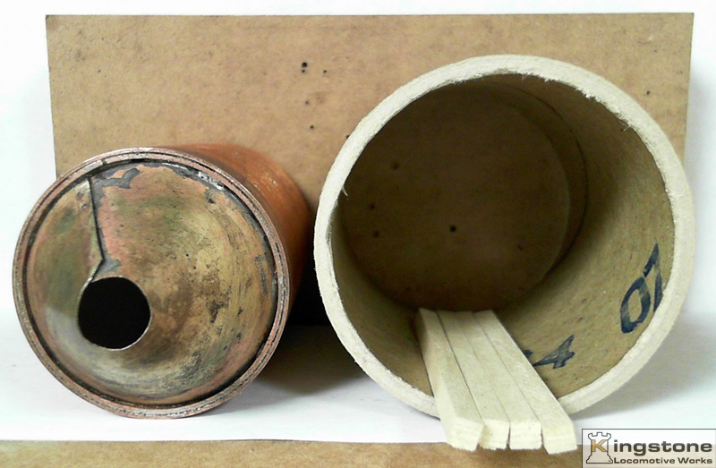

In order to hold the mechanism for the sliding door where the rocks come out I made that part of the structure out of a piece of 2" copper pipe, a brass rolled cone, a piece of 2½" mailing tube and a flat board. Here are the ingredients for one bunker.

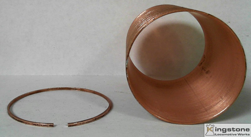

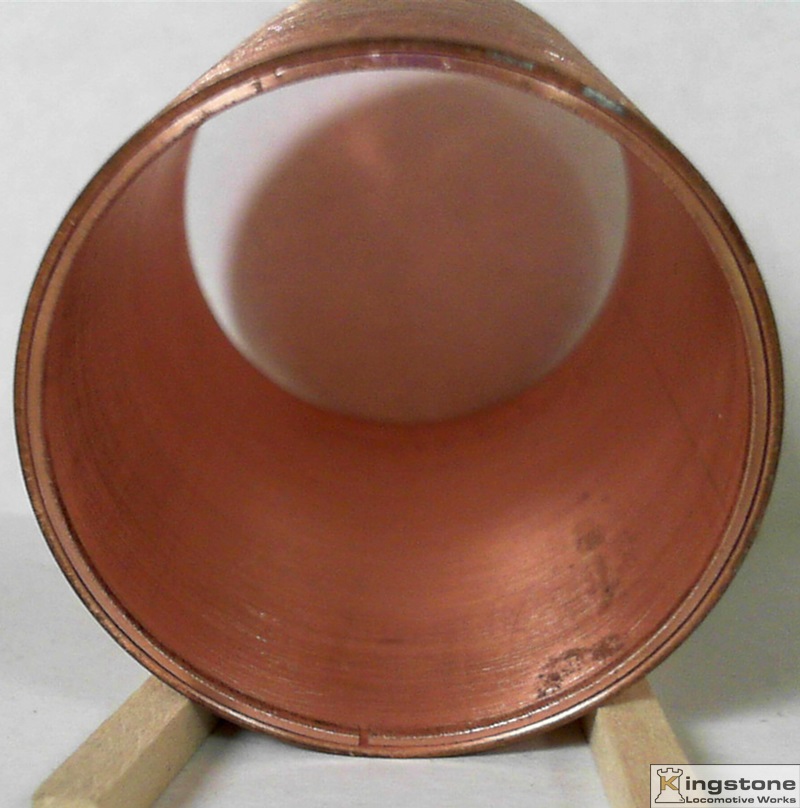

The tapered discharge chute needs a ledge to sit on so it's level when the bunker is stood up. A thin slice of copper tubing split will do the trick.
That gets placed in the tube to get marked where to cut a section out so it fits in. Note the overlap at the bottom of the copper ring.
Once cut the ring is tested to see if it fits. Notice the tiny gap at the bottom.
Once satisfied with the fit and making sure it is even with the end, it is solder in. I use a small butane torch for this work.

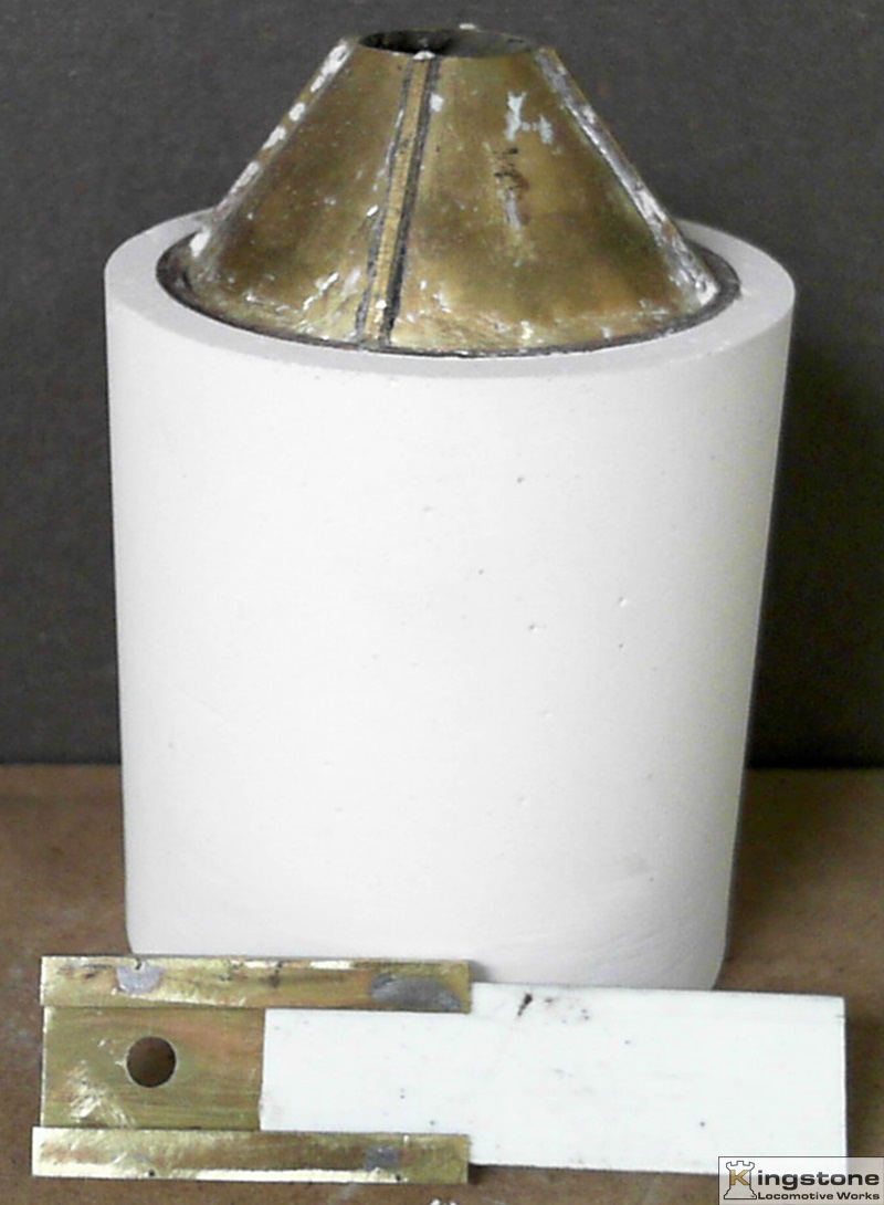

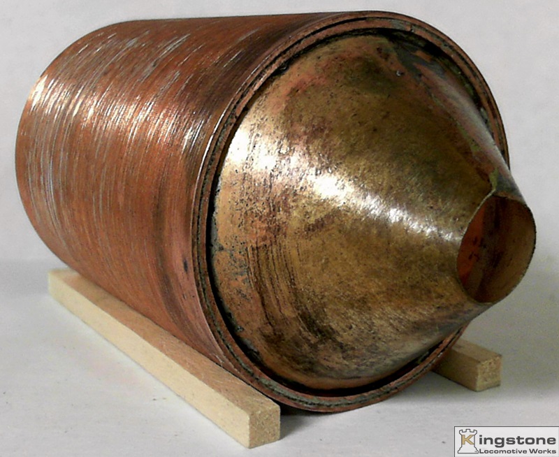

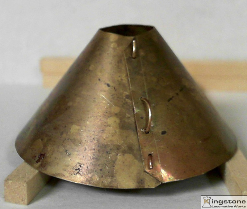

Next we turn our attention to making the cone. I found a program on the net that helps solve the problem of getting the right dimensions. I hope it never disappears from the net. http://craig-russell.co.uk/demos/cone_calculator/
And I came up with this. I drilled some holes in the sheet metal and stitched it together with some wire. The wire keeps it from unraveling and unsoldering when it gets soldered into the copper tube.
The cone is soldered into the copper tube. I make sure it is well seated on the ring I soldered in earlier and then solder it all together.

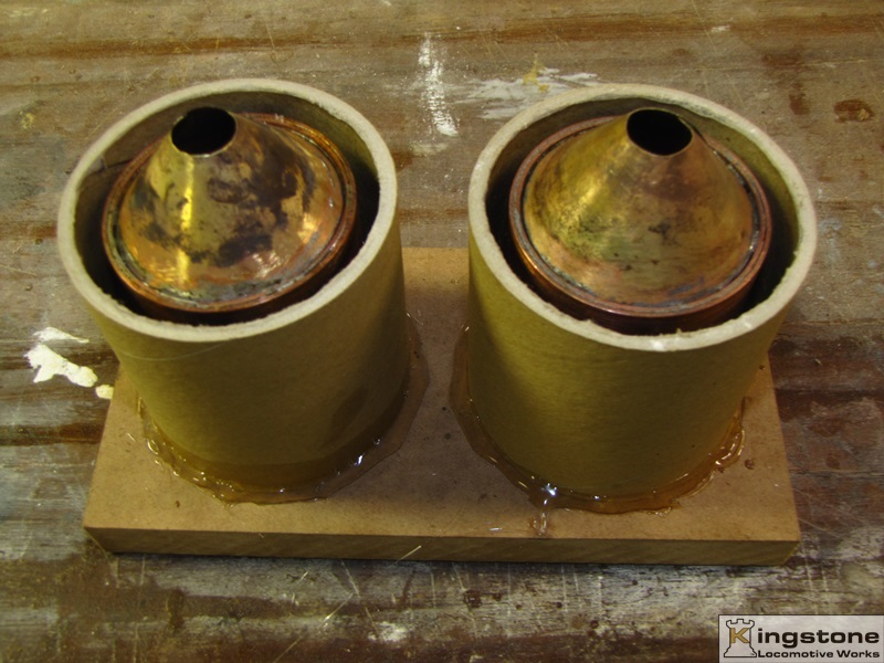

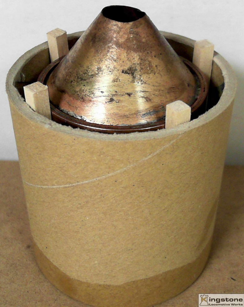

Here's where the mailing tube, 1/4" square wood strips and board come into the picture. I'm going to pour casting plaster around the outside of the copper tube to make the bunker look like real concrete.
The copper tube is first glued to the board with hot melt glue. The mailing tube is placed over that with the 1/4" square wood spacing the mailing tube the proper distance from the copper tube.
The casting plaster is then poured and with any luck the part will turn out like this.

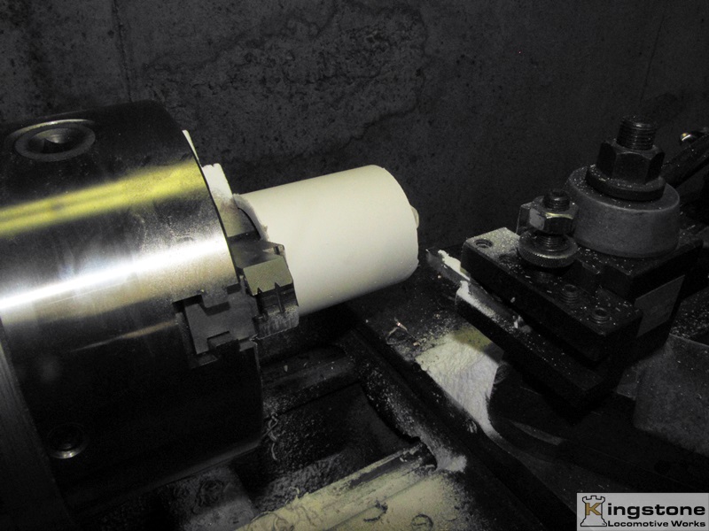

The first one using the procedure shown in the above picture showed this procedure would work. Once the plaster had dried for a day I removed the cardboard mailing tube. I then clamped the bunker in the lathe and turned the outside concentric with the copper tube. Why? All six bunkers need to be the same diameter so they are correctly spaced once the cars sit under the rock bunker. Things need to be aligned properly to pull off this project. The piece leaning up against the bunker will become the sliding door that will allow the rocks to flow from the bunker. I just hope it will work when I get to the point of having all six rock bunkers up on their structure.

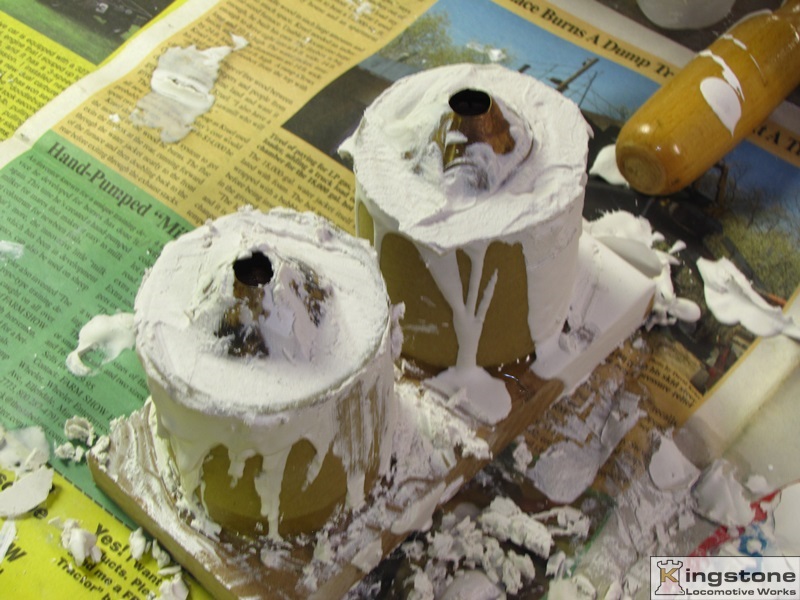

I poured the two remaining silos. So that makes three if these two come out like the first one. Here I used ACC with an accelerator to glue the copper pipes down. Hot glue didn't want to work for me this time. The mailing tubes were glued down with hot glue and a bead was used to seal around the tube.

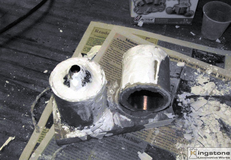

And here's the messy part. Not much room to try to pour something that's thicker than pea soup into a 1/4" wide slot. I hope I have no air bubbles in these. I did tap the whole works on the table and it did burp once.

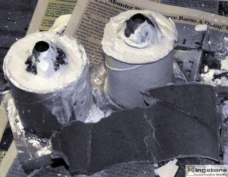

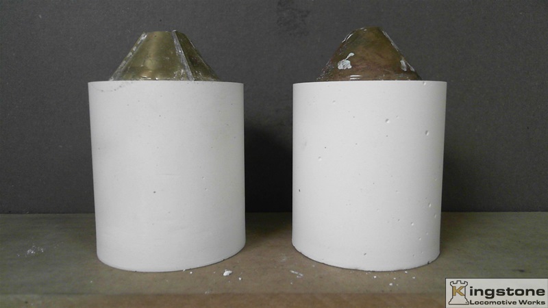

Partial success on the casting I poured. But it's expected. One thing I forgot to mention was I used clear gloss polyurethane to coat the inside of the tube. I discovered on the very first one that the cardboard attaches itself to the plaster as if it was glued on. The polyurethane kind of moisture proves the tube. Started peeling off the cardboard.
I cut into the cardboard with a utility knife till I get to the plaster. Then take the knife and kind of pry up a layer of cardboard and peel it off. Usually when you get close to the bottom it all comes off at once.

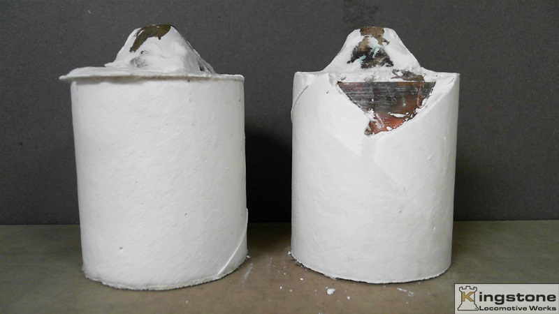

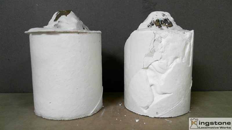

So the first one was a success. The second one, not so successful. I happened to catch the edge of the knife in the plaster, it pop off a piece.
After letting them dry for a time the castings were harder. The one that didn't turn out had a powdery feel to it so I decided to redo that one. The one that turned out OK was clamped gingerly in the lathe and had the OD turned nice and smooth to approximately a 2.5" dia.
Wound up with two good ones on the first casting attempt.

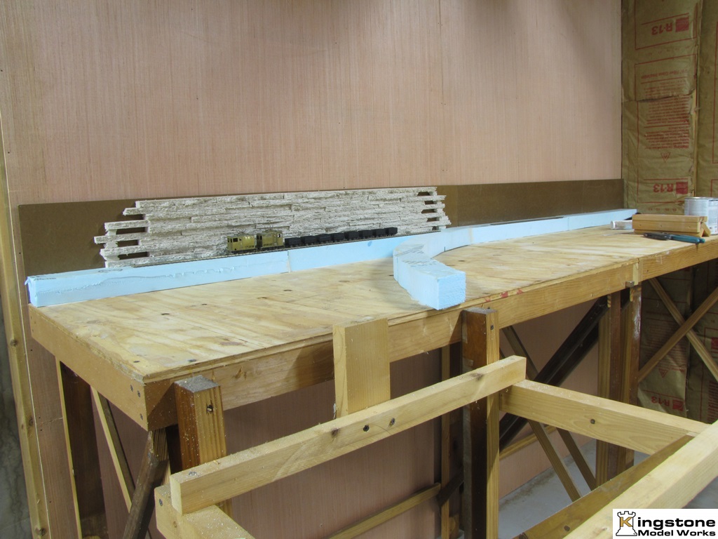

In the last post I ended it with casting some storage bins. I determined that's not the way to go. Also I've come up with a track plan that might work now. I've tossed out the Gum Stump & Snowshoe plan for something completely different. The quarry will have a large animated rock bunker. The bunker will be filled via a belt system from a rock crusher which will be off stage so to speak. The idea is to have a bin filled with limestone that will be conveyed to the rock bunker. There will also be a track on a higher grade going to the quarry off stage to bring back large cut limestone. The idea is for the HOn2½ line to feed a transfer plant somewhere on the standard gauge line. So I started with getting some Styrofoam cut and laid out for the high level track to the quarry.
Notice I haven't done any wall prep. Another mistake I made. Won't happen again.

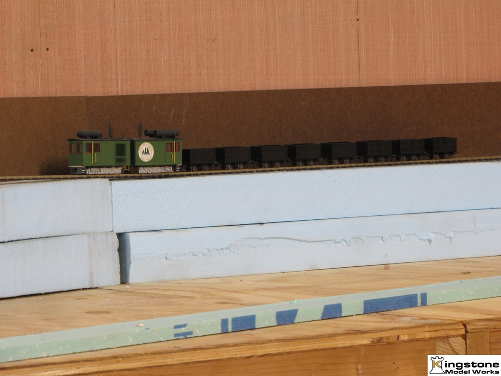

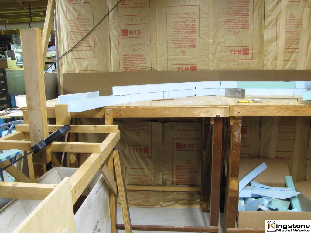

I decided that the line was to high. I need to get to the table top level in a short distance on the uncompleted part to the left. So I removed one layer and proceeded to glue down the first layer with construction adhesive.
