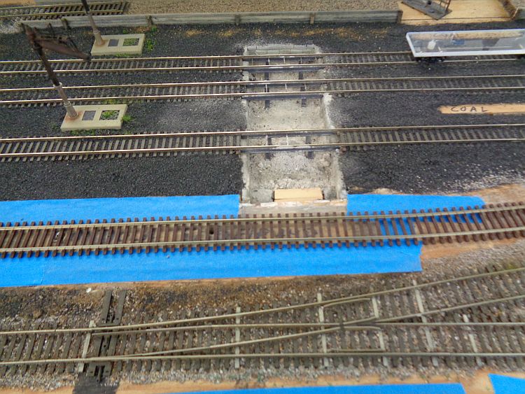

I had a slopped ramp but this only allowed for one gondola to load.
I unscrewed the ramp, leveled it and removed the track and ballast.
I then removed a portion of the pit wall and used painter's tape to cover the saw gaps.
I then laid a longer section of track that will hold three gondolas.
The track was removed and a new wall was glued in place.
When dry, the clamp was removed and I cleaned the area and got the section of track ready to put down.
I then added the track and secured it to the plywood.

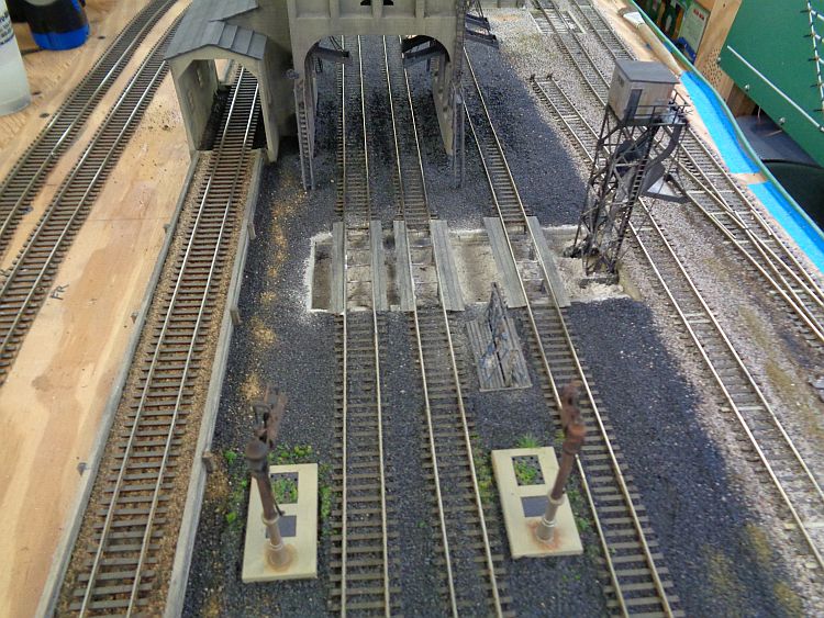

I then positioned the coaling tower and added spilled coal around the tower base.

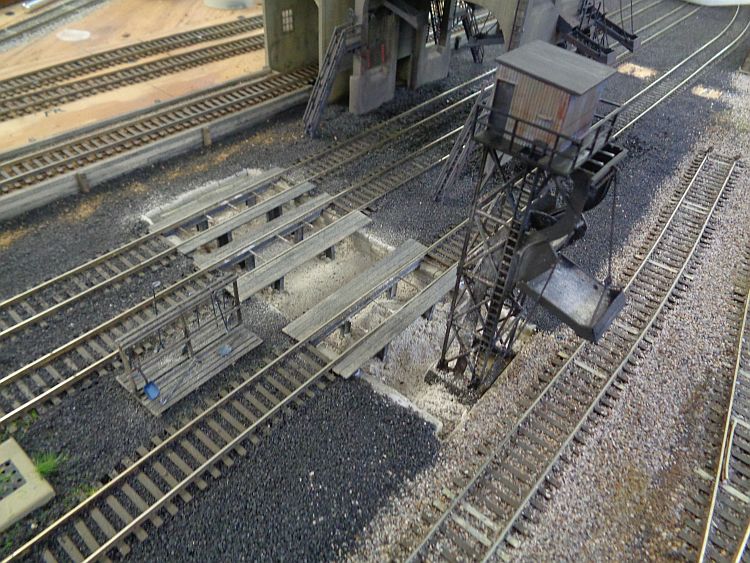

I added more of my father's ashes to the ash pit. NO, not his ashes but ashes from his cigars. I saved a jar just for this purpose.
I scratch built the small clean out rack and tools.
I added the two water columns. The water columns are NJ International brass. I added weeds and clear enamel for spilled water.
Here's a better view of the scratch built tool rack. The ash pit tower is Walthers. I painted it with Floquil Weathered Black and added a chain where Walthers had a string for the ash slide. I also made a different roof.
