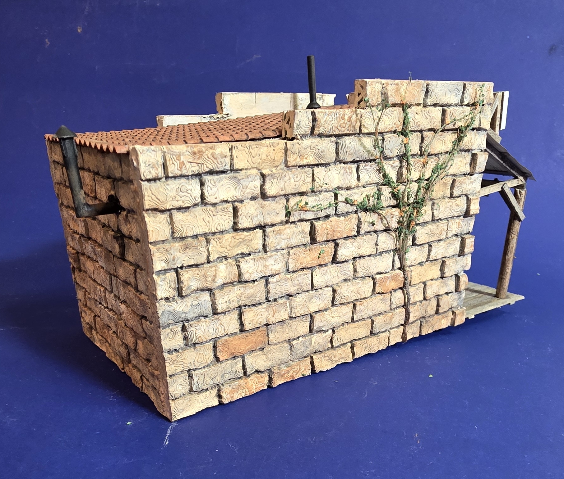

The 3D projects are going well.  The vine is almost finished; it just needs leaves.  Here's what it looks like in winter (which I am not modeling).

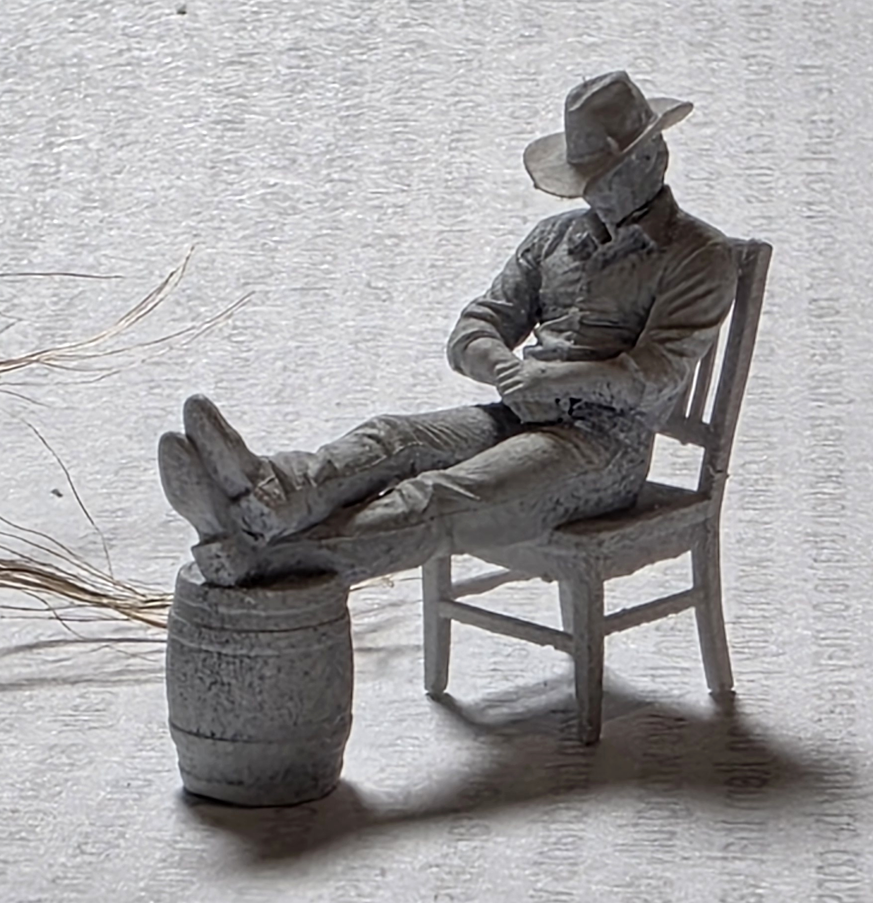

Close-up of the Sheriff taking a nap.

Mike they all look wonderful.  How did you make the vine???
Mike, the sheriff turned out very good.
I'll be watching as you finish the tree.

Fantastic job on the Sheriff's Office. Typical for him to be taking a nap, well done.

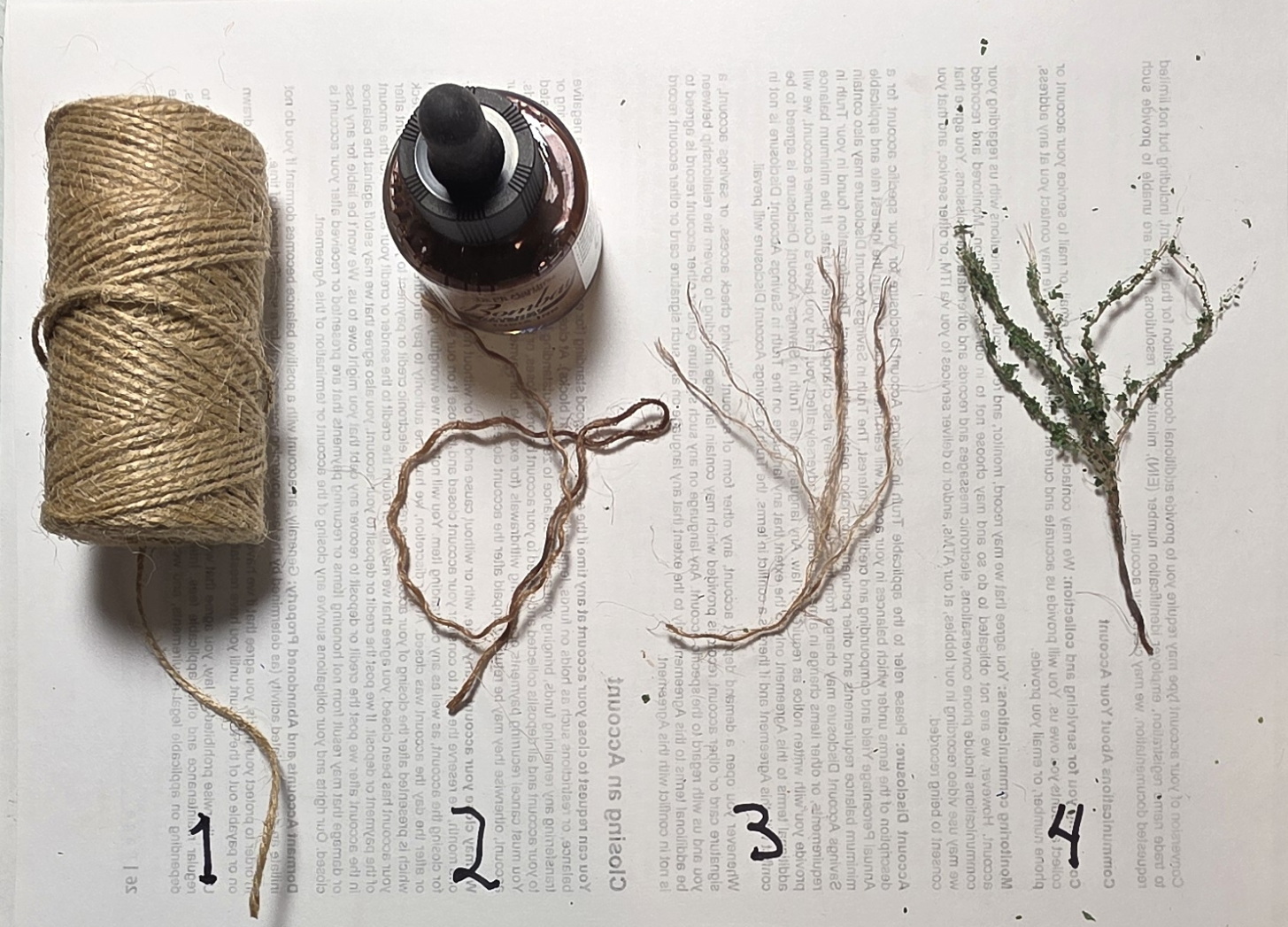

Here are the steps for the vines.  I am waiting for the hairspray to dry before adding flowers.
Step 1: Get twine or jute.
Step 2: Cut a length and dye with brown India ink and alcohol or water.
Step 3: Separate and unravel one end of the twine.  These will be your branches.
Step 4: Coat the vine from step 3 with either hairspray or spray adhesive like 777.  Sprinkle leaves material on the wet vine limbs and let them dry. Recoat if necessary.
Step 5:  Not shown - use orange or red paint and dab small amounts to represent flowers.
That's it, simple.  There are several YouTube videos on the subject, too.
I used Noch leaves, but any ground turf will do.

Here are the fines on the sheriff's office.  I didn't make them too thick because my time period is early spring.
