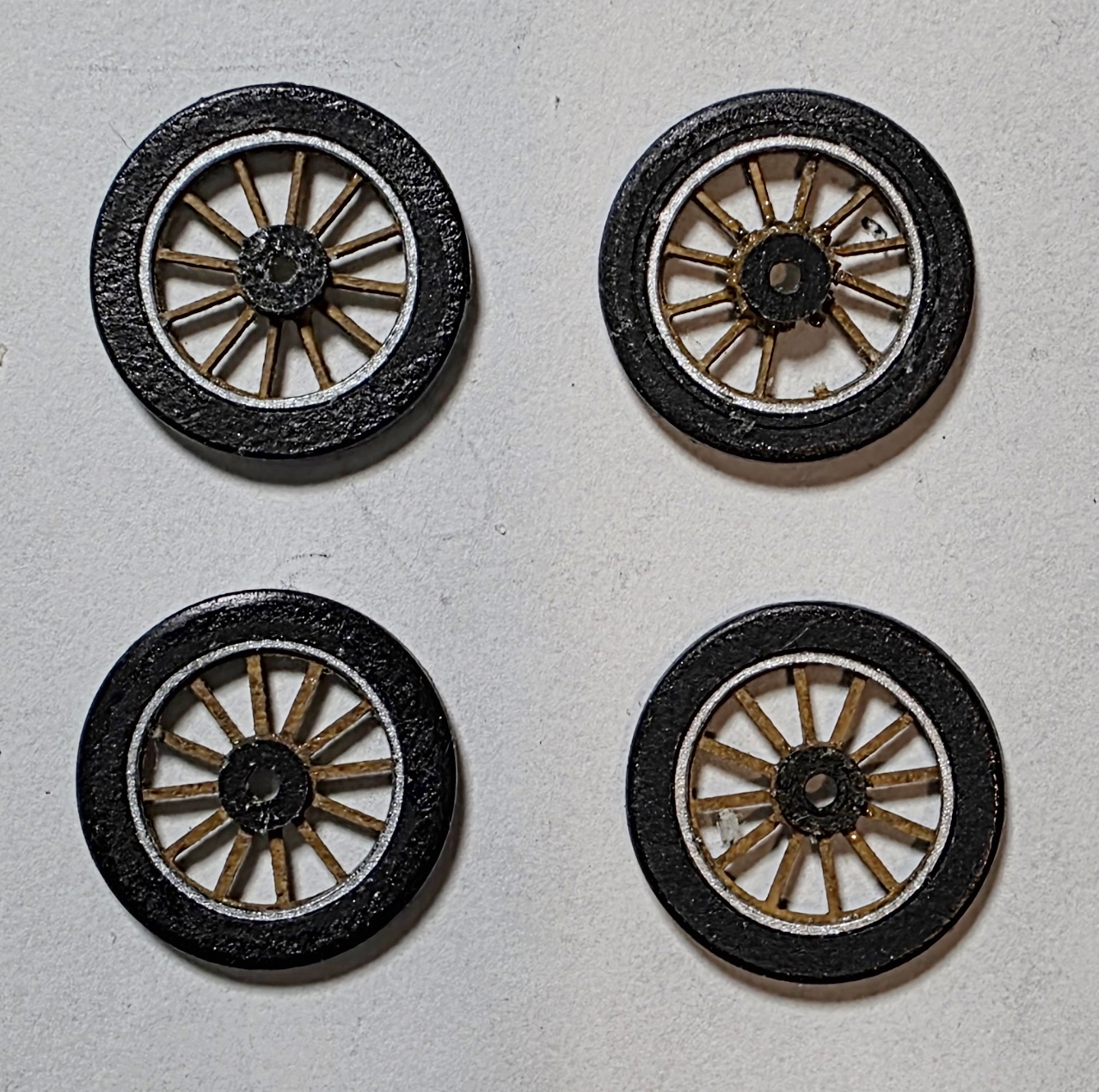

The wheels are laminated from a spoke center and two outside walls.
The instructions called for sanding the wheels to make them look more realistic. I decided to use a Dremel tool mandrel and an electric drill (slower speed) to sand the edges and round the tires.  I'll post photos later of the sanded and painted wheels.  The finished wheel gets a larger center hub and wheel sealing ring to finish. The spokes are fragile, so I didn't add much side thrust when sanding.

Finished wheels
