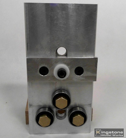

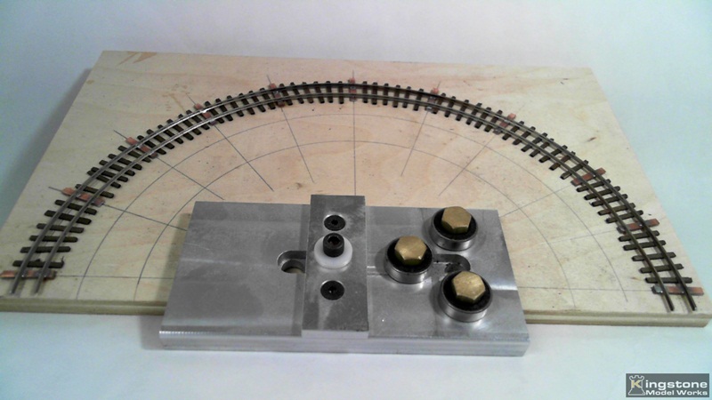

You ain't fiddlin around! That was quick and it looks great! I saw one of those rail benders from a company for like 80 bucks! I made a similar one out of wood and some rollers/ 1/4 20 bolts/ from a hardware store. Did the job.
Dave Buchholz
#23
Happy to hear you imagineered your own tool Phil. I kind of cheated somewhat. Professionally, I'm a Licensed Optician in New York State, for over fifty years. I own a tool for bending wire frames, but I've also seen the same tool at Hobby lobby. The optical industry calls it a base curve pliers.
Jewelry maker hobbyists usually refer to it as a wire forming pliers. I have seen them in places like Hobby Lobby and Michael's craft stores. Sometimes they come in a set that have other useful pliers.
New home of the North Coast Railroad, along the shores of Lake Ontario

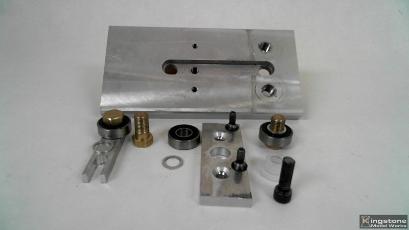

Bernd
Speaking of rail benders. I made one many years ago and gave it to a friend to test out. Haven't seen either of them.
Bernd
That looks similar in design to the Fast Tracks rail bender (which works well....)  And that reminds me:  I still need to add the guard rails to my trestle bridge...

Funny they used a tool similar like that at vision works today to adjust my wife new tight glasses.
Pictured was my jig I used on a turntable from Kitwood hills models,UK. My grandson named it "toaster". It is a basic friction jig that was a useful rail bender cobbled.
