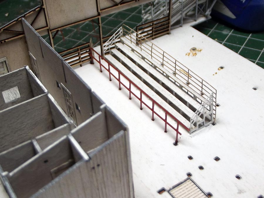

I'm going to look for some thin brass rod to make the railing in front of the office , not satisfied about that, and the fence in the sales ring was just to fragile so I'll be making that with brass rod as well.

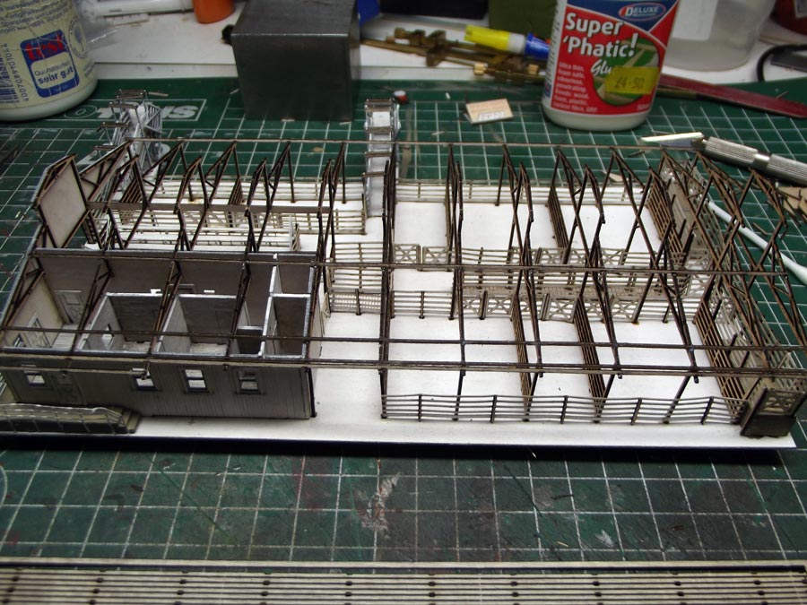

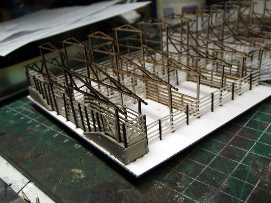

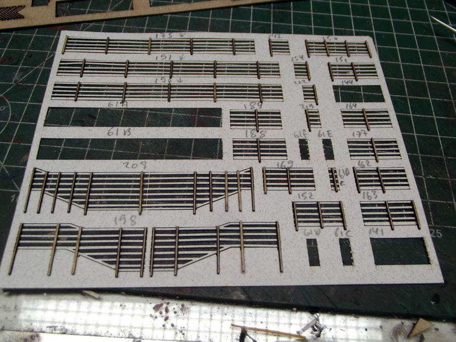

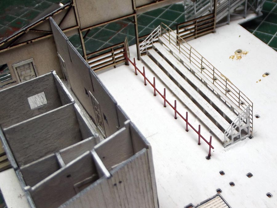

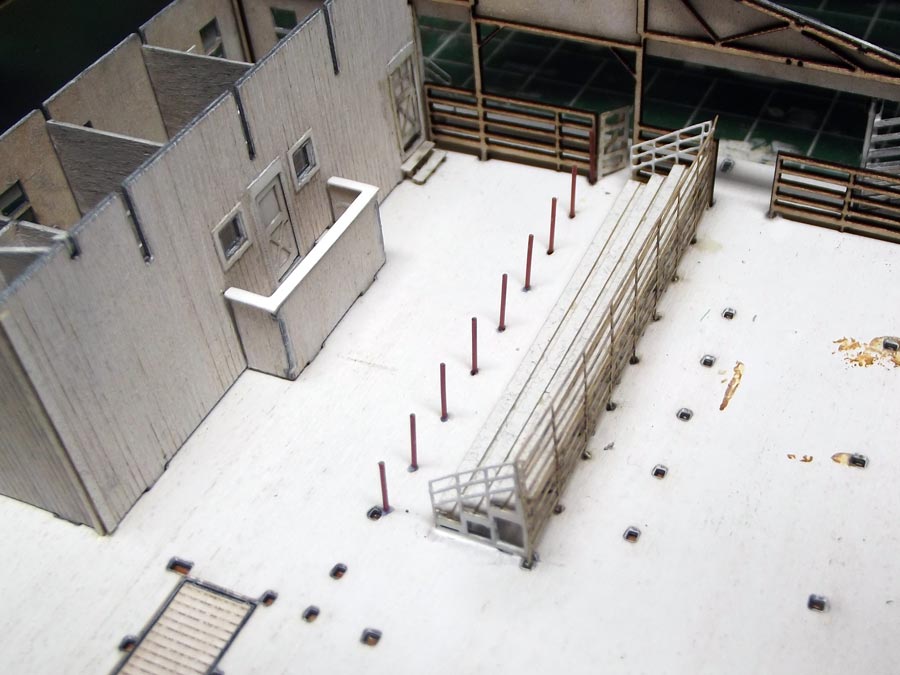

The fence between the bleachers and the ring was so fragile I think I broke it by just looking at it, so i'll have to make one myself. At first I thought I would make it with brass rod, but the fact that it will hardly be visible doesn't justify spending the time soldering this tiny part. So I decided I would make it out of some styrene rod. In the middle of the photo the tiny holes the posts will be going into.
The rod , I get most styrene rod and embossed sheets from Slater's.
Posts cut with the chopper and glued into the holes.
First horizontal bar .
2nd bar , when the glue is dry I will cut off the ends sticking out.
At last all fences have posts glued to them.

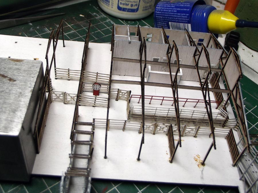

And here you see some of the fences and gates in place.

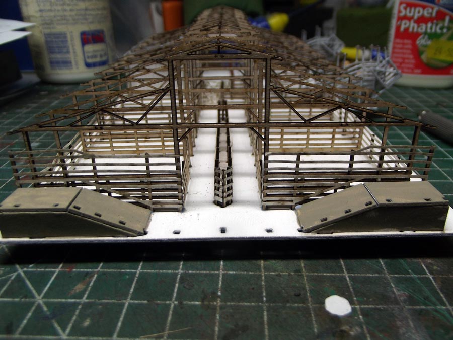

Step by step , placing trusts , fences and gates, very nice kit , lots of work , don't start this one if you're the person that wants a kit finished in a few hours.

Very nicely done on the kit. I really love all the detail on the cattle pens and ramps.

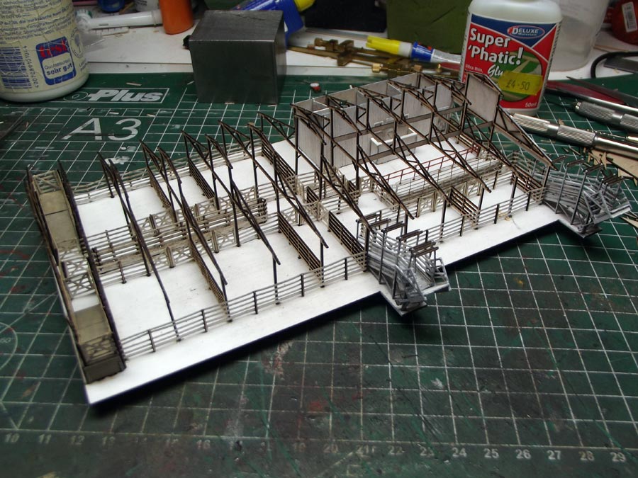

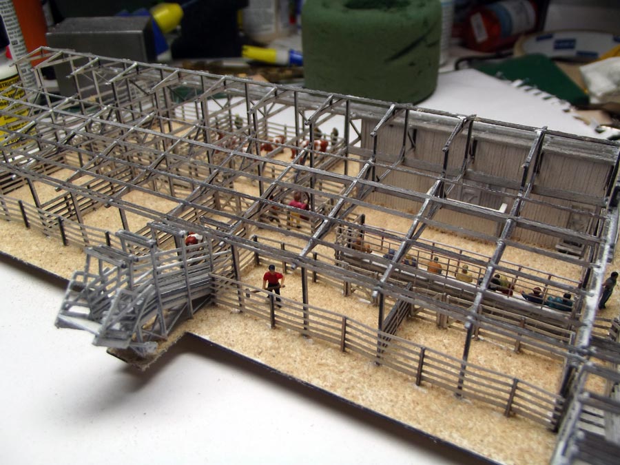

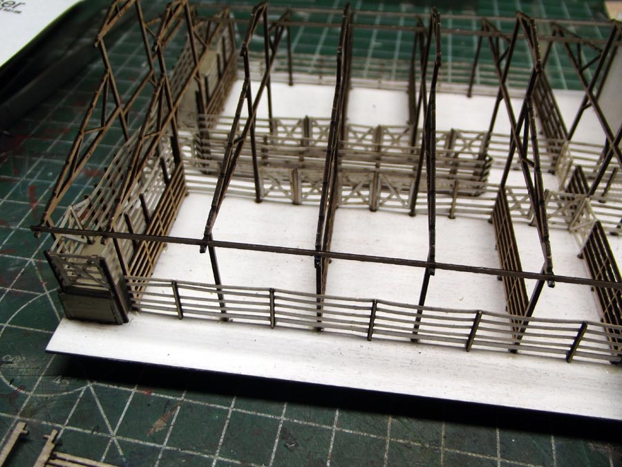

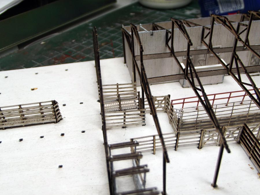

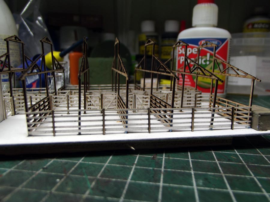

Getting to the end of fences, trusts and gates, just a few more to go.
Last trust, gate and fence placed.

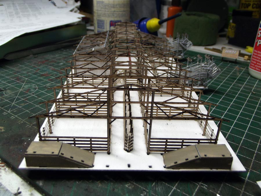

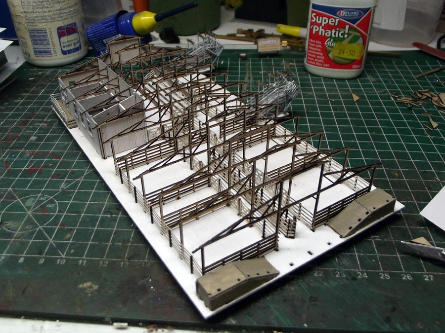

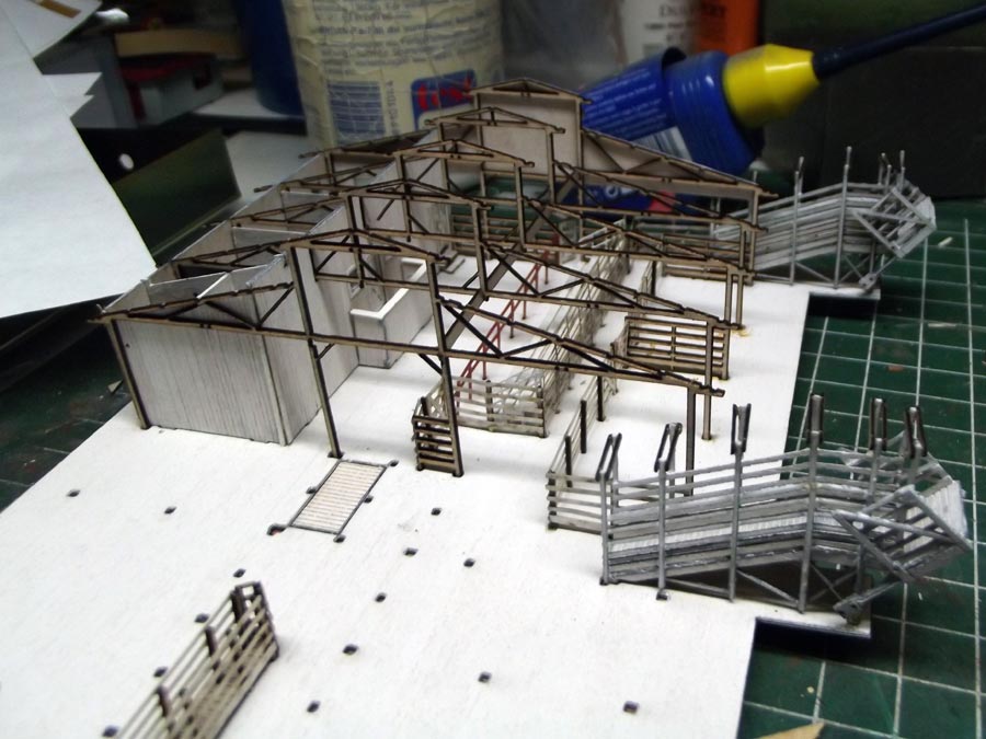

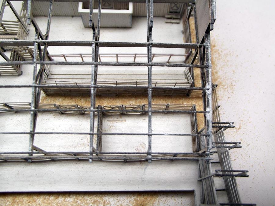

First roof beam placed, glued one in place , turned the building 180 and then glued one on the other side whilst the other one was drying , and so on.

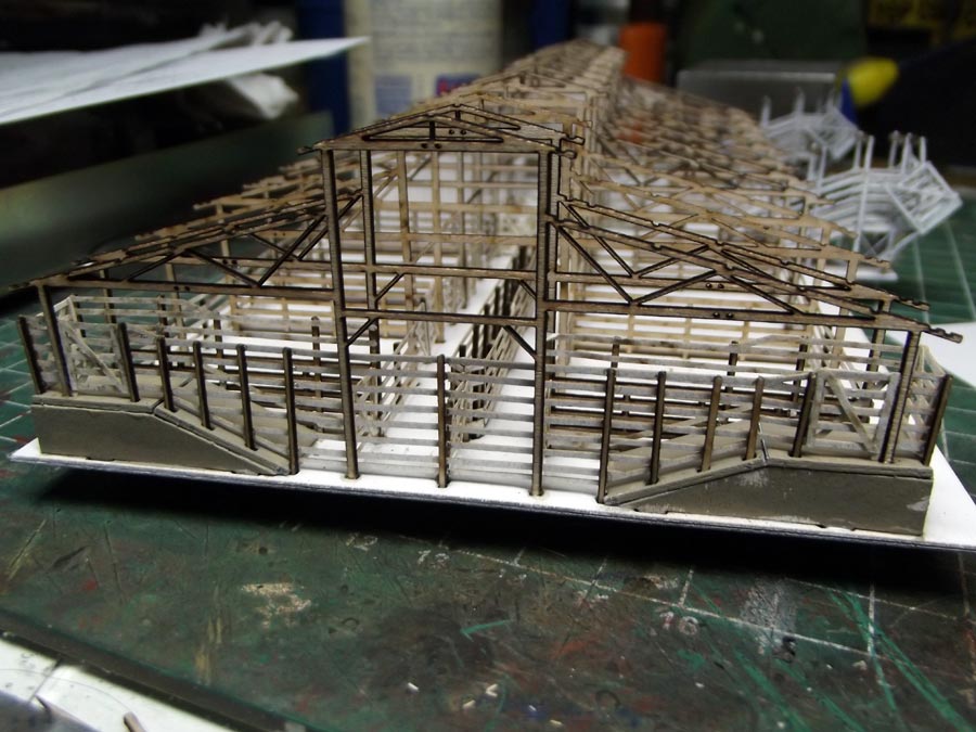

All roof beams except 2 that need to go on later ( this kit really needs you to follow the instructions, the numbers of the parts are the sequence).

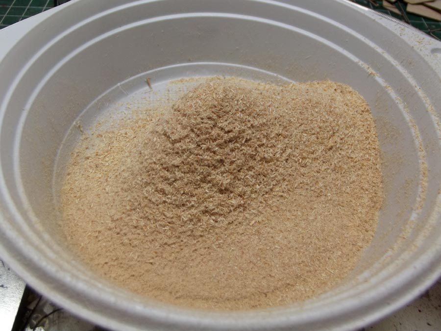

To covering the floor , I needed sawdust , very fine sawdust, this is what I picked up around my radial saw.
This is how it looks after a go through a tea strainer.
And then through a panty hose 50 Den, I forgot to take a picture of the strained product, but it was to my likings.

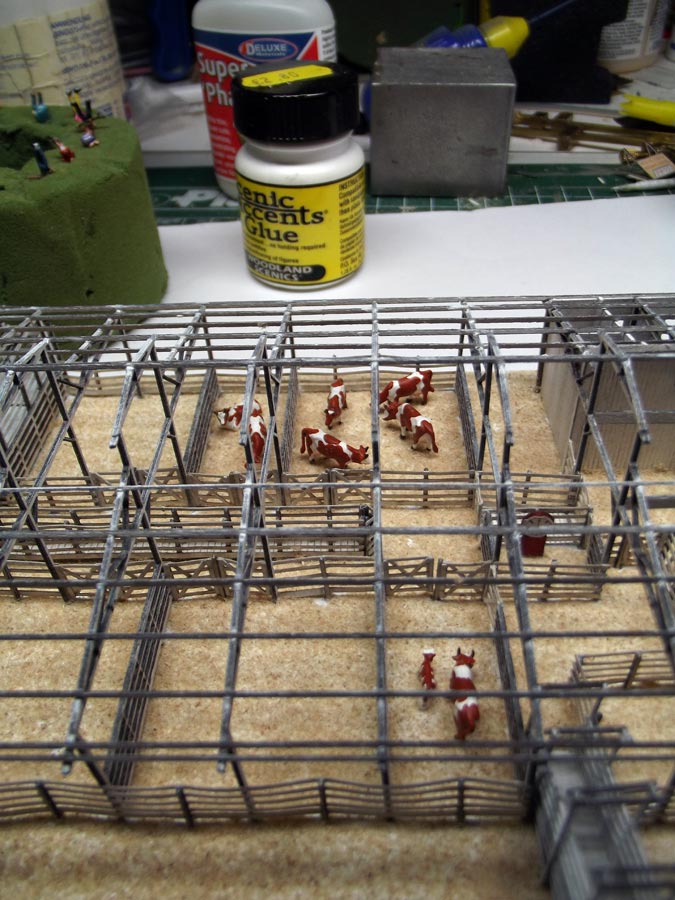

When the floor was finished I realized I shoudl place my little people before I put on a roof, here all the little people have had their butts or feet dotted with Scenic accents Glue, you leave this to become clear and then it is sticky.
Some photo's of the little people and cows , have to get me some other animals and standing people, and a standing person with a microphone as an auctioneer.

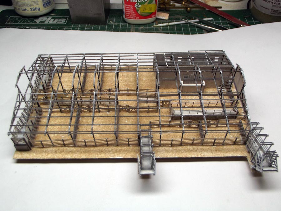

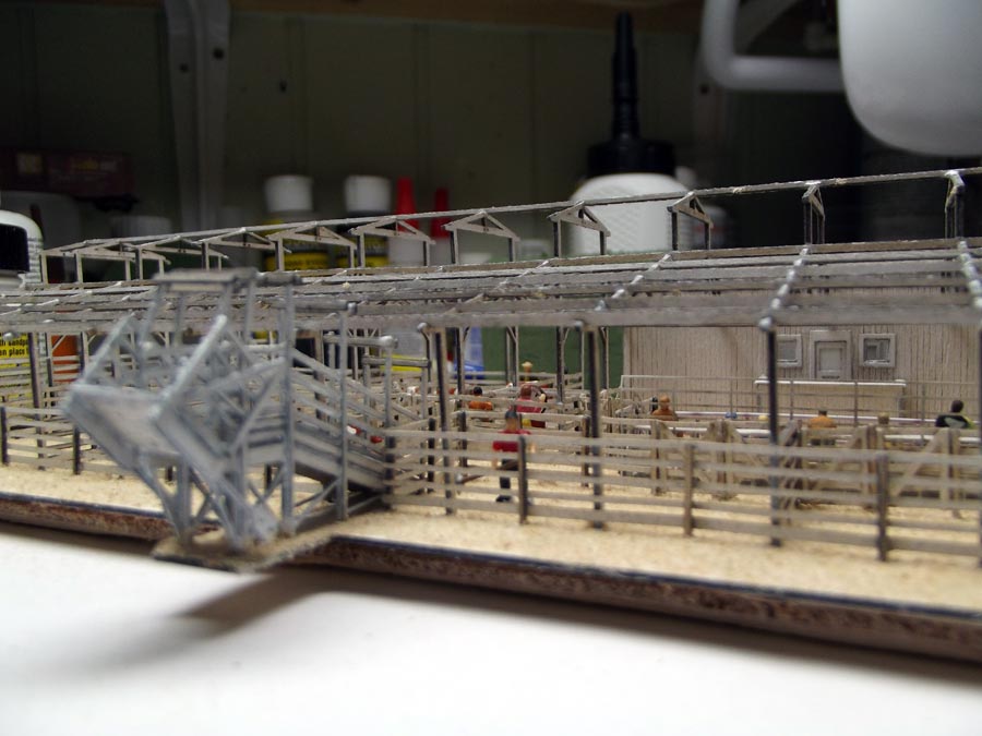

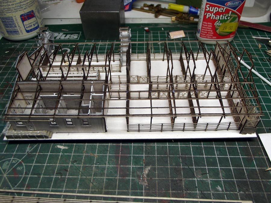

Overview of where I am now.
tjseeley
It's looking awesome!  I love the sawdust all over the floor (probably could use a little cow dung :-)  The people are great additions - I especially like the guys in the bleachers at the auction ring.  By the looks of the cows, it's an Ayrshire dairy that's being auctioned off.  Absolutely love your work!
