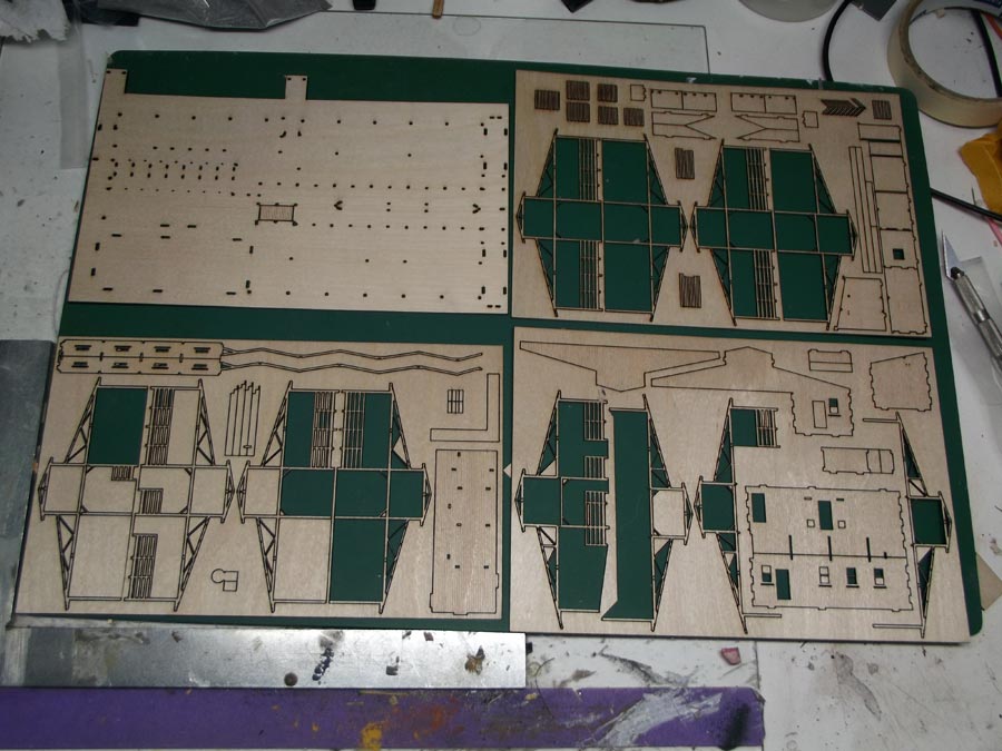

The Model60 pledge has really got me going, started on this yesterday and I like it so much so far that I would rather have worked on it then go to work  ;)
First the package and the contents. The packaging is very vulnerable for such a fragile kit, I think this should definitely be boxed.

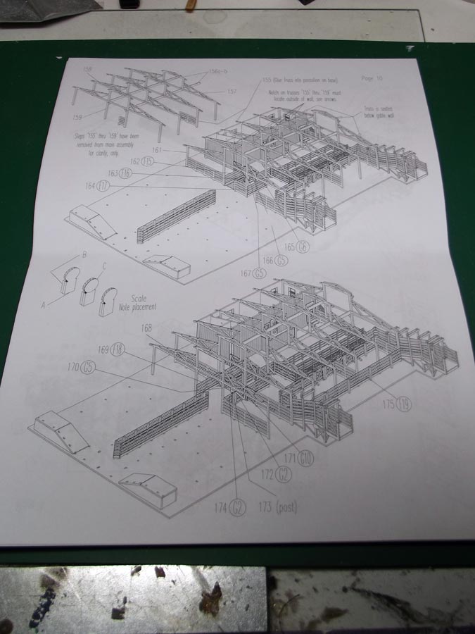

15 page instructions, no text except for a small bit on page 1 , very good drawings however.
I'll just follow the instructions building up sub assemblies.

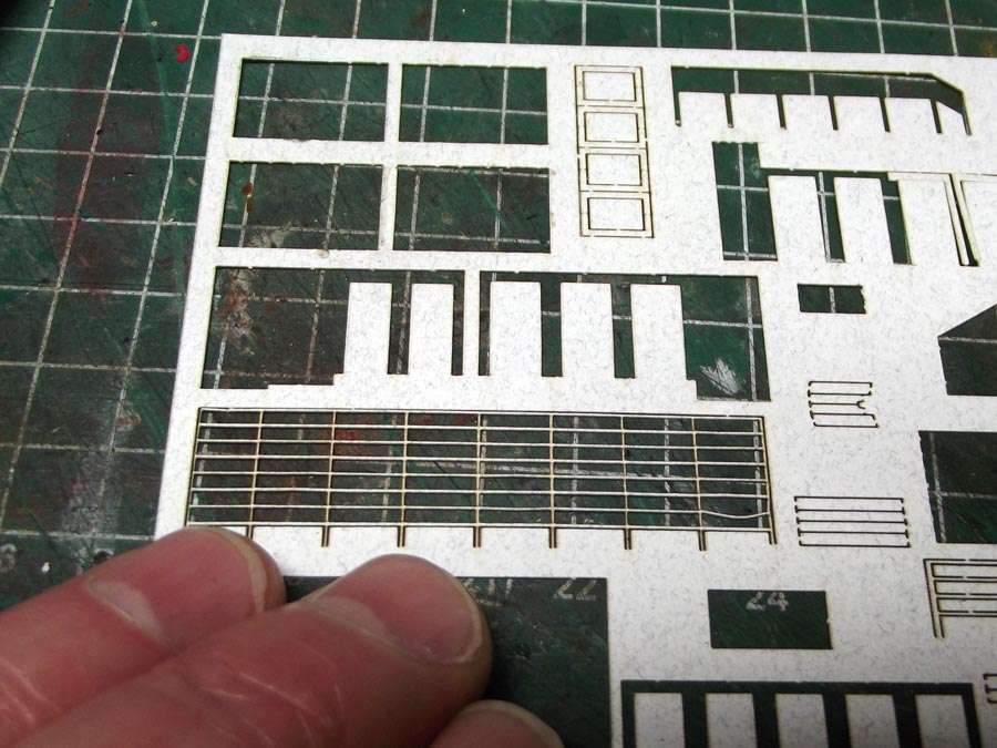

GC uses a sort of paper/plastic to lasercut the finer things such as railings, this is one of the sides of the bleachers in the auction house.

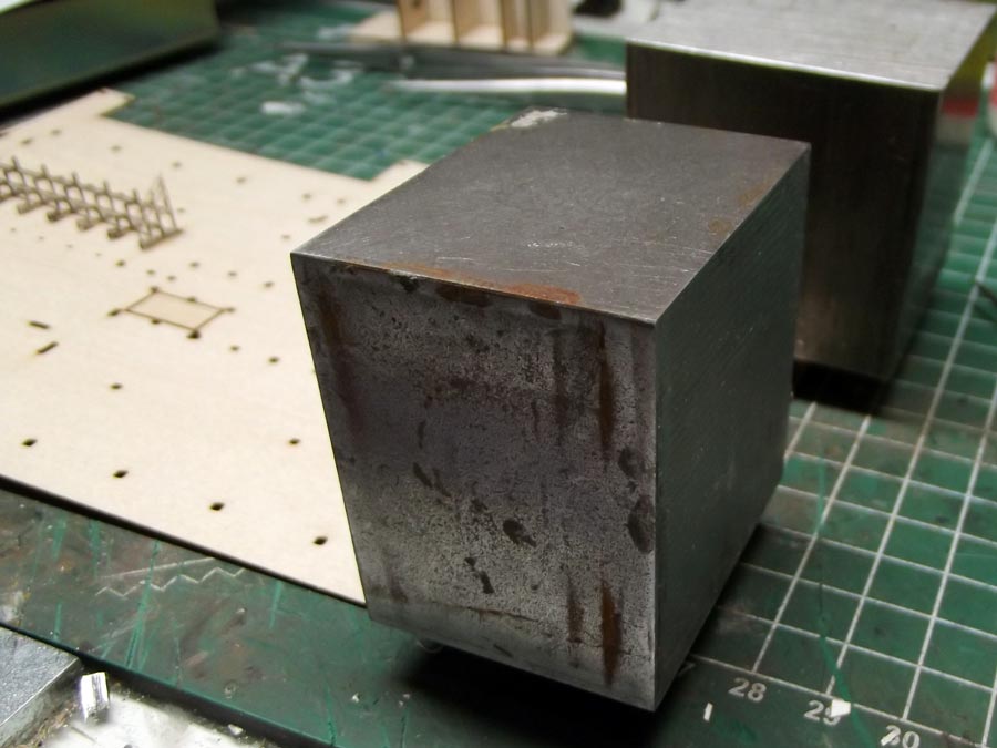

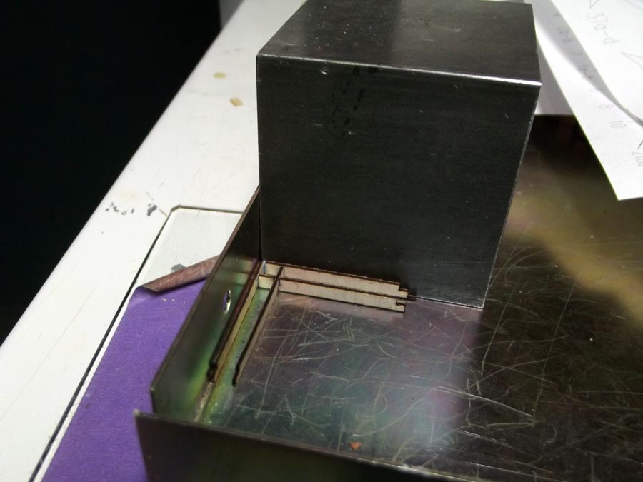

I'm glad I have good tools and aids to work with, like the steel blocks and different kinds of good quality tweezers.

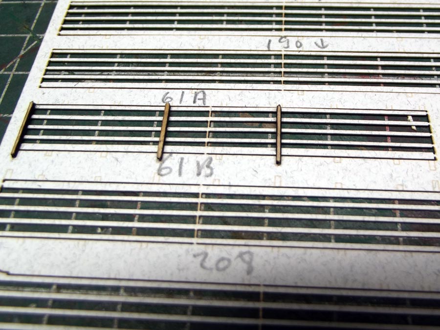

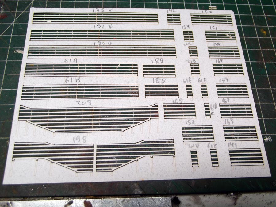

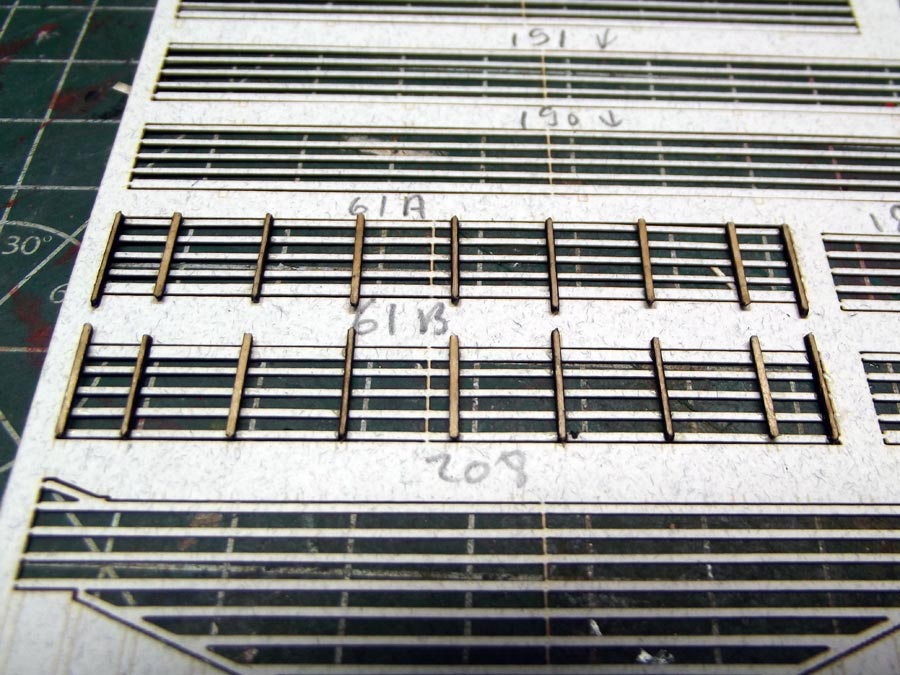

There are lots of fences to be made in this kit, seemed like it would be a bit tedious but found out it isn't. I started by numbering the sheets , yes the instructions have the numbers on them but this made it a bit easier to oversee.
Short and longer posts to be glued , if you look close you can see the markings where the posts are ligned up with.
Do the fences while on the sheet.

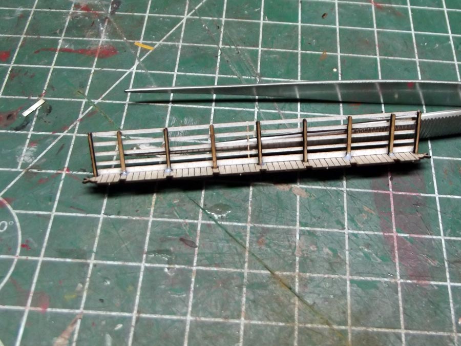

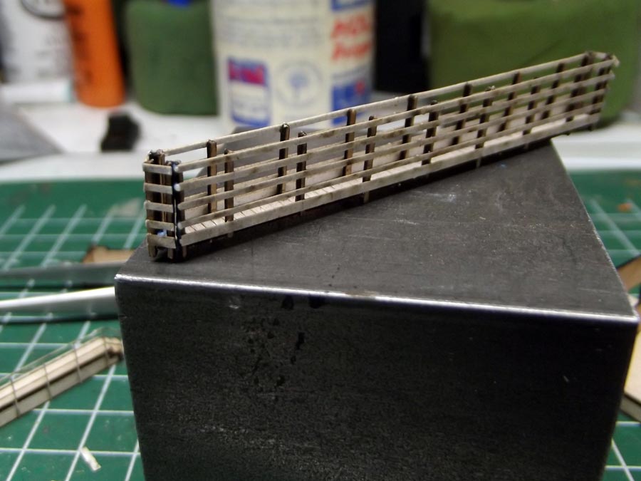

Then cut out and voila.
These fences belong to a divider , the rest of the pictures show the build of that.
The last image is taken from about 1 1/2 foot, just to show that this will look good with 2 foot rule .

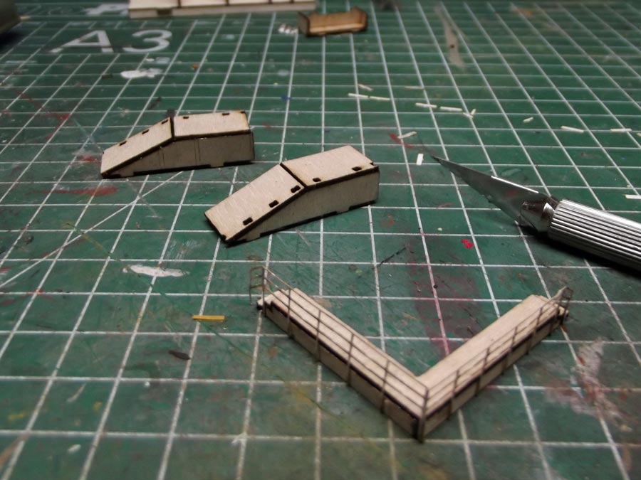

Next part , the 2 loading ramps.
Leave them on the sheet for now , glue the posts guided by the markings.
Posts glued to the loading ramp sides and cut from the sheet.
There are 2 loading ramps , glue the floors into the slots of the sides and then glue both sides and floor together.
Both loading ramps and gates.
Gates mounted to the ramps.

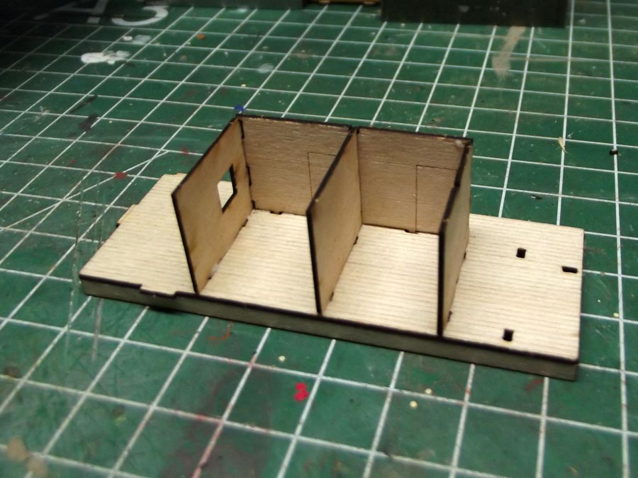

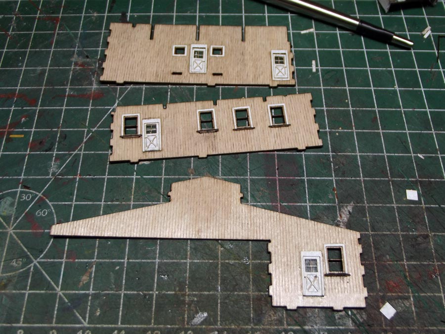

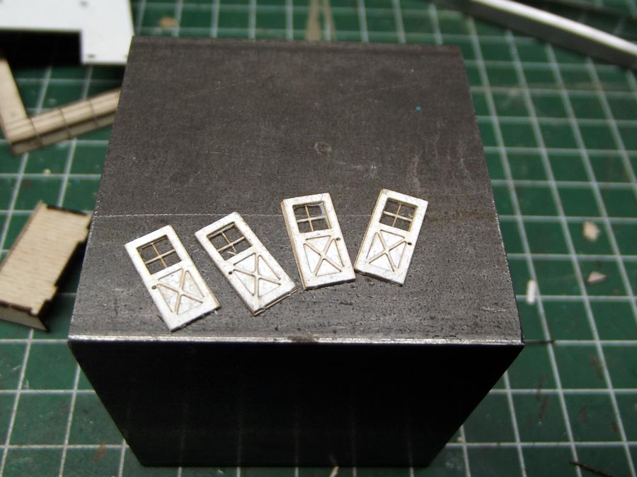

The doors for the office consist of 4 parts.
Doors and windows placed in the office walls.

The office placed on the base.
