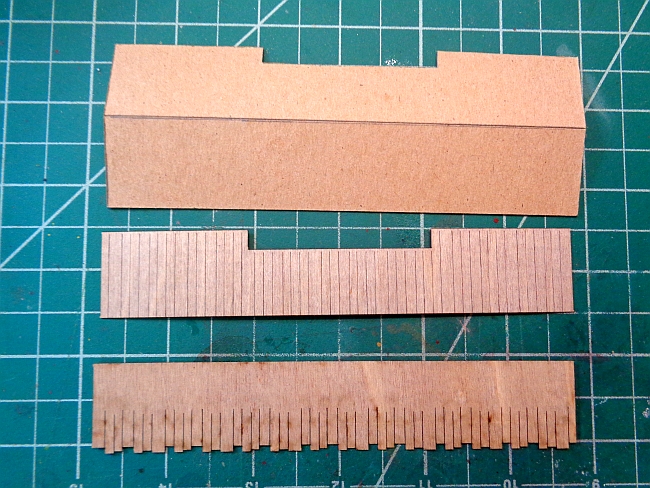

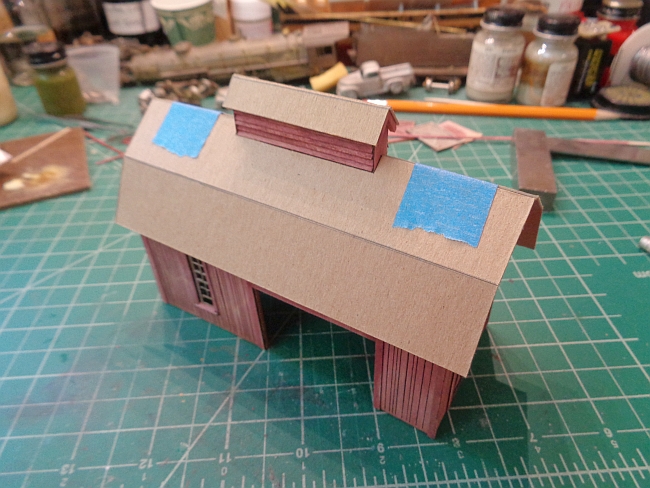

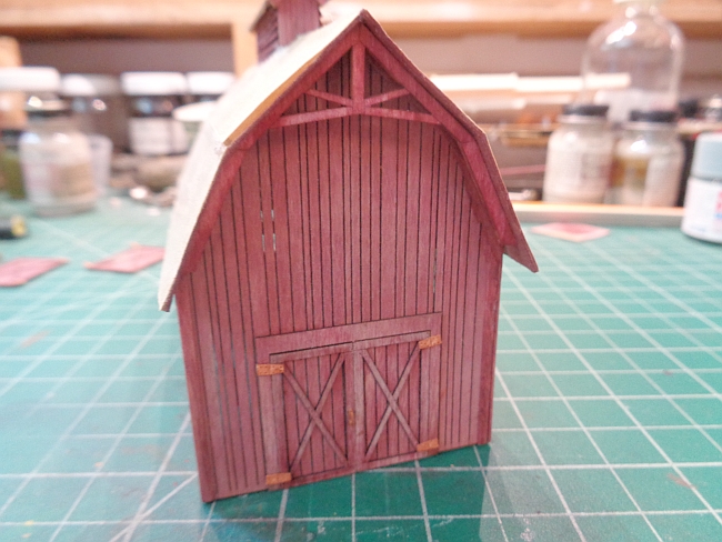

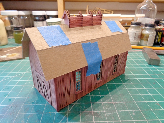

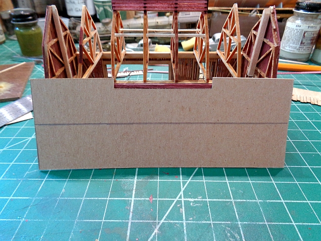

I then used a fresh #11 blade and cut out the roof panel pattern. I marked the center line and lightly scored the center line.
I carefully bent the roof panel to the the truss pattern.

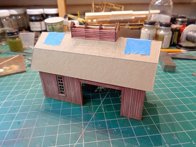

Cut and added the clerestory roof panel.

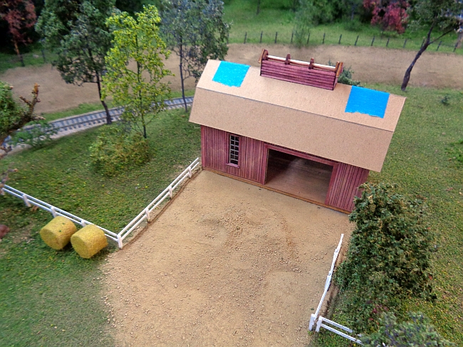

This will be a nice addition to the Perkins Farm.
Done for today on this model.

Tom, something I now do is put a piece of Scotch Tape on the inside ridgeline of the roof panels, after scribing but -before- folding.  That way if the panels want to separate, the tape keeps them in alignment.
Excellent idea, thanks for the trick/tip.

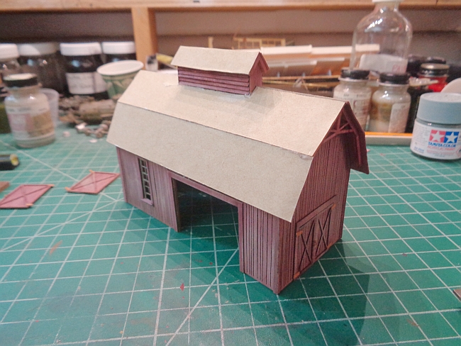

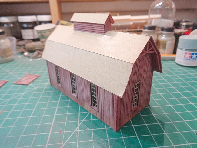

Prior to gluing the roof panels on the barn, I added the 3M transfer tape. I then glued the roof paneling on the barn trusses and on the clerestory.
Front view -
End -
Rear -
Roofing papers, doors and additional weathering are next.
Great update looking forward to the shingles before it snows!!  :)  Wait a minute it doesn't snow where you are!!!
