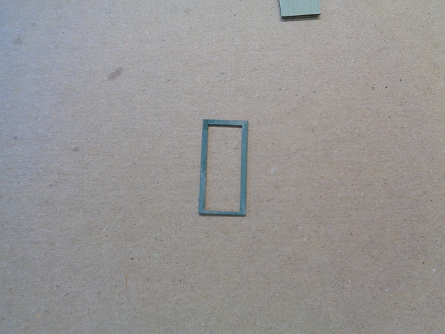

The kit has a door frame that fit around the upper door. The kit also has this door closed. I'm making my door open for another view of the inside of the tower and the interlocking levers.
With the door closed, the frame would fit properly. However, my door open so it was necessary to cut off the bottom portion of the frame.
This next photo shows the door frame in place.

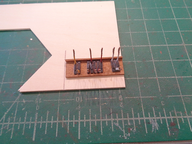

I wasn't satisfied with not having a desk in the tower office area. For a desk to fit, I needed to removed the already glued levers.
I used a small bowl of warm water and using an eye dropper, added a few small drops of warm water to the area around the lever base.
After 10 to 15 minutes, the glue under the base was soft enough for me to pry up the base and clean the floor.
I used some scrap lumber and made a new base.
The base was cut out of the sheet lumber, stained and glued under the levers.
