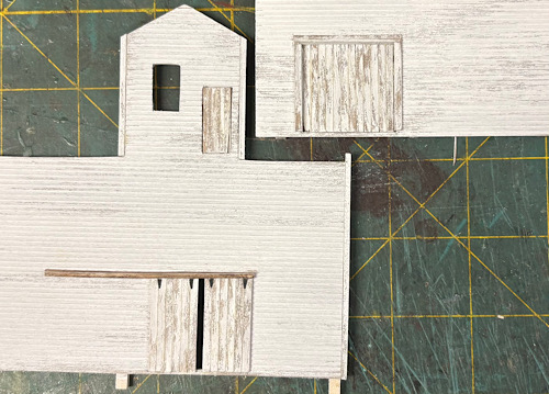

I've been adding trim and working on the doors.
The trim comprises scale 6 by 6 stripwood.  Once the walls are assembled, each side butts up against the 6 by 6 corner pieces.

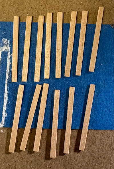

I made the doors by cutting out stripwood:

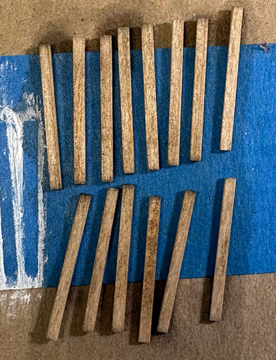

staining the boards:

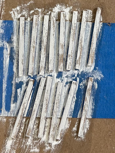

and dry brushing the white paint with a small brush:
Here's the result:
I used scale 3 by 8" planks for the sliding doors and 2 by 4" planks for the man door.
My first attempt did not go well.  I stained the stripwood, cut them out, glued them side by side, and drybrushed the white.  I could not see the individual boards.  My solution was to cut the boards first, sand the edges to round them off a little (not too much), paint each, and them assemble into a door.
