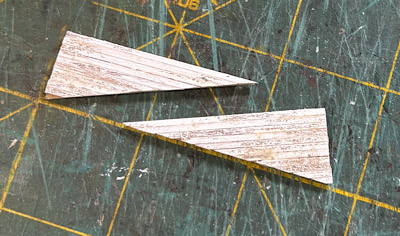

I'm at the stage of adding details.  There's a small false front that I sheathed on both sides and added trim to finish it off.  First, I cut out two triangles from scrap wood:
To this I added scale 2 by 4" stripwood stained and painted like the rest of the building:
Here they are glued in place:
And after scale 3 by 8" stripwood added as trim:

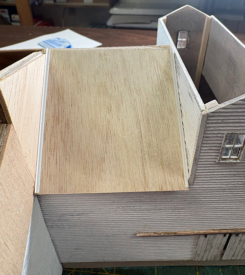

Meanwhile, I've been adding styrene roofing after painting with a slightly off-white spray paint.
First, some flashing:
Many roof panels have been installed.
