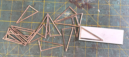

Michael Hohn
The Awning
To build the awning I first made a pattern to get the dimensions the way I liked:
I used the pattern to construct a jig:
From which I build a number of joists:
I decided that I didn't need so many individual joists, so I doubled up some of them.  Then I glued them to a layer of scale 2 by 12" boards.  All components had been stained a brown color to represent unweathered wood that had oxidized over time.

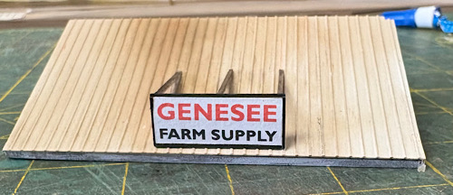

I built a sign by printing the name of the mill using what seemed to be an appropriate font, cutting it out,  gluing it to a backing of 2 by 12" boards, and adding trim of 2 by 3" stripwood painted black.
To support the sign, I modified my jig to make smaller versions of the joists:
Here is the sign glued to the roof:

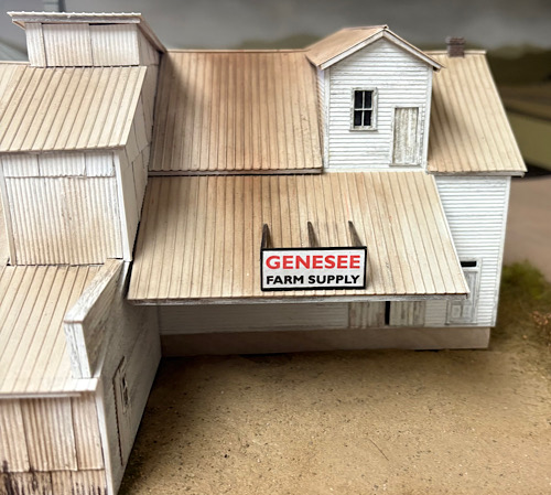

My procedure for weathering the roof was to brush on some Bragdon "Ash" powder, a gray color, to cut the off-white color of the painted styrene.  Then I used a dark brown to represent the uneven rusting of the roof.  In places I used a little rust color for variety.
Here's a photo of the roof glued in place:
I still have a few details to add to the building; meanwhile, I've started work on the grain bins and elevator.
Mike
