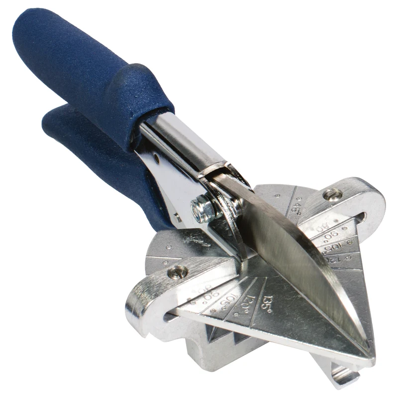

Howdy folks,
I bought this years ago and still use it a lot.  It is especially good for cutting O scale lumber.  The angle guide works well.  It's a called an Easy Cutter Ultimate.  I bought extra blades but have never needed to change it.
