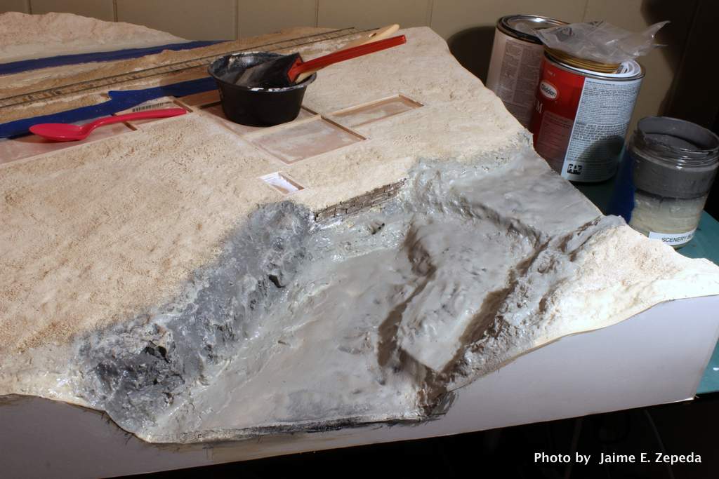

Here is where I got bogged down. I began to paint the river bed. I searched high and low for references and techniques. However, this aspect of model railroading has always been a huge hurdle for me. I am lousy at scenery and struggle to get the colors I want. Nevertheless, here is what I got on my first attempt.
That looks like one of our dogs threw up on the diorama.
I've been talking to THE Runner (Mike Engler) about my build and he suggested I make a test river and practice on that. I am ashamed to admit I should have thought of this already. In past builds I have done a test when trying to get a technique down. So, I made a test river.
I used a combination of earth colors, black, white and blue to blend a passable river bed. It is too dark. But, this is easy to fix as all I have to do is repaint it.
