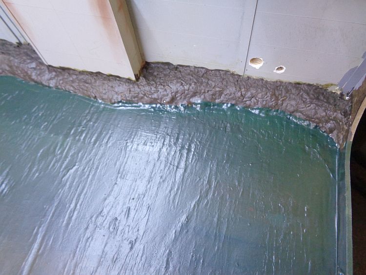

I was able to get a few hours in on the layout today. First, I mixed some Sap Green and Phthalo Blue (Green Shade) acrylic paint and painted it along the river's edge about 5 HO scale feet from the bank. It's just a slightly brighter blue green than the rest of the water.

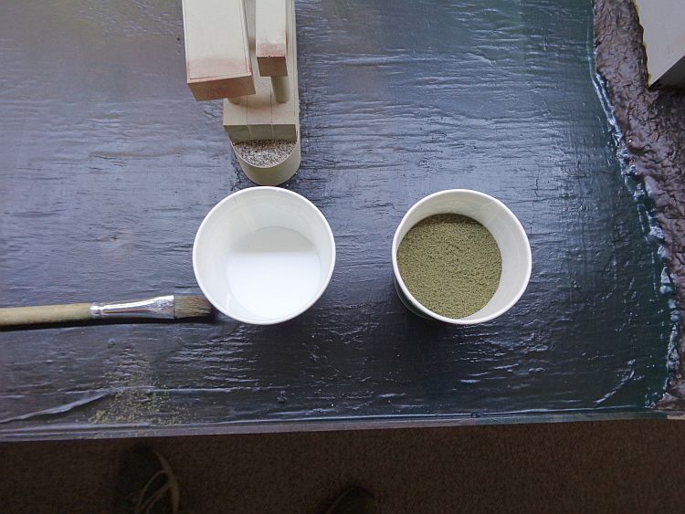

I got the river banks covered in the first basic layer of scenery also. Yesterday, I poured some white glue into a shallow pan and let dry overnight. This morning I skimmed off the top layer of glue leaving me a thicker mix of Elmer's White glue. I'd say it has the consistency of a paste rather than a fluid glue.
Yes, I did this for a very good reason. When I paint the white glue on the river bank, I don't want it to run down and onto the plywood river bed.
I put some of the thick white glue in a Dixie Cup and added some WS Fine Earth #T42 in another cup.
In the next photo you can see the white glue is thick and sticks to the side of the river bank and doesn't flow onto the plywood.

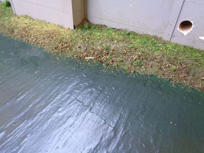

I then take the WS fine turf and spread it over the glue. The snowy patches you see is just the glue coming through.
After about an hour, I lightly sprayed some "wet" water on the turf material. My "wet" water is made using some warm tap water and a few drops of Kodak Professional Photo-Flo 200. It is odorless and the bugs don't like it. Most people use a liquid detergent but I've found when spraying it, I get bubbles.
After wetting the area with the wet water, I use an eye dropper to add a 50/50 mix of matte medium and regular tap water. The matte medium soaks the WS turf. I add a very light sprinkling of WS grass mix on top of the matte medium.
Continued -
I like it, especially that mucky edge we get down here.
While the matte medium is drying, I sprinkle on some Scenic Express Flock & Turf Grass Turf Blend #880C and Scrub Grass Blend #882C. Along the river's edge, I add a very thin sprinkling of my oak leaf blend.
The oak leaf blend is made form oak leaves gathered from the yard, placed in a blender with some water and blended until I get a mush of oak leaves. I then squeeze the wet leaves through an old stocking, pilfered from the Babe, to removed most of the water. I'm left with a paste mix of oak leaves. I then spread the blended oak leaves across a pie tin and let it sun dry. If in a hurry, I bake it dry in the oven at 140 degrees until a soft dry mix as seen below.
It looks a little messy now but in the morning it will be fine. I'll show you the difference then.

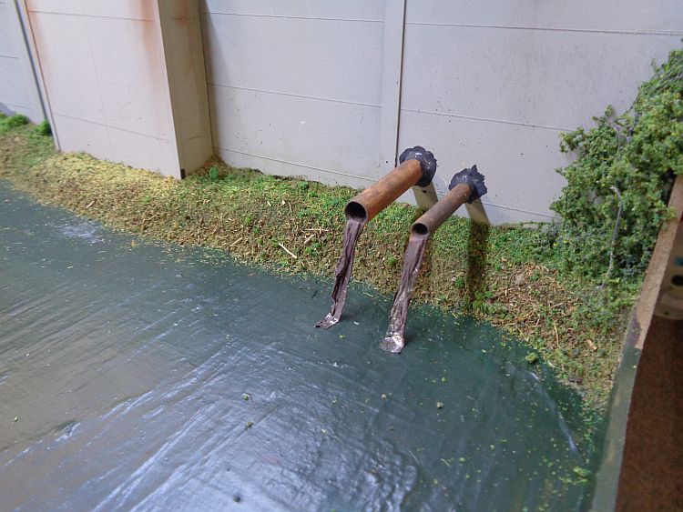

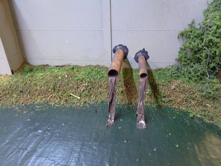

I got a few hours in on the layout today.
I weathered the drainage pipes and installed them.
