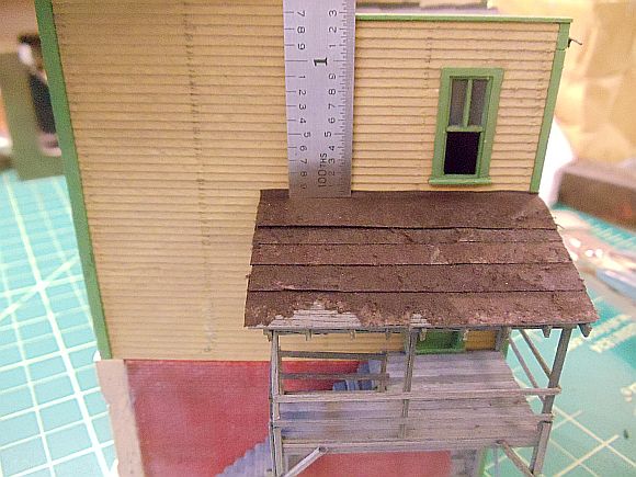

I then finished adding the planking for the canopy.
I used some black roofing paper, cut in 3 scale feet widths. I used a #17 blade to rough up the papers.
The papers were glued in place.
The last piece next to the wall was pressed into place using a small metal ruler. Be sure you allow a little of the paper to over lap to represent some flashing.

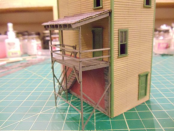

The porch including the stairs, posts, rafters and railings are in such disrepair you don''t notice the extra bracing I added.
I used A&I and touched up all the exposed stripwood ends. I used several white, grey and black pastel chalks to weather the main and porch roofs.
