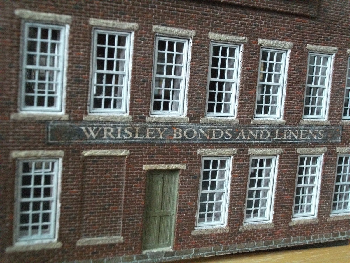

EricQuebec
Hi,
The technic I use for brick color is exposed here :
http://modelersforum.com/index.php?topic=552.15
Eric Québec city

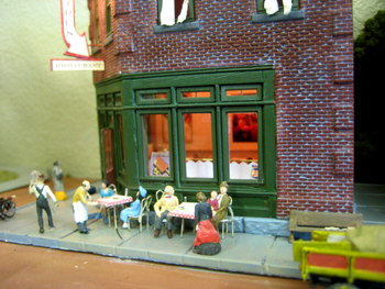

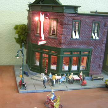

Love the brick colors Eric.  8)
Great work Dave.....love the scene and structures.  8)
tom.boyd.125
#8
Dave & Eric,
Really nice brick coloring builds to show in this thread. Dave, you used my favorite craft paint brick color.
Eric, the brick coloring done on the Wrisley Papers brick addition is excellent ! Great build thread too.
Another thing to mention if you look at Eric's photo is to paint individual bricks different colors like black, earth, or another shade of red.
