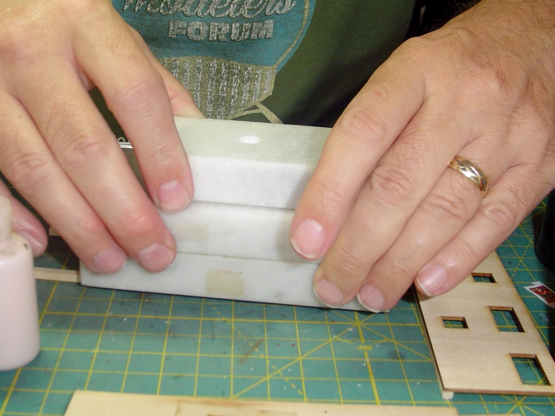

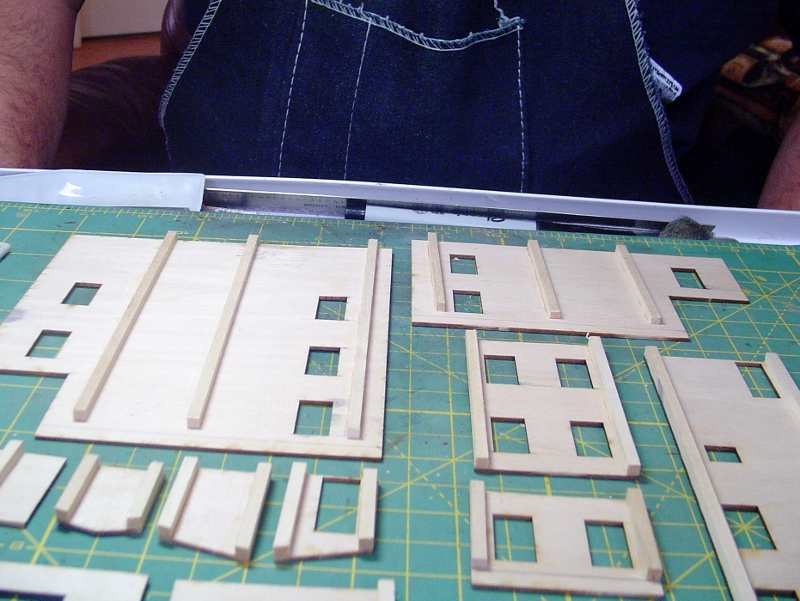

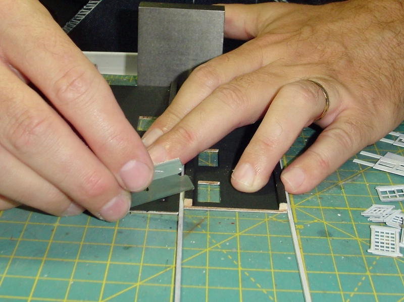

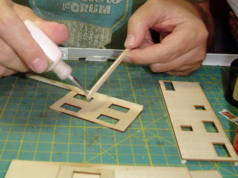

I located all the clapboard walls and started bracing them per the instructions.  In a few instances I had to figure out where the bracing should stop short of the top of the wall.  The instructions indicate (in all but one instance) that the bracing should stop short but not how short.  I figured out how the walls would be placed together and used the rear wall to gauge the where the top of the bracing would go on the front and side walls.
I weigh down the braced walls with some marble blocks liberated from some old bowling trophies.   :D
After the glue set I trimmed off the excess bracing, where necessary, with a single edge razor blade.
Everything has had bracing applied.  I'd learn later, during assembly, that the one wall in the middle on the right hand side (the one with four window openings) should not have bracing that runs all the way to the top.  There's a recessed roof that the bracing will interfere with.  After the wall were joined together it was a bit tricky to shorten those braces a little bit but I managed to do it.

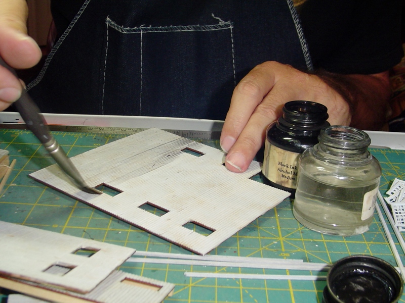

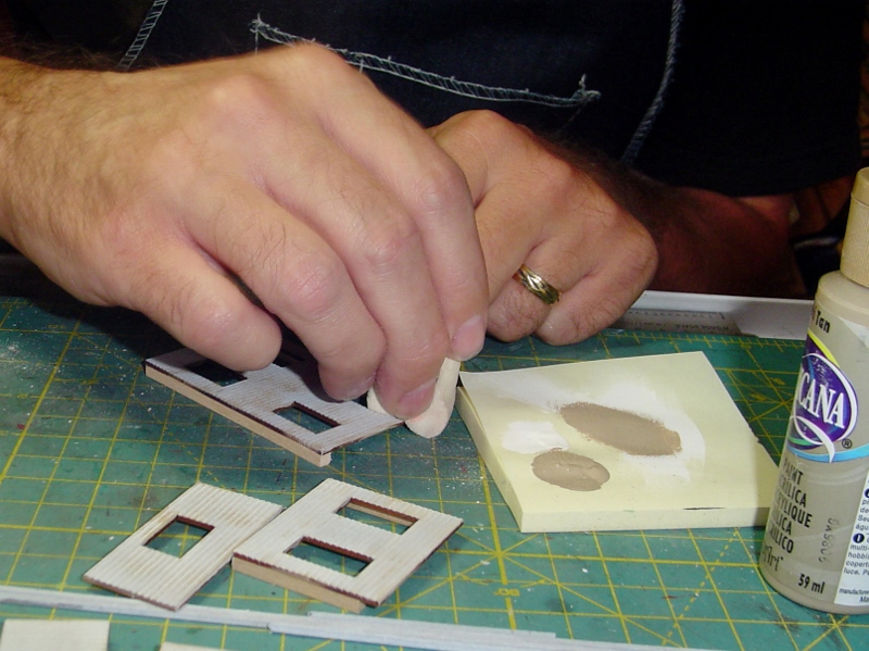

I painted the walls with PollyScale Reefer White followed by drysponging some Light Gray and Khaki on to represent peeling paint.

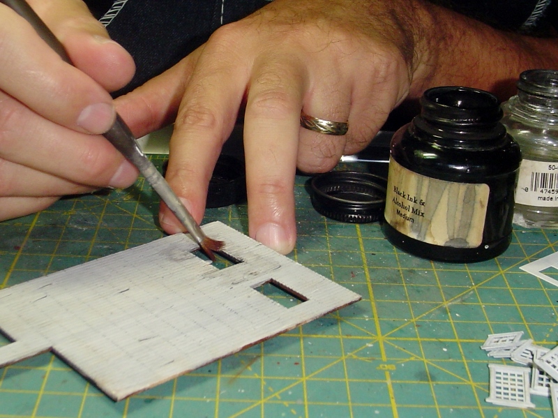

After applying nail holes and loosening up a few of the clapboards I applied an light A&I wash.  My normal A&I is a bit dark over white so I loaded my brush with straight A first and then dipped in the A&I which served to thin it out quite a bit.

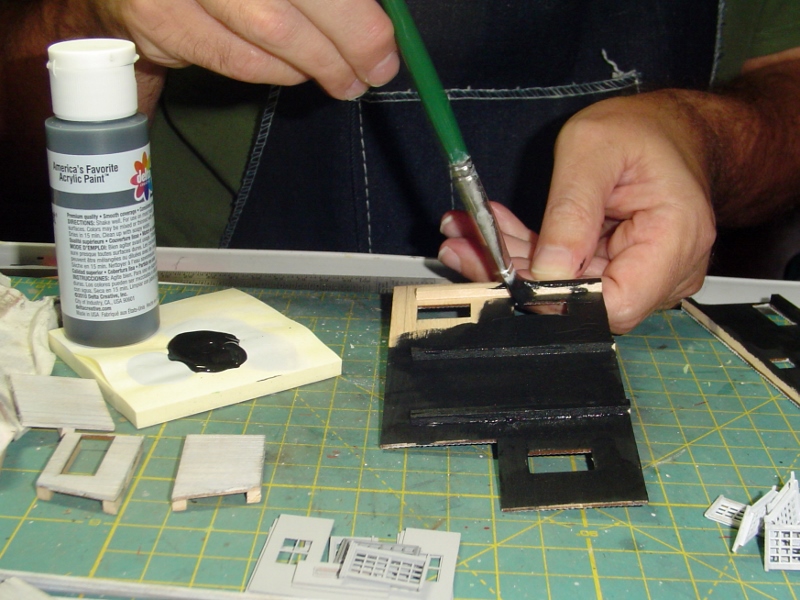

I do plan on lighting up (and providing some interior details) a few of the rooms of the hotel so I painted the inside of the walls black using a cheap craft store acrylic paint.   Now, one thing I'll mention, when I was painting/staining the upper portion of the walls where the bracing didn't reach all the way to the top I was careful not to paint those sections with a brush that was fully loaded.  I'd start below them and work my way up so the upper portion of the wall never got too wet.  It seems to have helped.  I didn't have any problems with warping.   :D

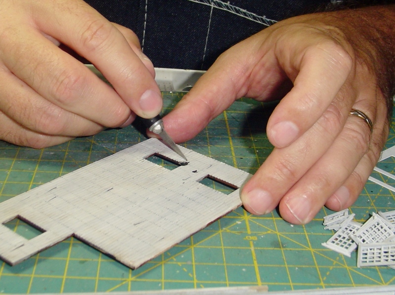

I'll be the first to admit I'm far from perfect and screw things up now and then.  But I can usually cover up my mistakes.   :D  When I painted the back of one of the walls black some of it got on the outer surface.  D'oh!   :o  I flicked/scraped off the offending paint as best I could with the tip of my X-Acto knife.
Then I gave the area another wash of thinned A&I.  Nobody will ever know.  Well, except for you.  Don't tell anyone.   :P

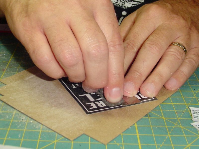

I cut out the large sign that goes on the side wall and test fit it against the wall to get a feel for where it would go.
Then I lightly sanded the back of the sign to make it thinner.  I worked from the center out very carefully sanding the sign.
More in a moment....

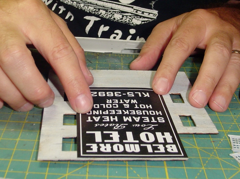

I rubbed the sign, from the top down, with a small piece of steel wool.  This removes some of the black ink and lightened up the sign a bit.  I also brushed it with a thinned A&I to tone down the white lettering a little bit.
Instead of using 3M Transfer Tape to attach the sign to the wall, as the instructions suggest, I opted to used thinned white glue.  I smeared the back of the sign with good old Elmer's White Glue thinned with water.
I then quickly positioned the sign on the wall.
While the glue was still wet I used a finger nail and carefully burnished the sign into the clapboard walls.  It's better to cover the sign with a piece of plastic to do this, which helps prevent tears, but I successfully did it without the plastic.

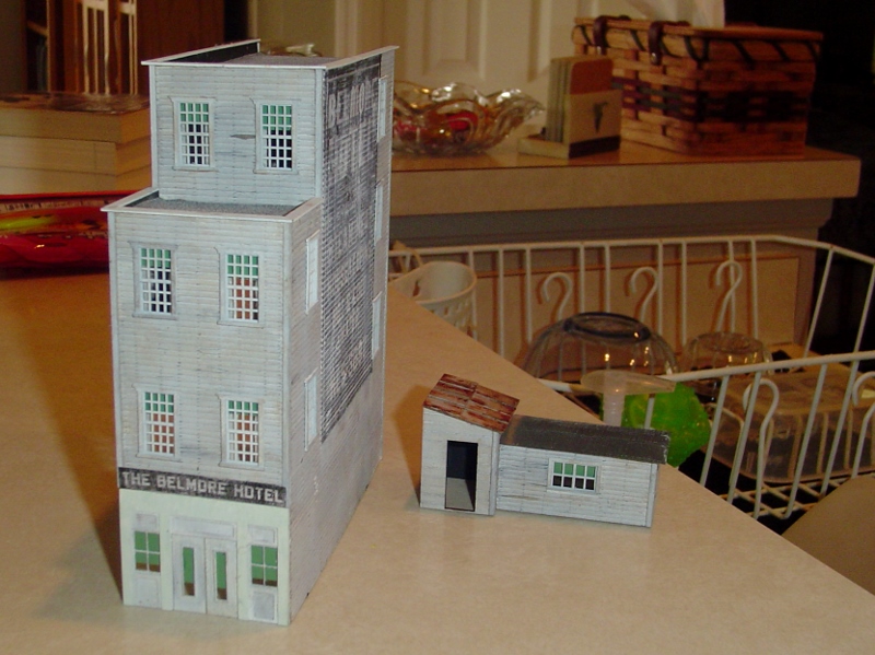

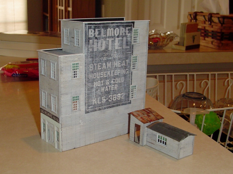

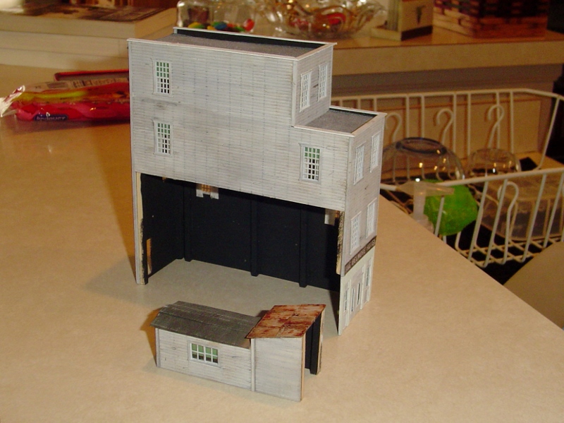

I then weathered the sign with more drysponging and drybrushing.  Then I finished the assembly of the building as well as the attached sheds that will sit on the roof of Mitchell's when I build that and join it to the hotel.  Note, I though I was short one window so I pulled one out of a pack of assorted windows I bought from Tichy but it turns out I was wrong.  The window opening on the bottom right of the side wall doesn't require a window.  That's where the shed will seat up against the side wall.  Oh well.
Here's the partially finished structure, sans the roof top signs and details that will be added after all seven buildings have been completed and joined together.
A couple more photo's in a moment...

I over did the weathering on the sign on the side wall a bit but I think it'll look okay when everything is put together.  There's so much for the eye to take in on this kit that it might blend in okay.
