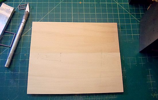

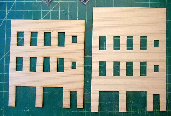

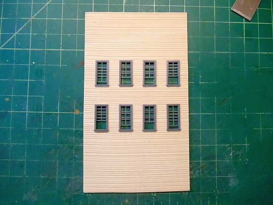

I got the new wall cut out and all the windows and doors fit the openings. The original wall is on the left.
The back wall was cut and the windows fit as well.
The back wall is a little more narrow than the front. I did this so it would fit my space.

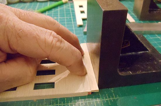

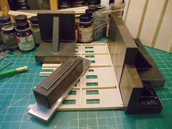

I cut and glued a piece trim board to the top of the front and rear wall sections.  I'll cover why the trim board was added later in the thread. I also added all the bracing per the kit instruction but I added more due to my building being much larger. The walls were weighted until the glue dried.

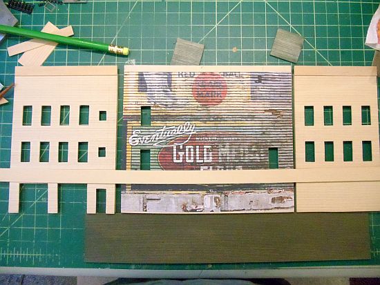

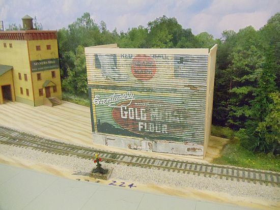

For the track side wall, I cut two pieces of 1/16" basswood and edge glued them. I then applied some scale 10X10's for bracing on the back side.

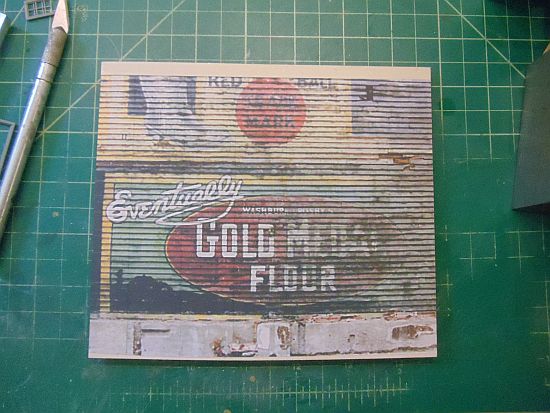

I then glued the sign to the front of this wall section.
Notice the concrete at the bottom of the sign? I originally had this cut off. However, in so doing I had to make the sign larger. The larger sing didn't look to scale for the clapboard siding. So, I went with my original sign size. The concrete at the bottom will be hidden by weeds and track side debris/details.

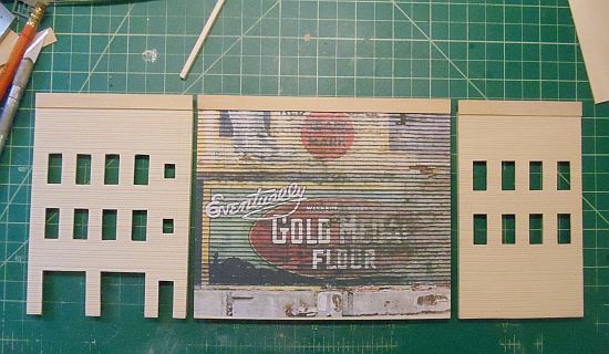

Here is a look at the front, track side and rear walls. The top trim piece on the track side wall is not glued in place. I still need to paint this piece prior to gluing it in place.

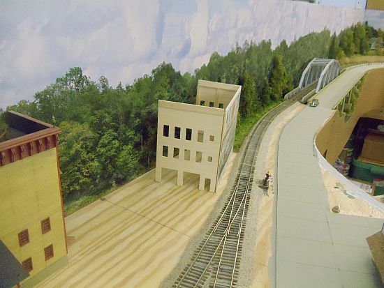

Here is how I plan to place the new version of Verick Freight.

MISTAKES HAPPEN:
When cutting in the window openings on the wall with the signs, I cut them at the wrong level. I was going to just leave the opening but I'm sure a rivet counter would call me on it.
I didn't want to build another wall and sign so I fixed this one.
