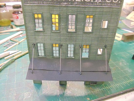

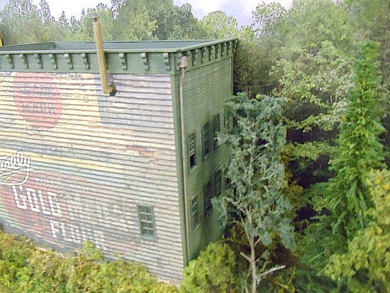

I apologize for the lack of an update but I've been busy on the layout scenery. Here is what I've been doing with the build.

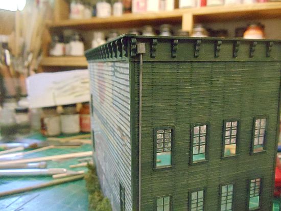

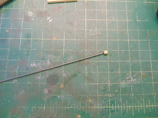

For the scupper I cut a small square of 10X10 scale strip wood, drilled a hole in one end and glued a .019 piece of wire in the hold.
I bent the wire to fit the building and then painted it with Floquil Old Silver. It was then glue to the corner of the structure.

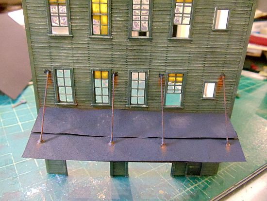

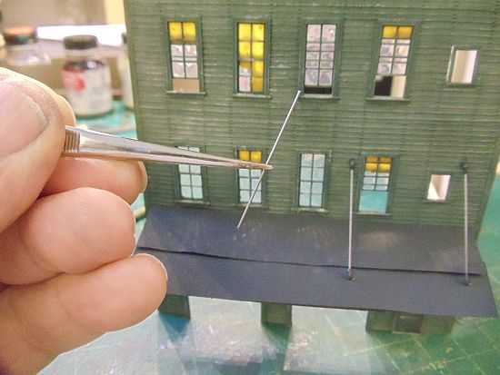

I made a new canopy for the front and extended it to cover the office door. I cut four, equal in length, wire supports from .025 wire. I dipped both ends into some Gallery Glass Liquid Leading and used tweezers to place the wire on the canopy and front wall.
When the glue on the wires dried, I painted them with Floquil Weathered Black and applied some Bragdon Weathering chalks to simulate rust.
What appears to be some misplaced rust chalk is just light coming through the lower windows.

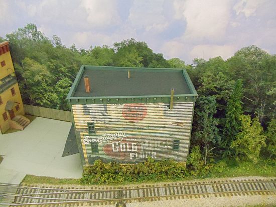

I also added the chimney and pipes that came with the kit.
Scupper looks good, the bend helps make it look like it belongs.  The supports for the roof/awning are a good detail.

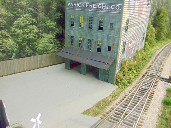

Really great looking structure with that fantastic sign ! Good tip using the Gallery Glass Liquid Leading to place on the wire ends on the front canopy supports rods. Like those corbels too. Is there a location to the link to print out that sign you used on this build mentioned someplace ?

Very nice, that huge wall sign turned out great.
