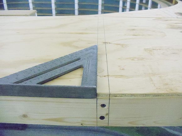

Quote from: BandOGuy on March 24, 2018, 08:18:04 PM
Quote from: ACL1504 on March 24, 2018, 05:44:02 PM
These two sections will be screwed in place tomorrow. In preparation, I used a carpenters square and marked where the cross braces are located under the plywood.
Prior to laying the plywood in place I marked the edges of the 1X3 so the screw will be in the center of the 1X3 cross brace. By marking the plywood in the same manner, the screws will be located between the lines which represent the 1X3's below.
Thanks for following along on this new adventure, the third level build.
I'm all braced and aligned for more photos Sunday.
