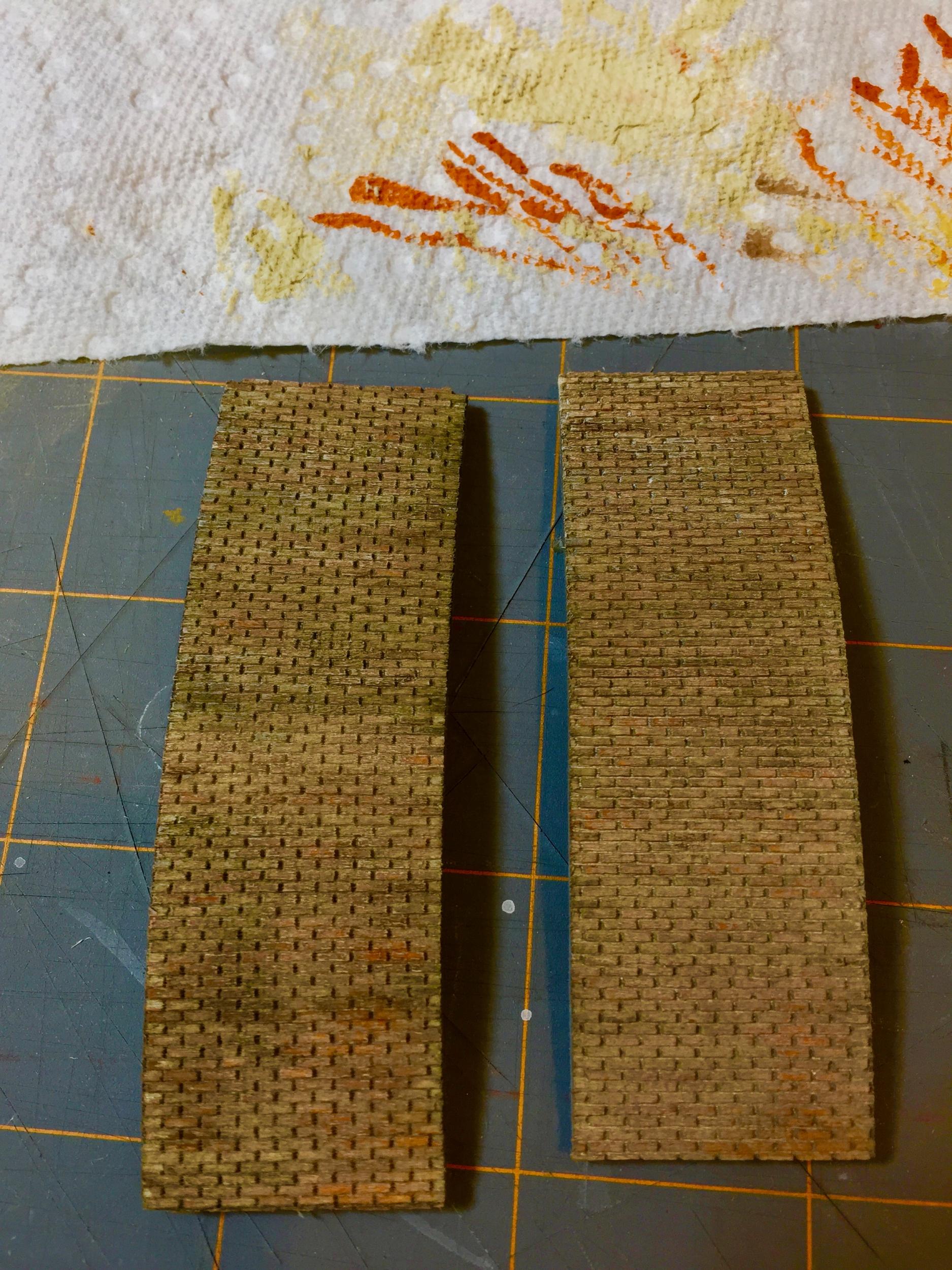

Well, today I got serious about starting this project.  After cutting the brick material I need to finish the floor in my Locomotive Works Project I cut 5 sample pieces to play with brick coloring techniques.
Step one was to reread all the coloring information on Jimmy's Monster Model Works website.
I'll be looking over your shoulder to see what you some up with for coloring.
So here are the two samples that I like the best. There are differences in the number of process steps I used which I will explain tomorrow when I have time to post the process steps. The one on the left has a different pre treatment on the top half.  I took pictures of the process and learned a lot about working with this wood brick material today. What do you think? I wanted to post this picture tonight to see what you think. More tomorrow.
I prefer the one on the right.  On my monitor the one on the left appears to have a somewhat greenish tint that looks unrealistic, at least to me.
The one on the right looks more realistic  to me , the left has too much contrast imho.
Dave K.
Thank you for the comments on the samples.  I have a couple more samples that I want to do with ideas that have come up with the first batch and then I need to organize the pictures and post the story on this. This has been a fun project - the one conclusion I have already made is that the techniques that I have used for years on plaster and resin castings don't work the same on the wood. I'm beginning to like this material for brick more and more as I learn how to work with it.
engine909
The only difference between the right and the left is that I used light grey wash that toned down the A&I affect that gives the one on the left a greenish tint. It also blends the colors more.  I decided to do one more experiment before I make the final choice for this build. I made three more sample pieces and painted one with sand primer, one with lt. grey primer and the final one is coated with A&I with less ink.  The samples in the picture are with 3 tsp. to the pint mix.  The new one will be with 2 tsp. to the pint mix. It will be a couple days before I get back to this project but I will post all the pictures of the process when I have the final sample results.
