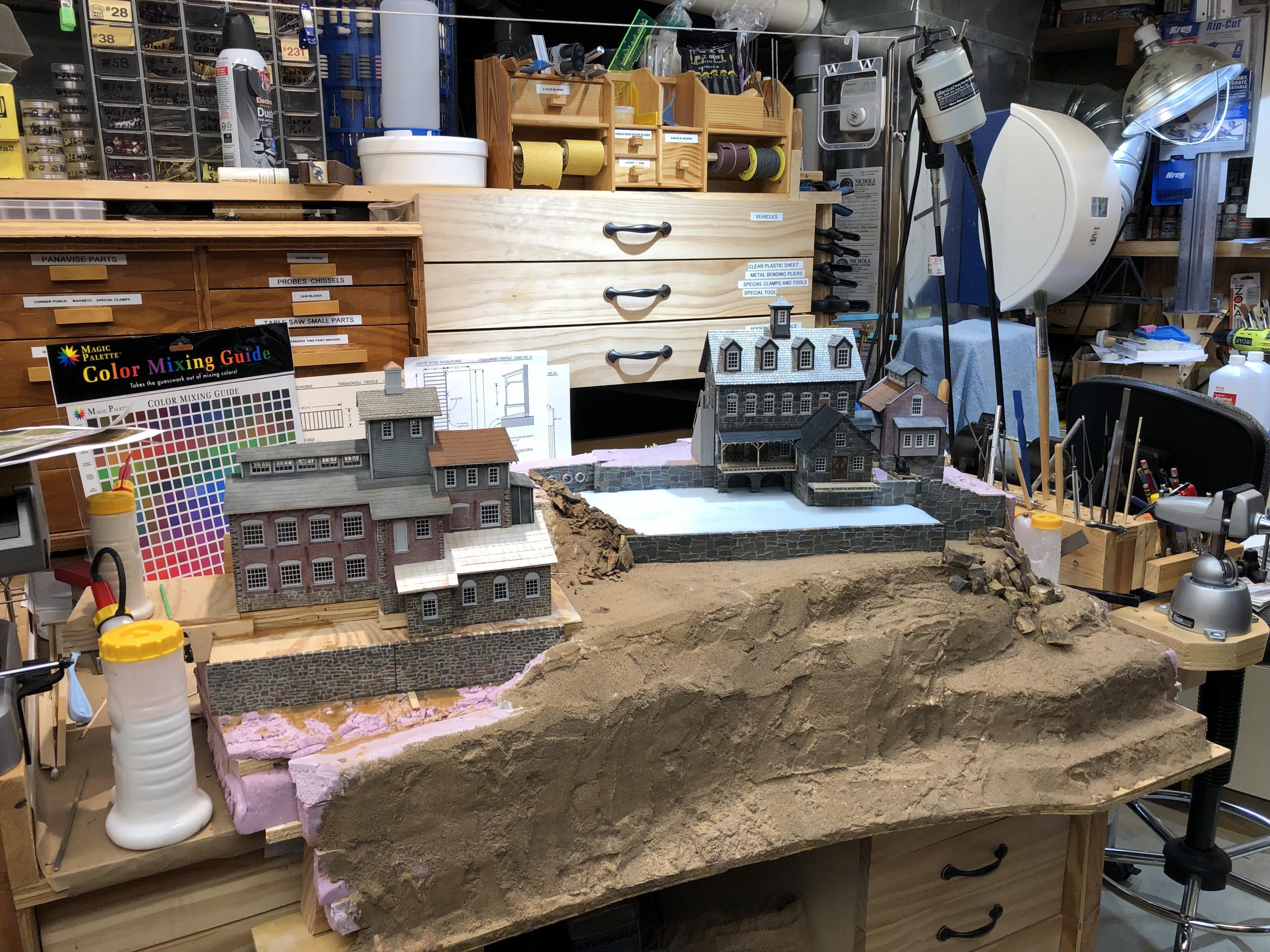

Quote from: vinceg on January 01, 2019, 09:23:53 AM
John -- Did you make those drawers in the background ("ROOFING MATERIALS, etc.). As I am now trying to organize my basement, I'm looking to steal some good ideas.
Vince
Yes - the drawers were added to my rolling workbench last year. I really like them - I needed a way to organize my scratch building supplies. The boxes under the train table just wasn't working. There standard drawers made from #1 Pine with roller bearing slides. Having one place where I keep roofing materials, or window castings, etc. really helps with finding what I'm looking for.

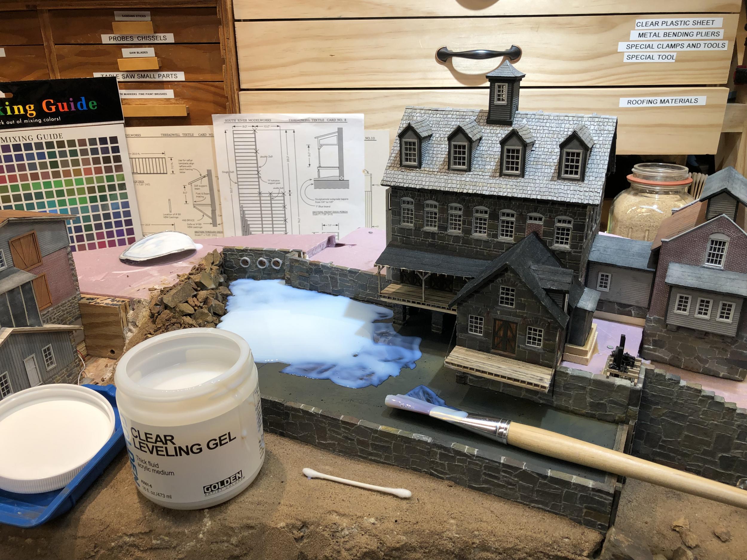

Today, was water pouring day on this build. I added some rocks along the left side of the mill pond, and down below the dam, where the river will start, and then poured the first pour of water.
I'm using Golden Clear Leveling Gel for the water. This will be my first experience  with this product. It comes highly recommended.
A few pictures after the pour was complete.
I was very happy with the way this product poured.  Thanks to properly executed fluid mechanics the extra poured right over the dam as designed. Now it's wait and see how it cures.

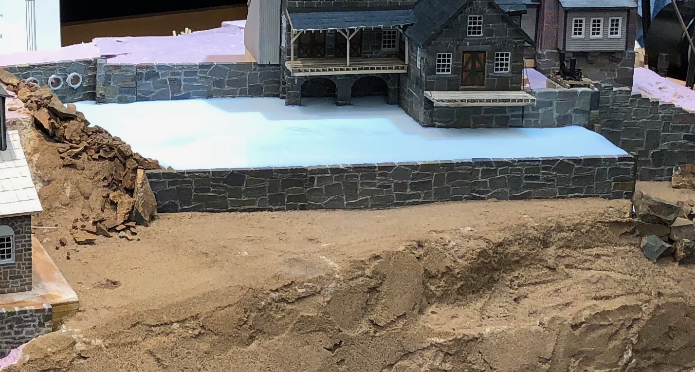

So, I have a bit of a setback to report on the Threadwell's build. I thought I would post this sad story here to see if anyone can shed some light on what happened. As, I said above the material I'm using Golden clear leveling gel came highly recommend, but this is the first time I have used it. On the container it says to do a maximum pour of 1/16 inch deep. So here is a picture of the pond before the pour. The distance from the bottom of the pond to the top of the dam spillway is 1/16 inch. My safety so I wouldn't pour it too deep. As you can see in the picture above the access spilled over the dam.

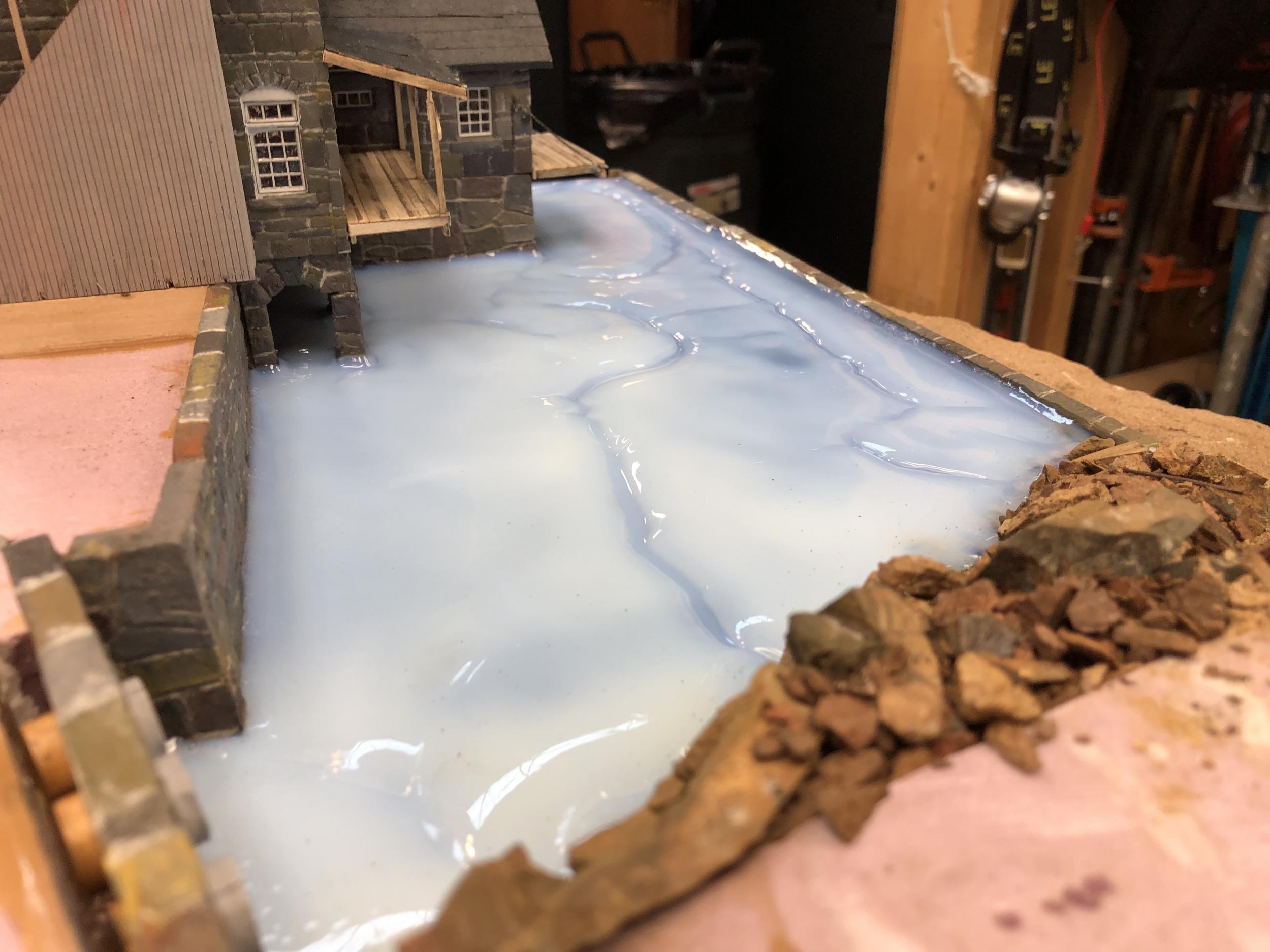

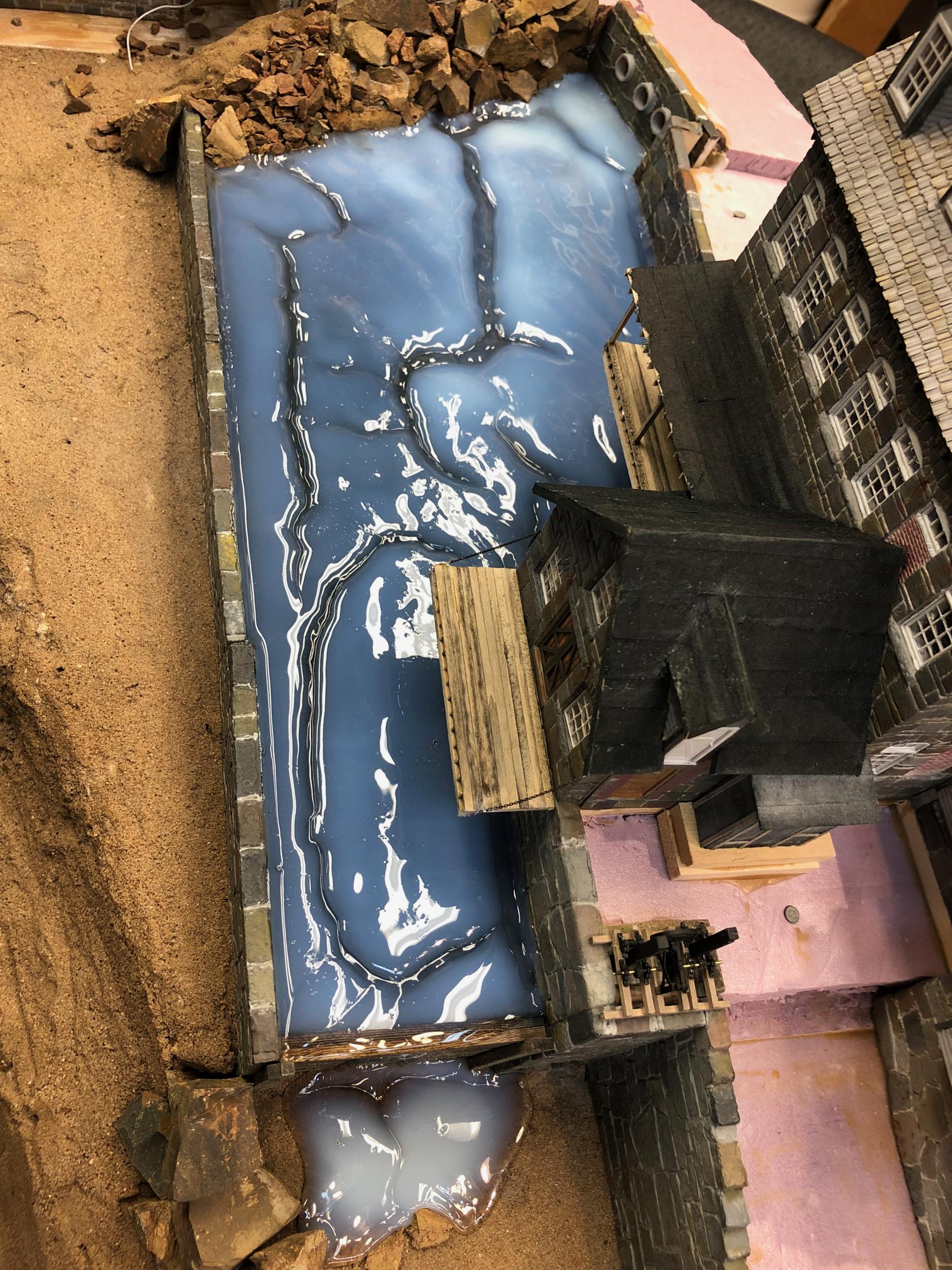

So after the pour I noticed that the material was getting higher and higher on the stone walls.  It was expanding as it started to cure. ::) :o  Before I went to bed - about 6 hours after the pour it was at the top of the stone walls - about 3/8 of an inch. No more material was spilling over the dam. S**T. I  also noticed that it was turning clear around the edges down below the dam and that the material thickness was much less in the clear areas than in the center. Maybe it will get thinner as it cures. Here is a couple of pictures that I took that evening.
#594
So in the morning, I turned on the lights and found this. :o :o :o :o :o :o :o :o :o :o :o
Notice how the depth has gone down on the stone walls.  In the trenches it is back to 1/16 inch thick.  Getting more trenches as it cures but most of that occurred in the first 24 hours.
Yes - it does look like a frozen pond with overflow. Not what I was going for!
So after 48 hours of curing here is what it looks like. Ninety Eight percent of the changing occurred in the first twenty four hours.  I'm getting real tired of waiting for some positive change at this point.
The trenches you see running through it are about 1/16 inch thick and pretty clear - the white areas are three or four times that thickness and opaque white.
