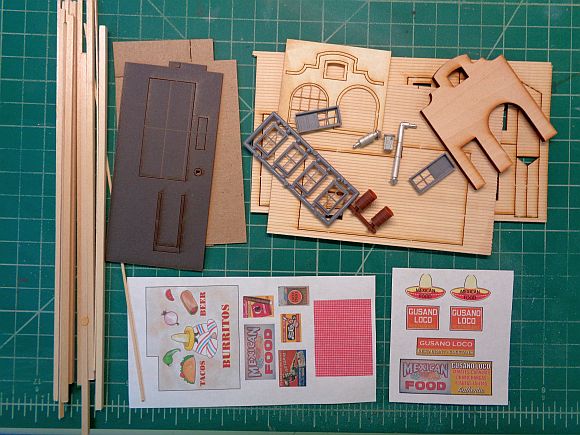

I decided to take on a small build while waiting on other layout related items to dry. I started this build this past Monday afternoon.
I pulled Gusano Loco Mexican Restaurant from the unbuilt kit stash. "Gusano Loco" in Spanish means Crazy Worm. Doug was being very kind when he used the word "worm" for Gusano. I've heard gusano used on the street by gang members and trust be when I say it certainly doesn't mean "worm". Although "Worm" is one of the generic meanings.
This should be a quick build. I'm not adding lights as this one will be used in an area where most all others will be lit. If any lighting is done, it will most likely be done on the build board of under the front door.

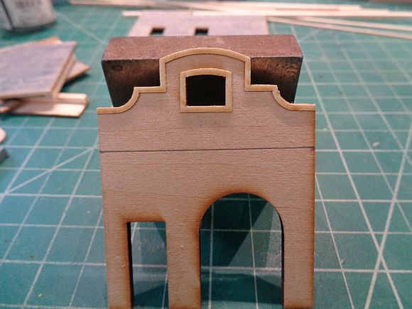

I removed the walls from the carriers and sanded the edges to remove the "kerf", laser angle cuts.
Bracing was done next.
After the bracing was thoroughly dry, I applied Hunterline's Light Gray to the exterior side of the walls.
While waiting for the A&I to dry, I glued the two trim pieces to the front wall.
I then measured and drew a pencil line horizontally on the wall to indicate where the front roof section will fit against the wall. Also, this wall will get a treatment of stucco above the pencil line.

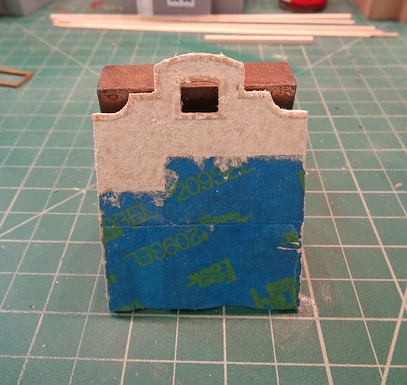

In Doug's instructions he stated he used water putty for the stucco effect. He further stated that if you add to much, the water putty can be sanded to remove the excess.
Well, I'm using Durham's Rock Hard Watty Putty and when dry, it is the hardest material to sand, period. So, I added two very light coats of the water putty.
There is a reason it is called Rock Hard. Ever try to sand a rock?
The wall was taped with painter's tape to keep the putty off the lower portion of the front wall and below the pencil lines.

Here is how it looks after two light coats of water putty was applied to the wall.

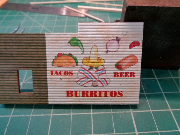

After the walls were painted and dry, I added the large sign.
I marked on the back the area of the sign. I used an Emory board to sand the back side of the sign.
I cut the sign to fit the side wall. White glue was painted on the rear of the sign and then it was carefully placed on the wall.
You can also see the wall color in the next photo.
While still wet, I used me thumb to press the sign into the clapboards.

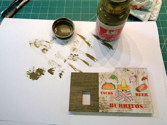

After a few hours, I used the same Floquil Hunter Green to add weathering to the signage. I used the paint full strength and dry brushed the paint onto the sign.
