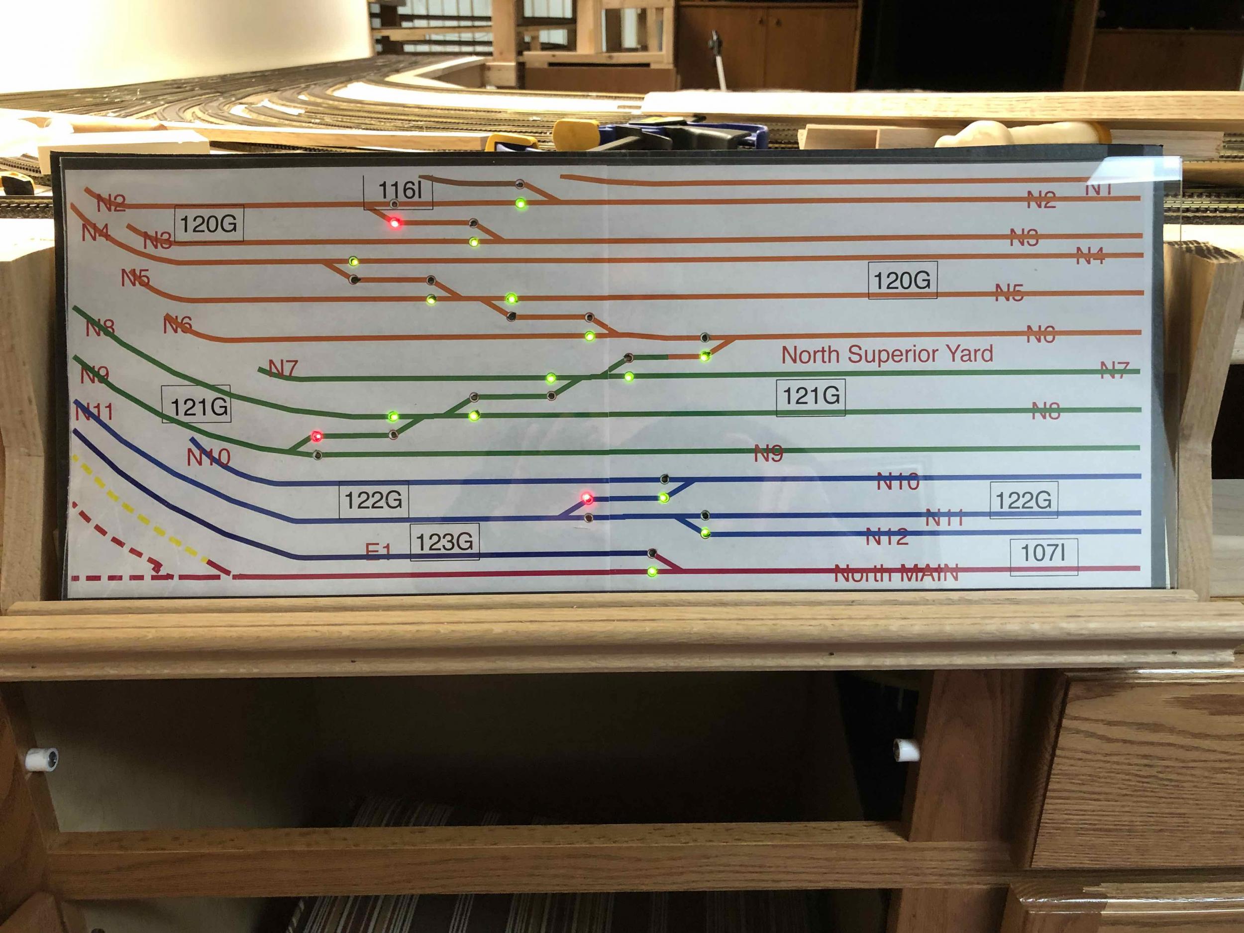

Thank you for the kind words.  The foam boards are held in the control panel with moldings which are attached with screws. The wiring is all accessible from the back of the panel.  I could actually replace most of the touch control switches from the back.  Some of them are behind bracing which would require removal of the panel from the front. See picture below.
Tonight, we have power to the second of four control panels for the Superior Yard. Tomorrow, I will trim this control panel out and start on number three.

Update: It looks like I'm going to add a fifth control panel to the Superior Yard.  I original was going to have the controls for the reversing loop, the helix and the roundhouse mounted right on the wall next to the roundhouse. After thinking about operations it would be nice to be able to control these turnouts from three locations: the main control panel at the Eagles Nest Yard, the control panel for the Superior Yard, and right near the roundhouse.  So I'm going to try a Barrett Hill device that allows three different touch switches to control a single turnout.  If you throw the turnout with any one of the three touch switches the lights sync to indicate the direction that the turnout is thrown.  Stay tuned I will let you know how it works.
