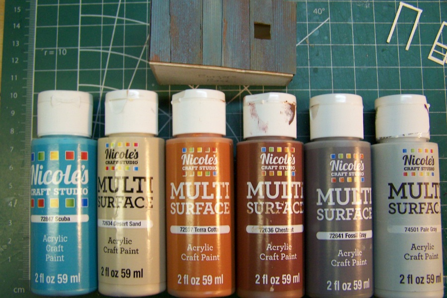

Bob, below is a shot of all the acrylic paints I used, lined up, to get the "final" color on the corrugated siding (not really final--I'll play around with a few more streaks of rust and grime in the final weathering step.)
I diluted them with water to various degrees.  Some just slightly where I wanted a stronger effect, some to a greater degree where I wanted a wash.  The base color of Rustoleum red primer also muted them.
In case you find it difficult to read the color names, they are, from left to right: Scuba, Desert Sand, Terra Cotta, Chestnut, Fossil Gray and Pale Gray.
--George

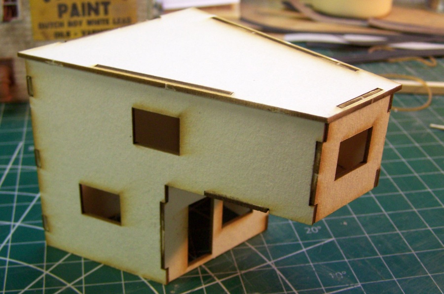

I set the first two structures aside for now--let the paint and glue fully dry before adding additional details.  Next up is the gas station. As this is a stucco structure, the walls are fiber board and will assemble via tab and slot construction.
Although the roof is not to be added until later, I have it on, but not yet glued, in order to keep the wall angles accurate.
Here is the assembly as seen upside down, showing the scribed wood ceiling, which also helps guide the shape.  I added nail holes, but little distressing as this would be in a protected area. Hunterline Light Gray brings out the texture and the nail holes.  You may note at this point minimal internal bracing.  I'll add some bracing after the entire assembly fully dries. As there was no A&I application, there was no fear of warping at this point.
The next step in the instructions made me pause. The posts on the gas pump island are cut to fit from 1/8 inch square strip stock. However the pilot model shows the structure on a foundation, whereas no foundation is mentioned in the instructions and none is provided, that I could tell.  If the structure is later elevated on a foundation, the cut posts will be short by about 1/16th inch.
There is a sidewalk provided for this structure, so I went to my parts box and found a scrap of 1/16th sheet wood, the height matching the sidewalk, large enough to accommodate the gas station.  I cut it to fit, and can now measure and cut the island columns.
Here, the core assembly is drying.  The roof, foundation, sidewalk and gas pump island are not glued yet.
