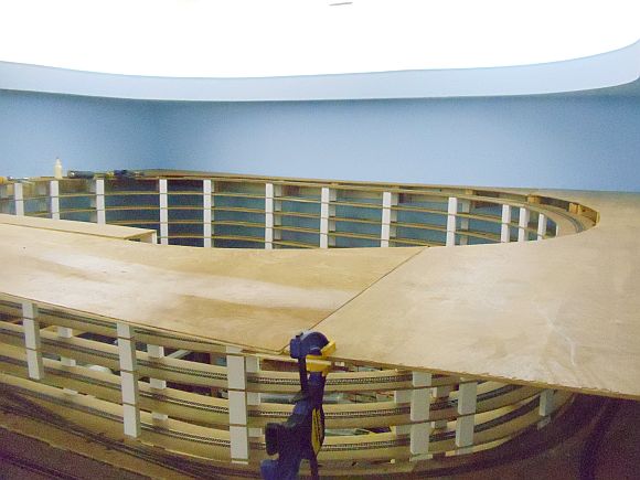

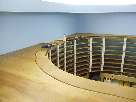

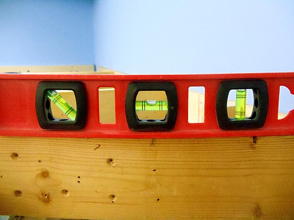

I finished a little more on the Ovalix. I glued and screwed the cross braces for the third level decking.
The rest of the third level cross braces look like the ones above so I'll skip those photos.

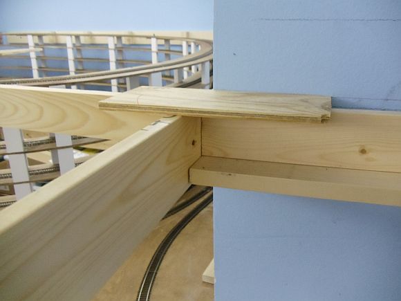

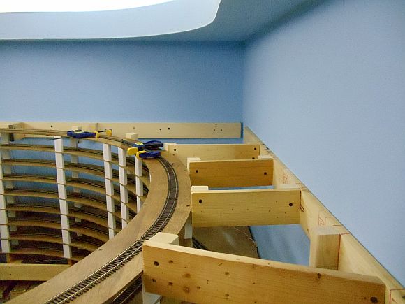

The next two photos show you how the third level bracing coming off the Ovalix joins the third level wall runners.
The small piece of 3/8" 3 ply plywood sits on the Ovalix braces and the wall runner. The third level cross braces will be attached to the wall runners.
Here is a photo of a cross brace. I tired to use as much of the old lumber from the old layout as possible. You can see the cross brace was used in the past for other purposes.

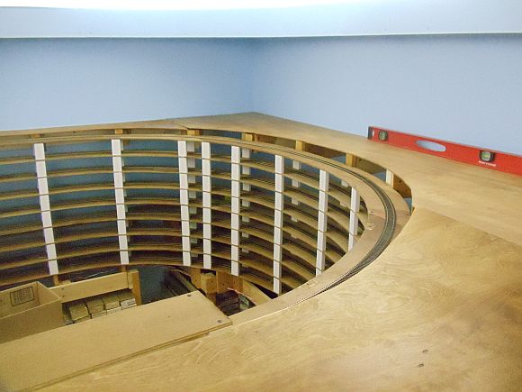

Did I ever mention level is a good thing?
Here is how the top of the outside of the Ovalix looks with the third level decking. It isn't screwed to the cross braces. I'm just giving you an idea of how it will look in a few weeks.
