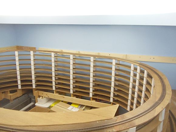

Over the past several weeks I was able to get more work done to complete the top of the Ovalix.

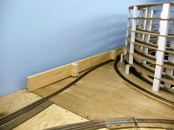

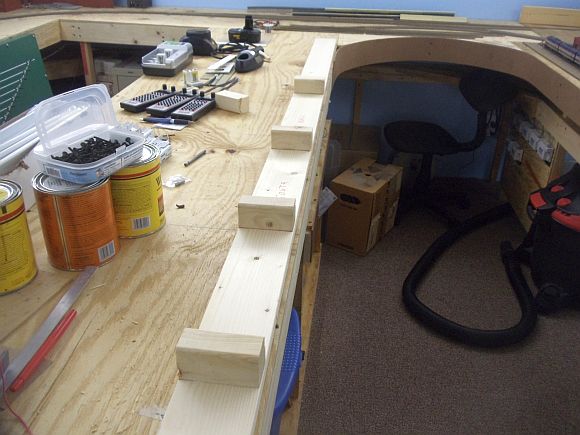

I screwed the 2x2 blocks to the 1X4's prior to tapconing them to the wall. This is the North wall.

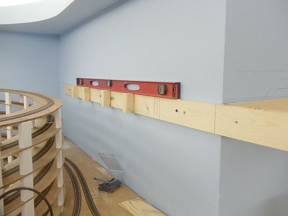

Then they were tapconed to the wall.

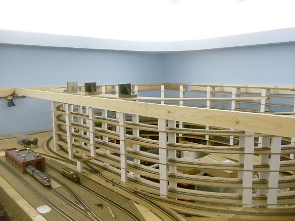

In the photo below you are looking at the west wall of the Ovalix. You can see there are nine loops on the Ovalix. The first loop trackage goes behind the Ovalix and then begins the upward climb of 1% grade with each loop. One loop is 26 feet. The train has to travel 260 feet to get to the top.
The South wall 1X4 is ready to be placed on the wall.

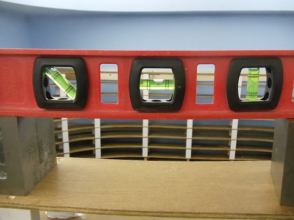

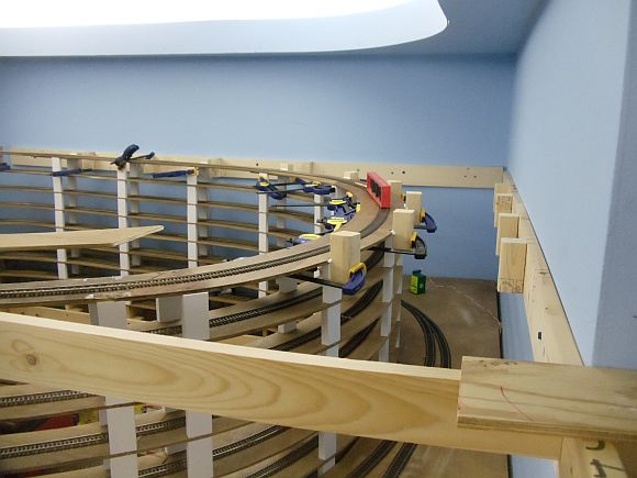

I made sure the top level of the Ovalix was level. Being on the level is a good thing.

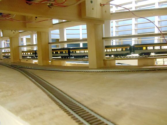

The Judge and I took a little time out to run the C&O passenger train up the Ovalix. It took almost 15 minutes at 30 mph.
I next glued and screwed the 2X2 blocks to outside of the Ovalix and made sure they were all level with the blocks on the 1X4's. Remember, being on the level is a good thing.
The support 1X3 was also added at this time.
