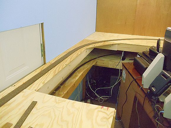

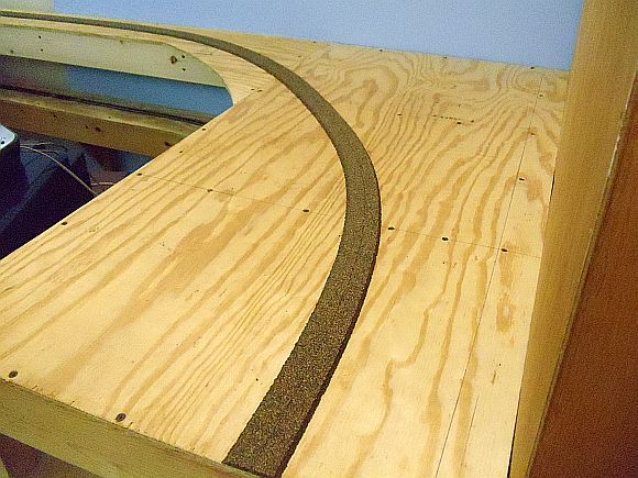

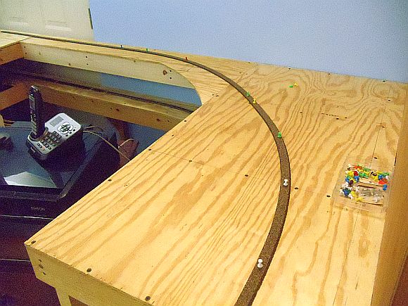

Today I started the track laying process for the second level. I focused on the area behind the computer and used a few pieces of cork to get a nice 38 inch radius.
After the 38" was established, I marked the line with a black marker.
I used Elmer's Carpenter's Wood Glue to glue the cork to the plywood. When the glue has dried for a couple of days, I'll sand the top of the cork so the track will have a nice level roadbed. After the sanding, I'll add some strips of .10 to .20 styrene for a super elevation. Track will follow after that.

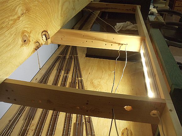

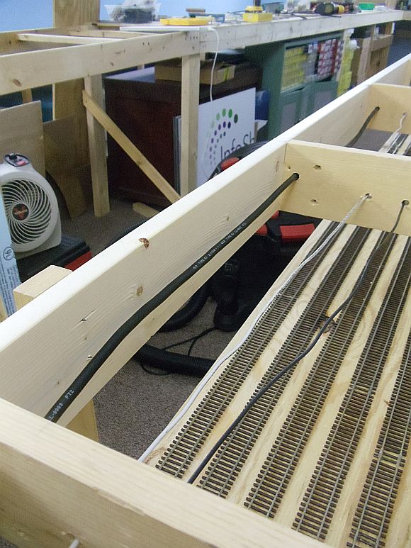

I decided I needed to add some lights under the second level for seeing the staging level. When I placed the second level plywood over the frame work, the staging level was very dark.

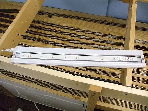

I got an 18" LED light from Home Depot for about $43.00 on sale. Regular price is around $53.00 per light.
I mounted it as shown below.

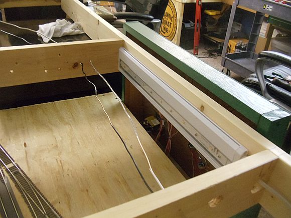

I wired a box to the backside of the 1x4 benchwork and extenede the wire to the end where I'll add another light and box for the south end of the staging area.
Here is how the staging area looks with the light on and the plywood deck on the second level in place.
