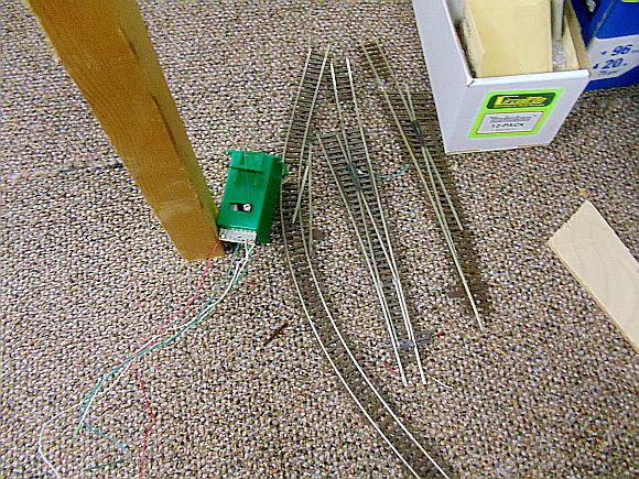

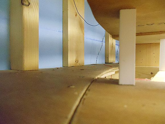

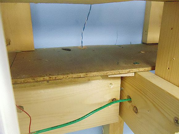

When I first started building the layout, specifically the ovalix, I thought I needed two reverse loops at the staging level. Well after the ovalix was under construction, I made the decision I didn't need the one on the south end.
However, only one problem. The space where the two turnouts were located is 3 1/4" high. I forgot to take a photo of the space with the track and turnouts in place but here it is after the track and turnouts were removed.
I wasn't concerned how I got the track out so I pretty much just cut the track and grabbed the pliers.
This is where the two turnouts were located. Oops, I see a piece of broken cut off disk.

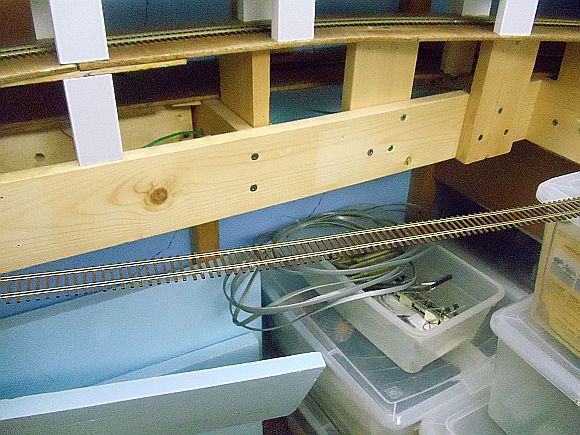

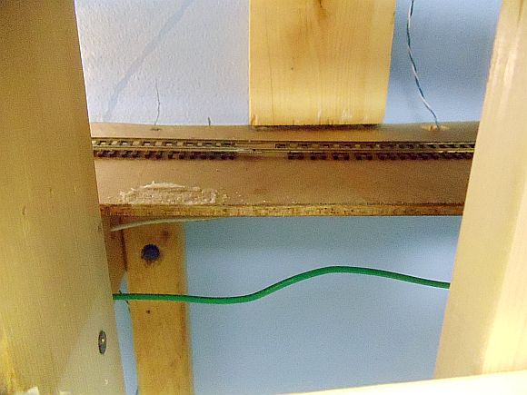

In the photo below, you can see I have a section of flex track ready to install in the area of the old track/turnouts. Notice in the photo the lower track on the ovalix?
Well, the new track needs to be installed just below that in the dark area in the back. Yea, I know, crazy stuff here.
After a couple of hours and many bad words spoken I "got ER done"!
I did this repair about a month ago and have experienced no problems with that section of track in the bowls of the ovalix.

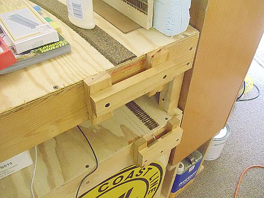

I've finished about 95% of the track work on the second level. I want to show you how I made the bridge track/lift out for the second level. This has worked out so much better than the one I did for the staging level. I'll redo the lower/staging level one later this summer.

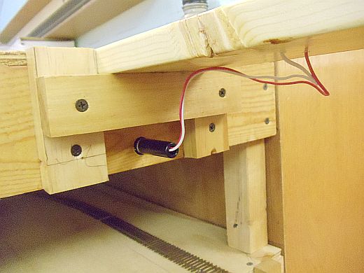

Greg DeMayo suggested I seal the bench work in this area of the bridge lift out with Polyurethane. I got a can from Ace Hardware. The polyurethane seals the wood and prevents the changing climate in the layout room from affecting the lift out.
I made the lift out in the same way I did for the first level. This time; however, I didn't use the brass strips for contacts.

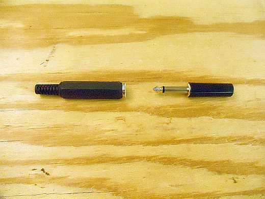

I got a two wire jack from Radio Shack.
I soldered two wires to the female end of the jack. I drilled a hole in the 1x4 a little smaller than the jack and pushed the jack into the wood hole.
I soldered two wires to the track on the lift out and the other ends of the wire to the jack. Now I just plug in the jack when the lift out is in place.

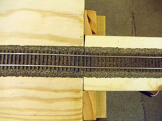

I attached the track to the lift out but this time I overlapped the gap on the lift out. I then used a fine bladed Zacto razor saw and cut the track at the gap between the layout and the lift out.
In the next photo you can see the thin profile of the saw.
And now you can see the very thin cut in the track.
This has been a much more effecient way to wire and install the lift out. The rails are very smooth and there are no bumps when the train crosses the lift out.
