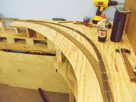

The new roadbed is 36.5" radius and the old track is 34" radius. Much much better. I have no idea why I thought I could live with the 34" radius on this curve.
Did I ever mention that level is good?

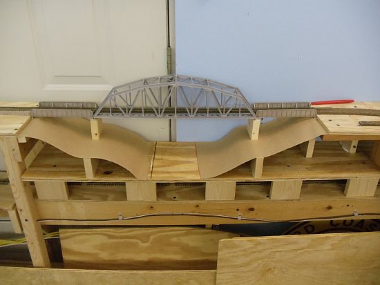

I cut the 1X4 block supports in half and added two for the road way.
I cut some contractor's paper the width of the basin span.

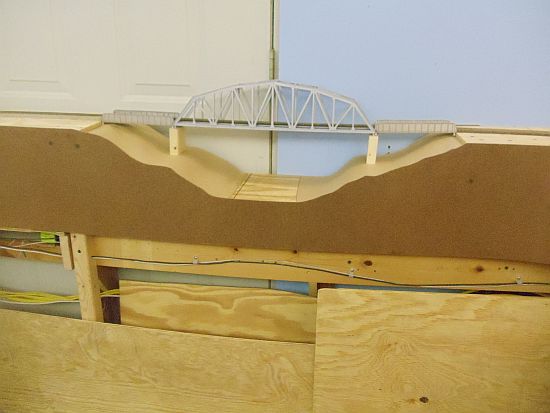

Okay, some fast forwarding here and the paper slope is in place and the bridge installed.

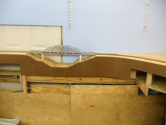

Time to make it look a little better.

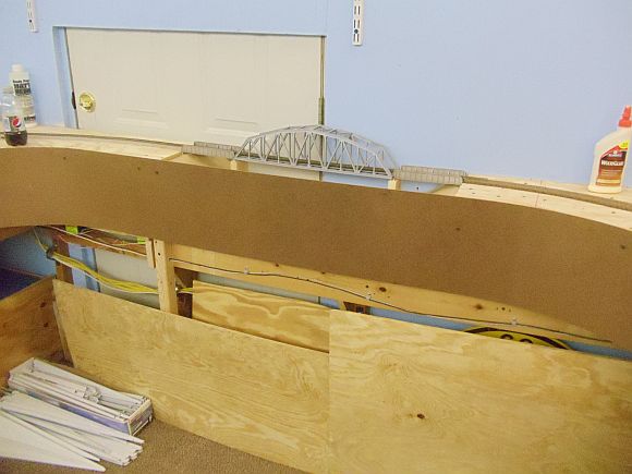

I screwed some Masonite/hardboard to the layout edge.
I used a Sharpie marker to mark the backside of the Masonite where the land fell. I used a saw to cut along the line and then screwed the Masonite back in place.

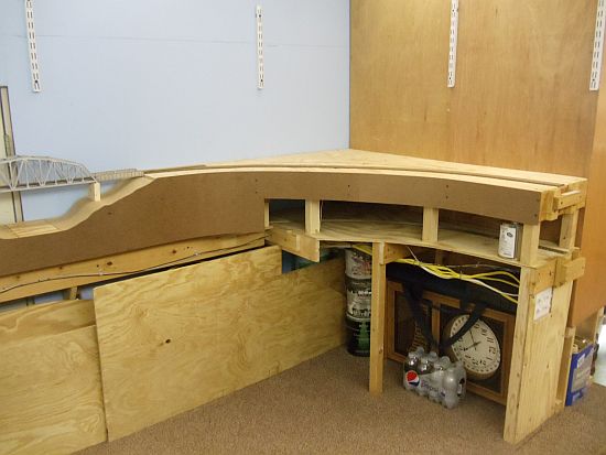

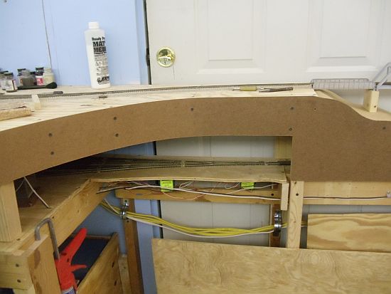

Here is how the finished panel/fascia looks. I cut a section off the bottom so I'd have access to the trains and track cleaning.
I cut a section out of the other too.
A good days work. I love this hobby!
