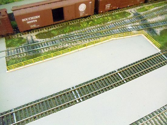

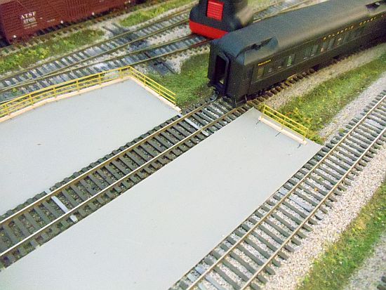

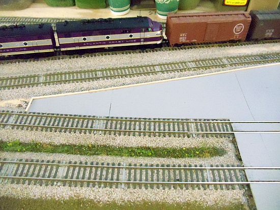

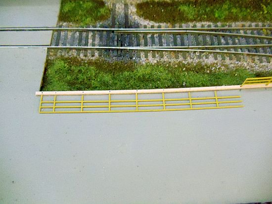

I got the base and the guard rail up and painted.
I used 6X6 pieces of strip wood and glued them to the outer edge of the station platform areas.
I used Central Valley railing. I spay painted the with Floquil UP Armour Yellow. I was going to use the Floquuil Reefer Yellow but the color was to bright for what I wanted.
I used the railing posts to mark on the 6X6's where I needed to drill the small post hole.
When I got all the post holes drilled in the stripwood, I inserted all the railing to make sure they were even or at least looked even. I then removed them and painted the 6X6's with Floquil Concrete. I then reinstalled the railing letting the wet paint be the "glue" to hold them. If I break any of the railing later in construction, I can easily break them out of the paint.

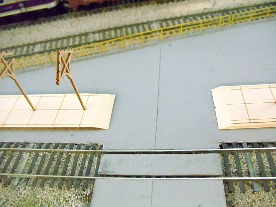

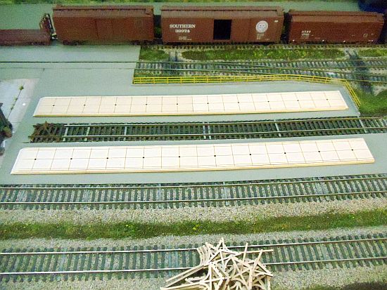

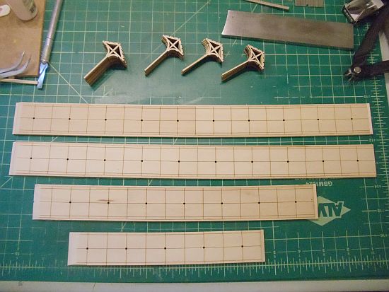

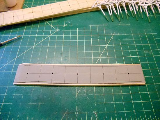

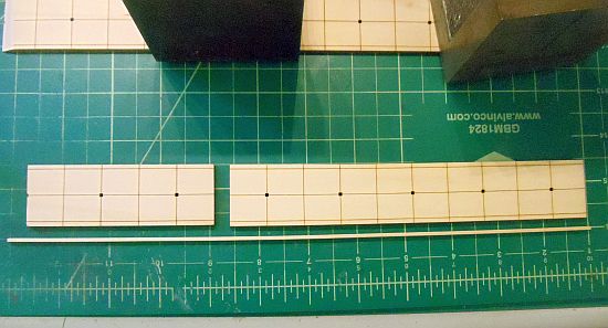

I also started work on the passenger platforms. In a couple of places I needed longer sections of base. I cut one for the extra length and then edge glued them together. While the glue was still wet, I then glued strips of 6X10's to the edge of the platform base.
Fast forward and the bases are finished.

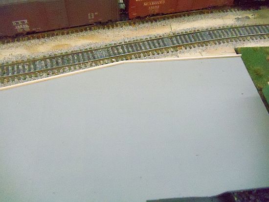

The two longer sections go on the right of the station and the two other ones go on the left.
I sanded the ends where the platforms span the road. I plan to have the roof extend the entire length of the left platforms and need the roof to keep the passengers dry or at least out of the elements.

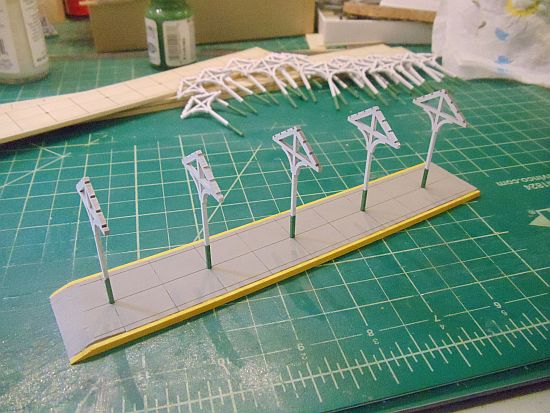

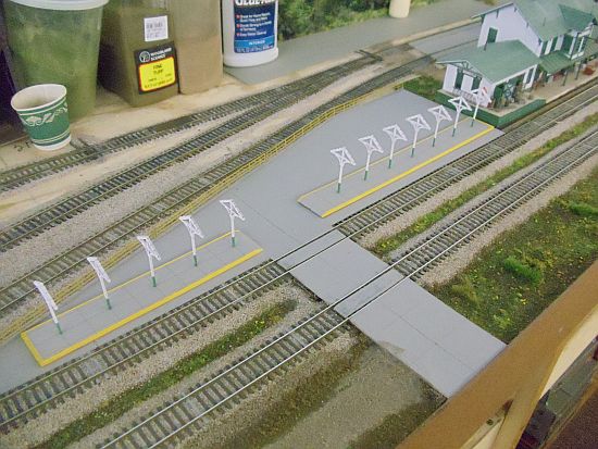

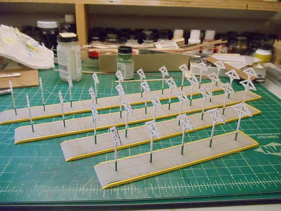

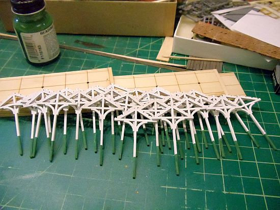

I finished the basic work on the passenger platforms over the past few days.
I got all the support post painted.
The platforms were painted with Floquil Concrete and the edges were painted with Floquil Reefer Yellow.

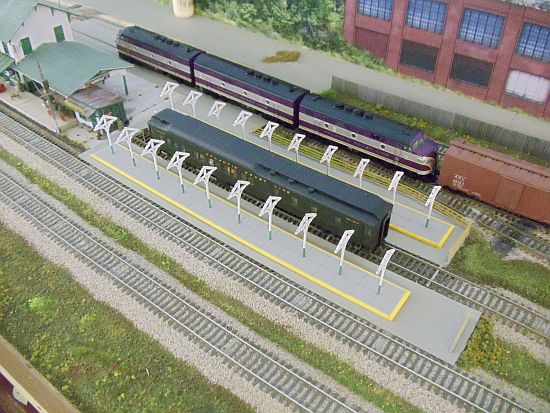

I think this area will be a great little scene when finished.

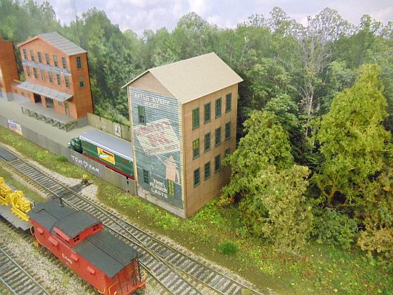

I also decided to add a short dirt road next to the track. I'll show what structure it leads to later in the thread. I have to cut in the road for the building to go up.
And, I finally got a roof on the Wrigley building. Hopefully in the next month I'll get it shingled.

Your station is coming along quite well.  I guess in Florida you need the covered platforms with all the rain you get.

Tom, your station is looking very nice and you´ve also done some nice progress on the layout with the roads and scenery.
Thanks for showing the pictures,
