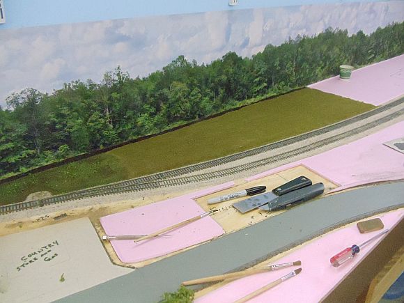

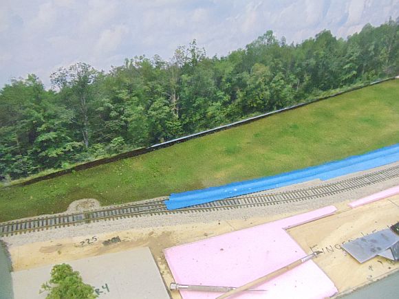

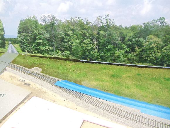

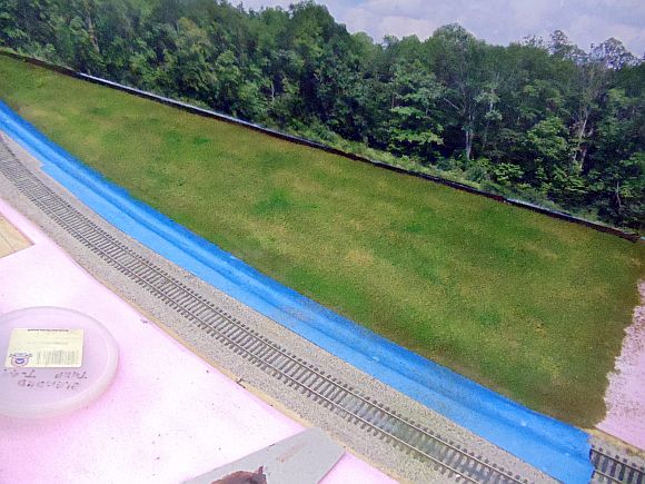

I started the scenery on the rural area of the layout. This area is about 4.5 feet in length. I painted white glue over the area and then covered the white glue with a 50/50 mix of Woodland Scenics Fine Turf. The mixture I used was Earth #T1342 and Burnt Grass # T1344.
I let the WS material soak into the glue for a few hours.
I then wet this area with matte medium. I then added several layers of scenic materials. I used both WS and SE scenery.

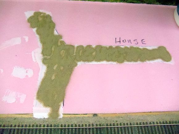

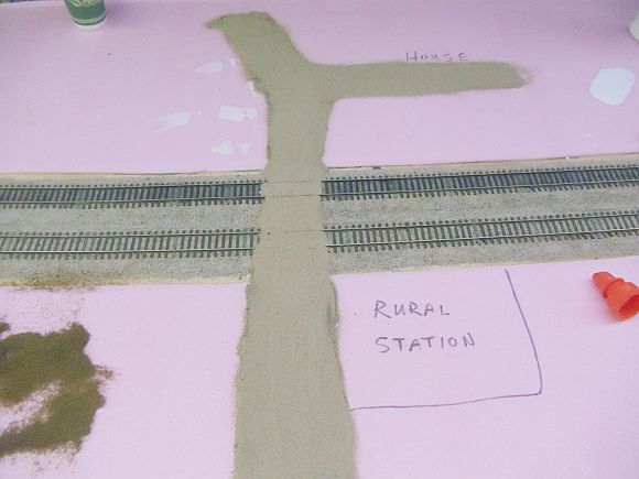

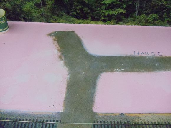

While that was drying, I moved to the dirt road. I previously marked off the road area. I painted white glue on the pink foam and then spread some sand for the road base.
This is a departure from my past dirt roads. I'm trying different mediums as I don't want the entire layout to be the same old dirt from Scenic Express.
I got this sand from a local playground. I sifted the sand to get out the large particles leaving me only the very fine sand. I baked the remaining sand in a cake pan in the oven at 250 degrees to kill any microscopic bugs or other stuff.
The sand was dumped on the white glue and then spread even over the top. I forgot to get a picture of the spreading.

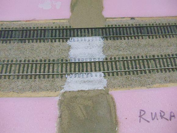

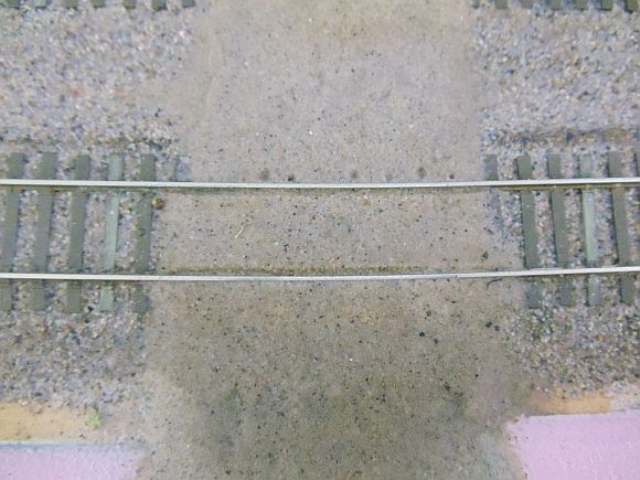

I then added some white glue to the track crossing area and then added the sand.
Continued after a Diet Pepsi break.

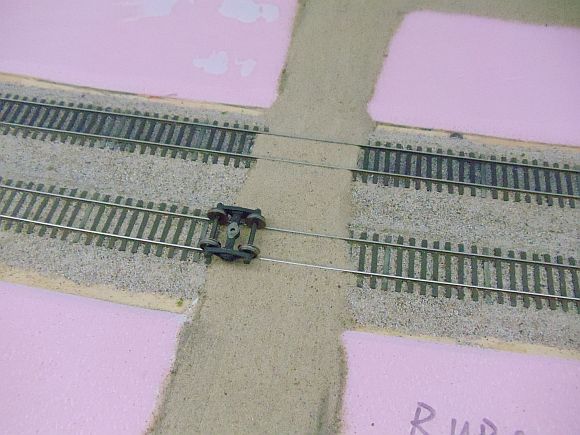

I used an old Kadee truck to push the sand from the inside rails.

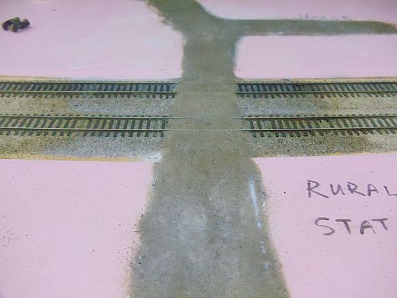

The entire dirt/sand road was saturated with matte medium.
After several hours of letting the matte medium dry, I used a punch point to compress the sand from the inside rails, meaning to clear a flange way for the wheels.
I'm going to add more sand, white sand, to the top of this road when the matte medium is thoroughly dry. This white sand will represent how the Florida rural areas look.
