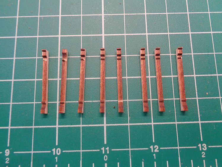

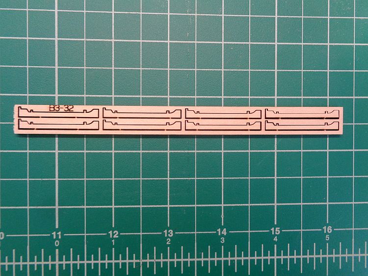

The building front has seven pillars.
I used a #17 Xacto to remove them from the carrier piece. The small tabs are delicate so take your time. I failed to do so and broke a couple.
From the photo below, looks like I broke four. The small white spots are missing a broken piece. These won't show after painting and will explain later.

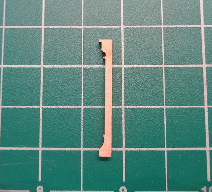

Here is a side view of one of the pillars. The top has a larger section than the bottom. Be sure you know the difference.

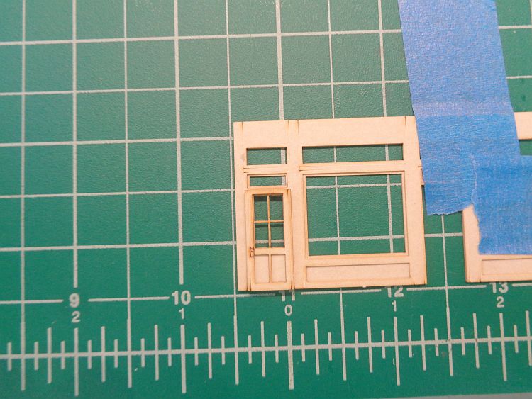

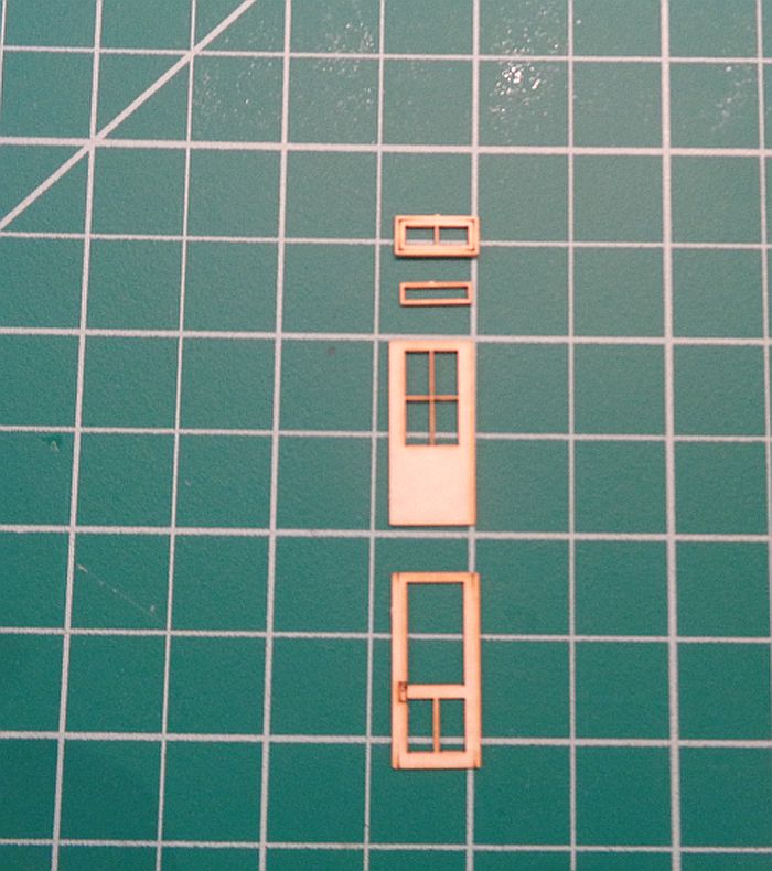

Here are the four pieces that go in the front. The two door pieces and above the door windows.
The two door pieces are "peel and stick" and one fits over the other as shown below.

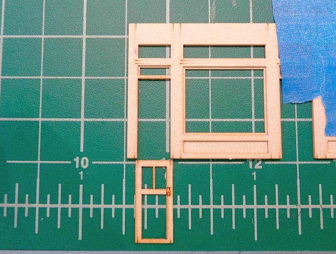

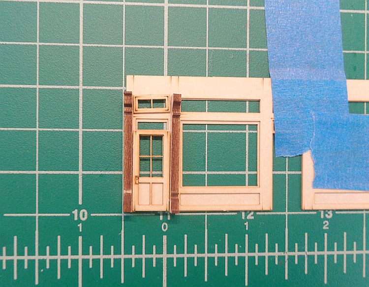

I studied the door and door opening and determined that you can cut off the sides of the top piece to make it fit flush. You can also make this a screen door.
If desired, you can remove the side where you see the small laser burn cut at the top of the door. I did experiment and it really doesn't look bad fit flush with the wall section.  Shown below.
NOTE: If you use a screen door, be very careful when removing the sides. I pulled the door apart at the door knob and will need to glue it back in place.

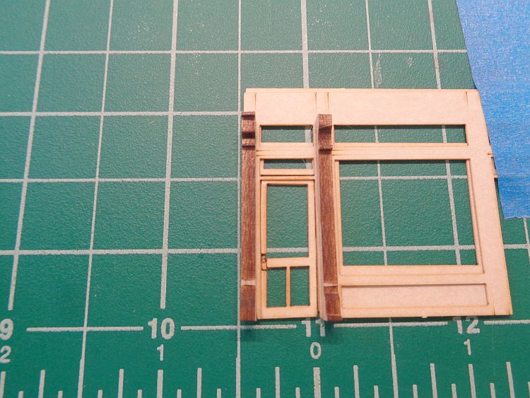

The small window piece fits here, at the top. Yes, it is crooked but not yet glued.

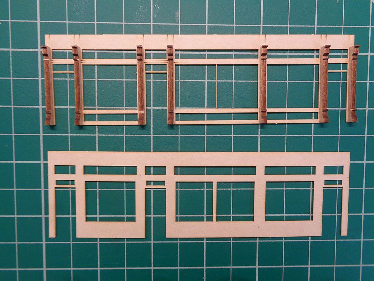

I glued the seven pillars to the front top wall piece and let dry over night. I used some long weights to hold them until the glue dried.
Here is a view of the top piece with pillars and the bottom piece.
NOTE: The seven pillars are glued at the bottom of the front wall and flush with the bottom.

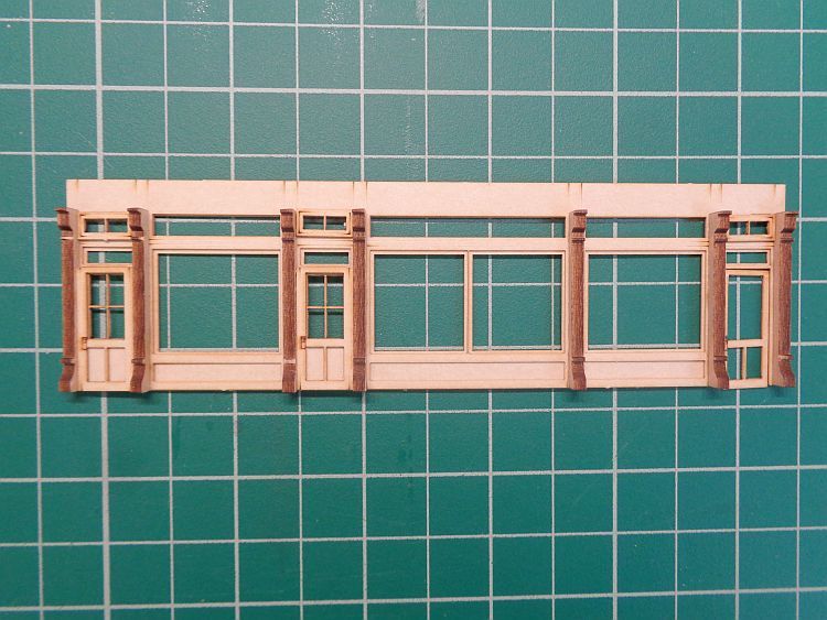

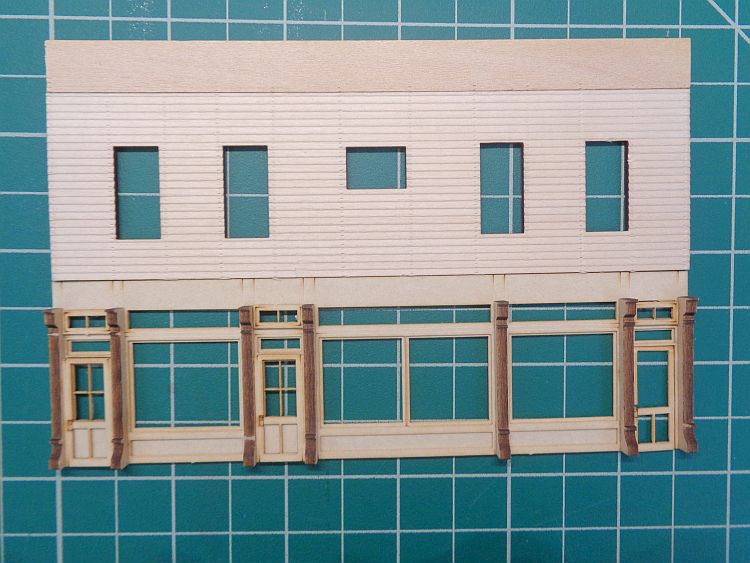

The next photo shows the top and bottom walls placed together. They are not glued at this time. I need to paint the two wall sections separately first.
And, here is the store front wall under the front top wall section.
