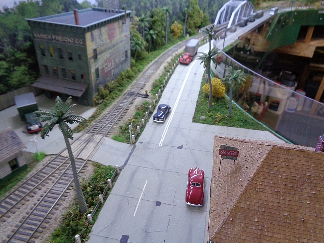

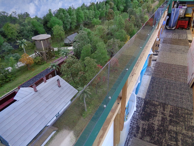

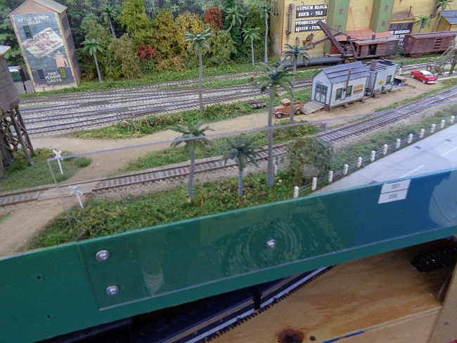

This afternoon I added the plexiglass to the fascia to protect newly added scenery.
It took me just about a week to do this 14 ft. section of scenery. I have another 24 ft. left to do on the this side.
I'll be doing that at a later date. I have another layout project I need to finish first. More on that as I get to it.
Done for today.

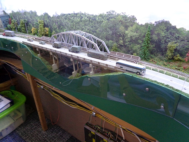

I really like that the Plexiglass tracks the ground line.  I would have just put it straight across the river valley.
Quote from: deemery on September 17, 2025, 05:48:32 PMI really like that the Plexiglass tracks the ground line.  I would have just put it straight across the river valley.
Thank you. I did consider what you mentioned and I almost did it. I started to cut the straight piece and backed off to measure and cut it to fit the riverbed.
jbvb
A club I was in used 1/8" acrylic to protect layout-edge scenery, but they only needed 6-8" height above the fascia.  Much more and you'd need either thicker acrylic or a structural support to protect the top edge from cracking when leaned on.  My layout has one protector at a corner, but I used 3/16" Lexan and welded its two corner joints with methylene chloride.
James
Quote from: jbvb on September 18, 2025, 10:22:09 AMA club I was in used 1/8" acrylic to protect layout-edge scenery, but they only needed 6-8" height above the fascia.  Much more and you'd need either thicker acrylic or a structural support to protect the top edge from cracking when leaned on.  My layout has one protector at a corner, but I used 3/16" Lexan and welded its two corner joints with methylene chloride.
James,
The plexiglass I'm using is 3/16" thick. I had a spare piece 16" in length and 3" wide. I pulled the two ends together and couldn't get it to break. Also, it returned to the original 16" in length with no sign of it being bent.
Lexan is a brand name for polycarbonate and what I'm using is essentially the same material.
I appreciate your comment, thanks for posting.

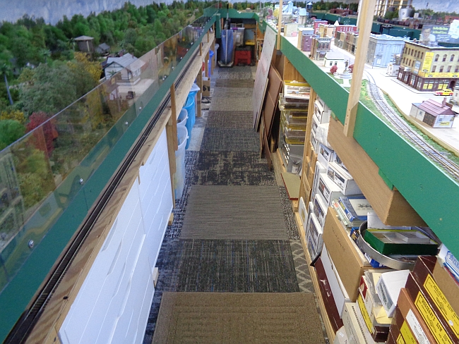

In his post above, James mentioned that the club he belonged to used the plexiglass on the layout fascia.
Honestly, I didn't want to go the route of using a protector against visitors. However, over the years I got tired of repairing broken items. I even asked visitors to not lean on the layout. In one ear and our the other as some say. So, I had no choice but to protect my work and layout.
This stuff isn't cheap. The Lexan polycarbonate plexiglass I use cost $106.00 for a single pane/sheet of 3 X 4'.
Due to my limited space, my east isle is only 28" wide and the west isle is 34" wide.
The photo below shows the east isle.
I used the plexiglass on the east fascia as my trees come to the layout edge. Even after I installed the plexiglass, I still find broken trees.
