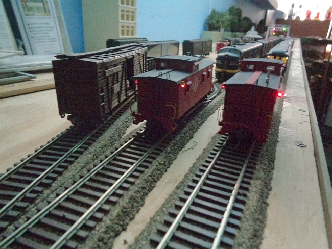

After the window glass was installed, I sprayed a light coat of Flat on the two cabooses. This dulled the glass to a cloudy look. I didn't install interior caboose lights and this will also prevent the marker wires from showing through the windows.
The light bring these two to life.
They are now on the caboose ready track.

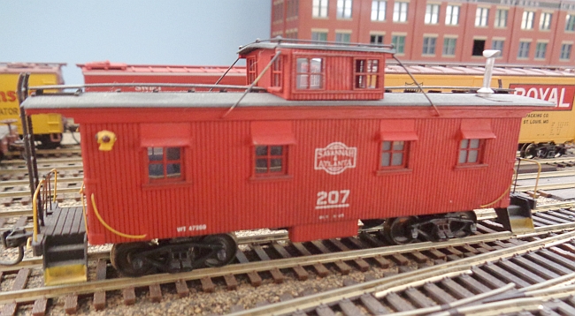

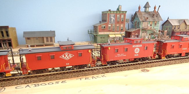

Installing Tomar marker lights aren't limited to brass models.
Here is a wood caboose I built and decaled for the Savannah & Atlanta. The S&A caboose is an American Models Builders kit.
I also installed markers in a plastic East Coast Railroads caboose kit.

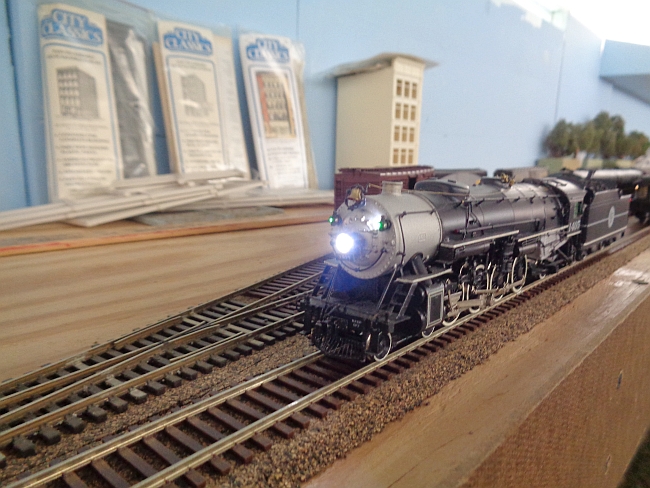

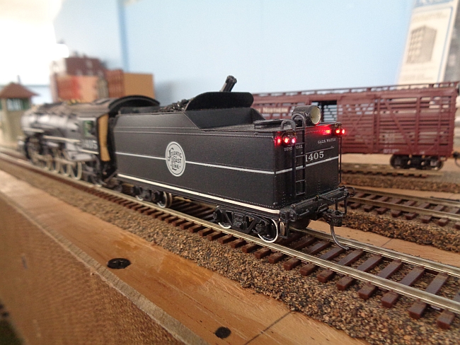

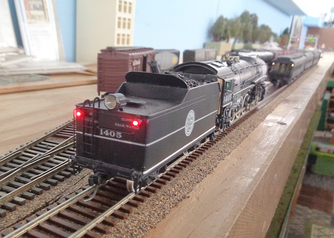

I also installed Tomar markers on a brass loco. The loco is a Key Import USRA Mountain, 4-8-2. I painted this many many years ago.
While I was at it, I removed the brass Cal-Scale smoke box markers and added Tomar markers.
The light shinning on the front of the smoke box is due to the white marker lens falling out. I'll need to fix this but you can see the Tomar markers can be used on many different models.
