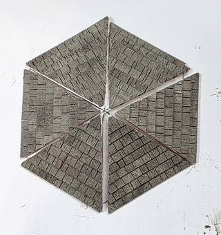

Howdy folks,
Dave, thanks for the comment.
The segments are finished and ready to be assembled.  Here is a photo with the segments resting on a printed paper template.
Just wow! I want to share the way I did a roof similar. I place scale 1x2 or 1x3 so it didn't need capped at each seam. Lower roof is the same. I cut it out with a steel nail file I stole from Gena. Basically a dado cut. Added some old watch parts as the finial.
Mike nice roof and looks quite fidly to build.
Mike, outstanding job on staining those shingles.
I don't think you shared how you did it.
Mike excellent work on that roof.
Quote from: Philip on May 27, 2025, 02:27:12 PMJust wow! I want to share the way I did a roof similar. I place scale 1x2 or 1x3 so it didn't need capped at each seam. Lower roof is the same. I cut it out with a steel nail file I stole from Gena. Basically a dado cut. Added some old watch parts as the finial.
Howdy Philip, thanks for the comment.  Your technique is what I used, and the roof looks similar.  Your tower looks fantastic.  It's a beautiful model.  Have fun, mike
Quote from: Larry C on May 27, 2025, 02:39:37 PMMike nice roof and looks quite fidly to build.
Howdy Larry, believe me, it was fiddly...real fiddly.  I used plastic as the underlayment so it would be easy to glue the wedges together.  I don't have good luck with superglue, maybe it's old. Thanks for the comment.  Have fun, mike
#389
Quote from: Rick on May 27, 2025, 06:54:22 PMMike, outstanding job on staining those shingles.
Howdy Rick, thank you for your kind words.  I brushed a coat of a dark weathered grey stain on raw cedar shingles.  I followed up with a light barnwood stain from Dr Ben's applied with a sponge.  Finally, I sprayed this with an A/I mixture from an old hairspray bottle.  Nothing fancy.  I try different techniques on every roof I build.  Have fun, mike
