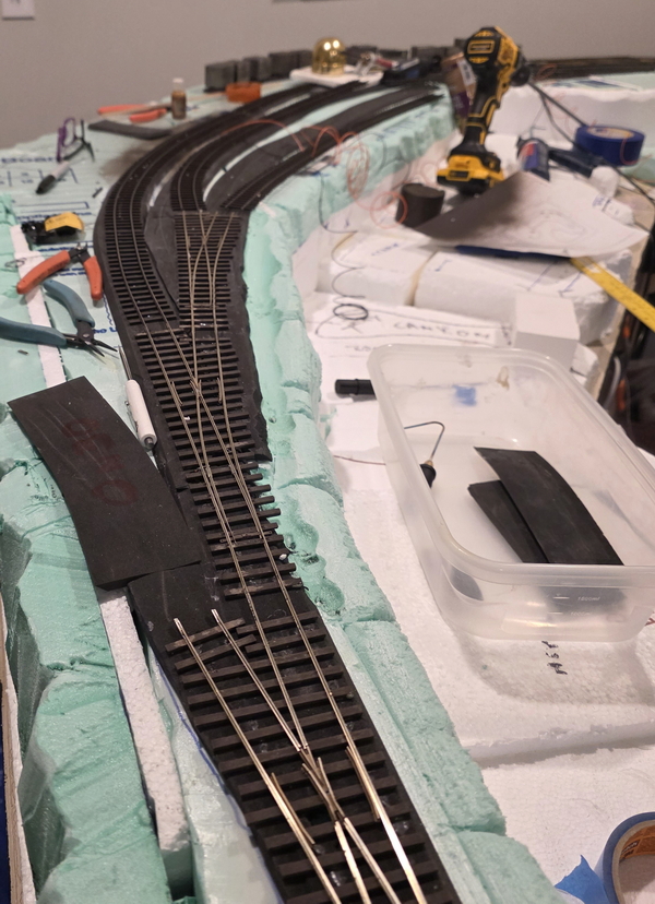

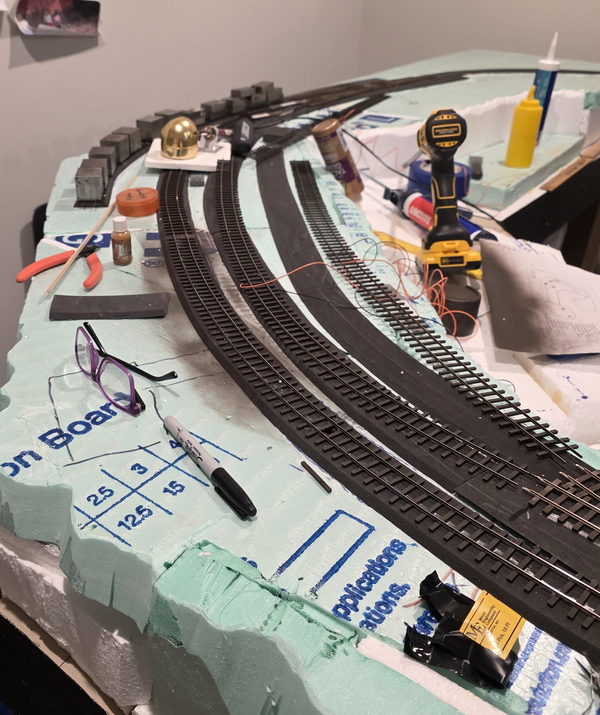

Track laying has been the main project on the Buffalo Canyon layout. It isn't going as quickly as I'd like, but I am trying to avoid mistakes.  The process is paint the track, clean the top of the rails, solder the leads, drill the hole for the leads, cut the rails to the correct length, solder rail joiners to the new rail (I use N scale joiners), feed the leads into the hole, apply adhesive to the road bed, pull the leads through, connect and solder the new rail to the old rail, bend rail to fine tune its position, apply rail to roadbed, add weights, rinse and repeat.  It's fun, but slow.  Here are a couple of photos of progress:

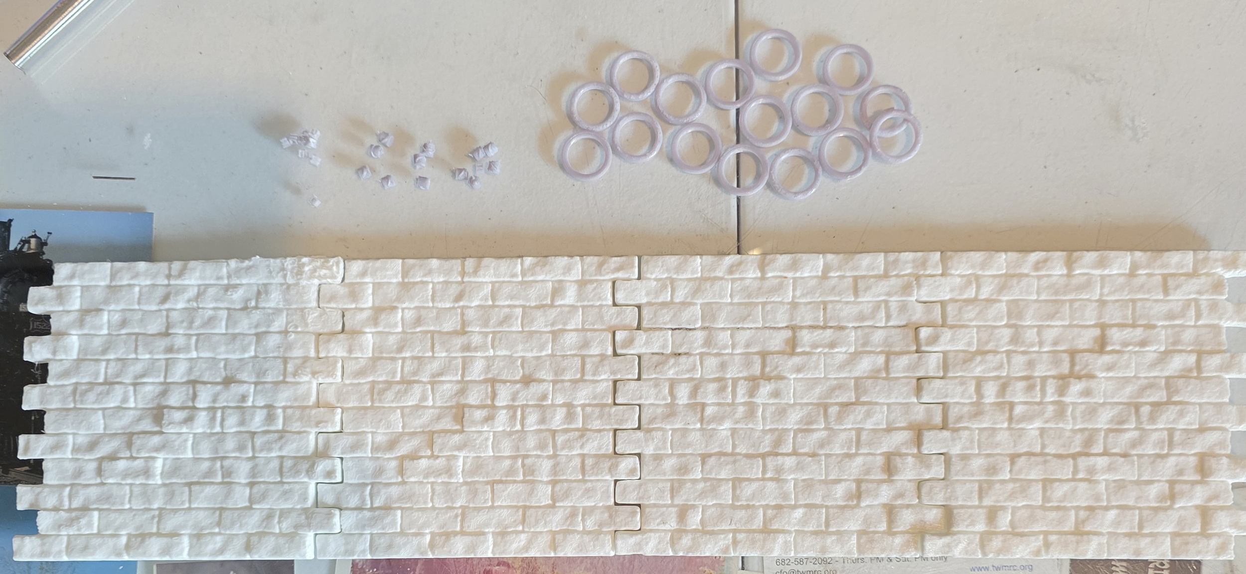

Jerry asked about 3D printed details, so here are a couple of photos of the prints.
The first depicts the stone walls for the sheriff's office and jail, Model T tires, oil cans, and stake pockets.

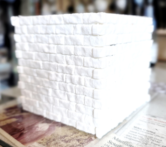

The walls interlock and are in four-inch sections.  Here is a photo of the interlock effect when assembled.
I got a new phone and haven't mastered the photo settings for F stops and exposure.  Apologies for the photo.  Working on it.  If you look on the right side, you will see a black mark.  That is the height of the office.  I'll probably mimic the Sheriff's Office and Jail produced by Stoney Creek Designs.  I wish it were still available.
My current build is the Layout scenery and miscellaneous rolling stock .
Mike, walls look great.
I think you might have been holding your phone too close to the subject.
Back up some and zoom a little if you must.
Also, if you hold the phone that close it might have a macro setting.
