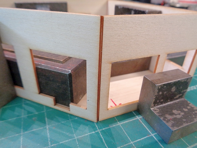

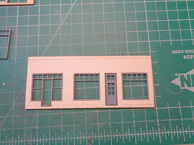

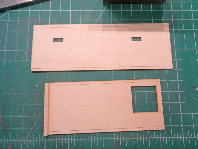

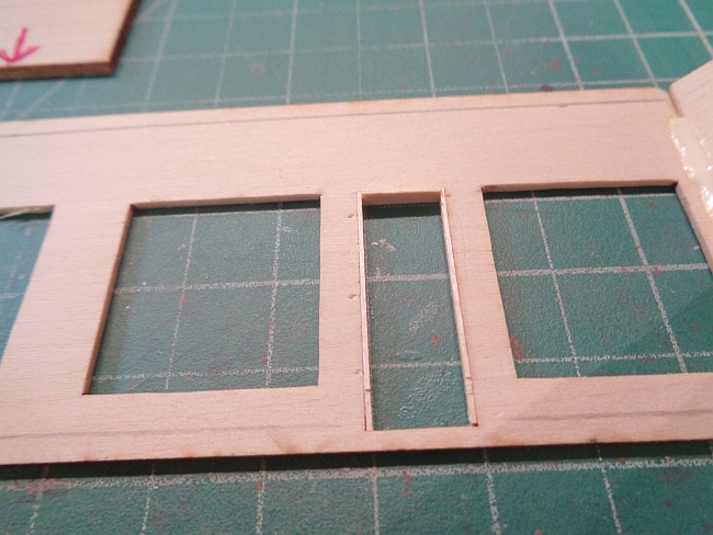

Prior to gluing any walls together, I made test fits of all the windows that go with the main service station.

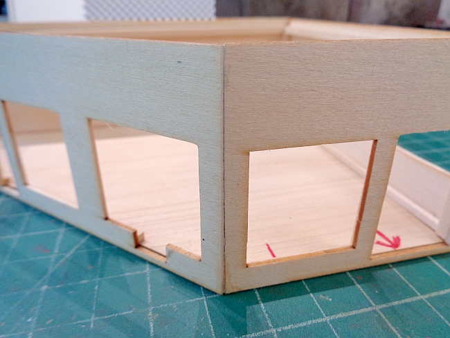

The large front wall, nothing fit. Referring to the photo below, all three window openings needed a little sanding for the plastic windows to fit. Mainly the sanding was on the bottom of the three openings. I could force them in but plastic window side frames buckled. The door opening was the opposite as it was to large.
I needed to shim the sides and top for the door to fit properly.
All the other windows and doors fit.
I used weights to hold the wall pieces in place to complete the test fitting.

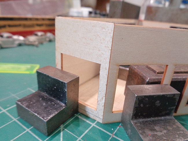

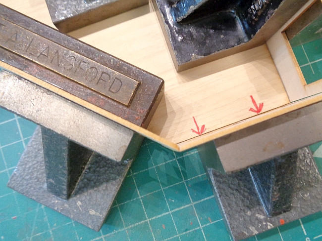

This gap will disappear when the wall edges are sanded at a 45 degree angle.
You can see in the next photo how the wall sections fit after sanding.

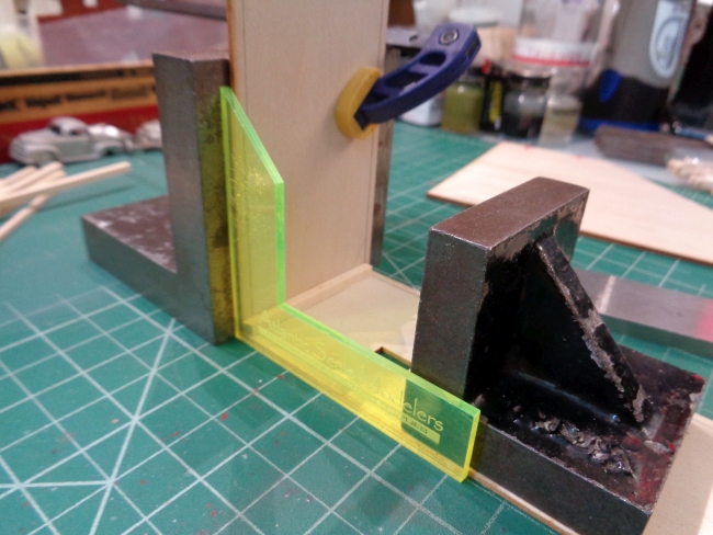

I decided to glue the walls together as one sub assembly. I didn't want to glue the walls to the base one at a time.
Not yet making the decision to add stucco or just paint the walls, I wanted the option to add stucco and not chance getting stucco splattered on the checkerboard floor.

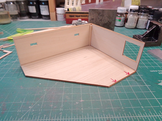

The lines at the top and bottom of the walls are for the bracing.

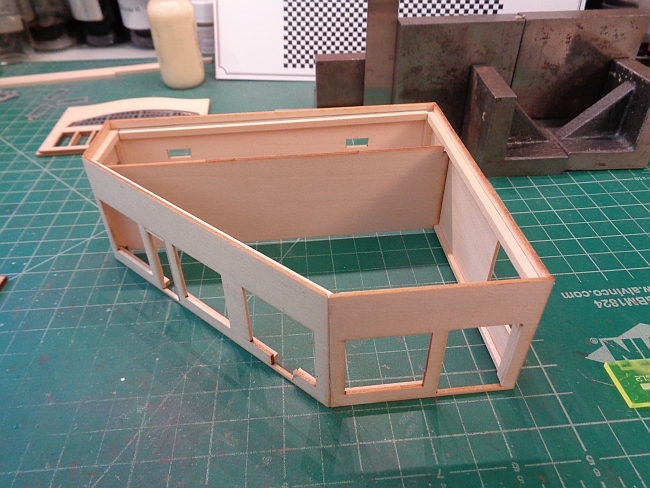

I started by gluing the rear and right side walls together.

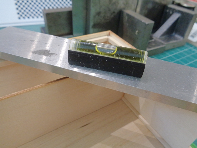

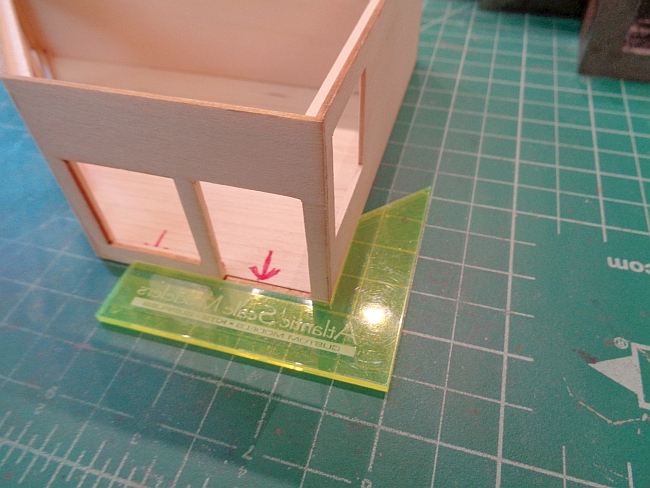

After each of the wall sections were glued together, I made a test fit to make sure they all fit properly and tight to the base.
As I added each wall to each other, I made sure the corners were square and at a 90 degree angle.

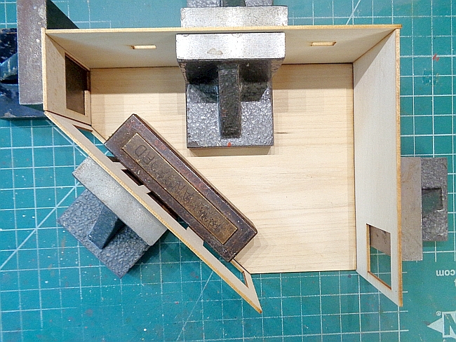

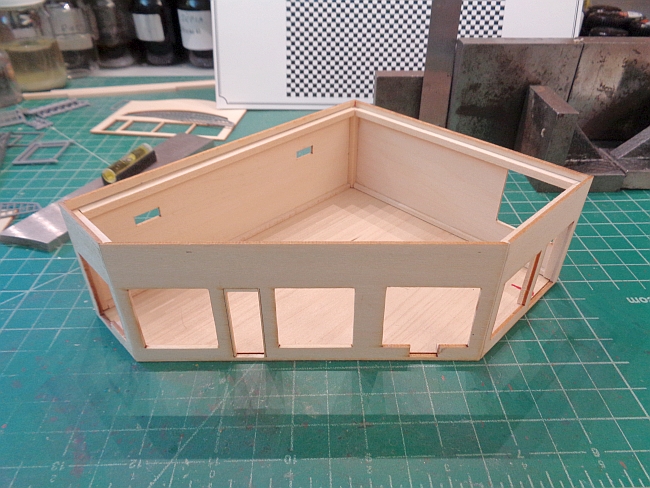

All five walls are glued together and separate from the base.
The wall sections that meet at 45 degrees are both nice and tight.
