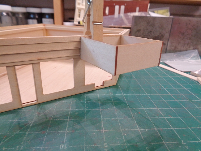

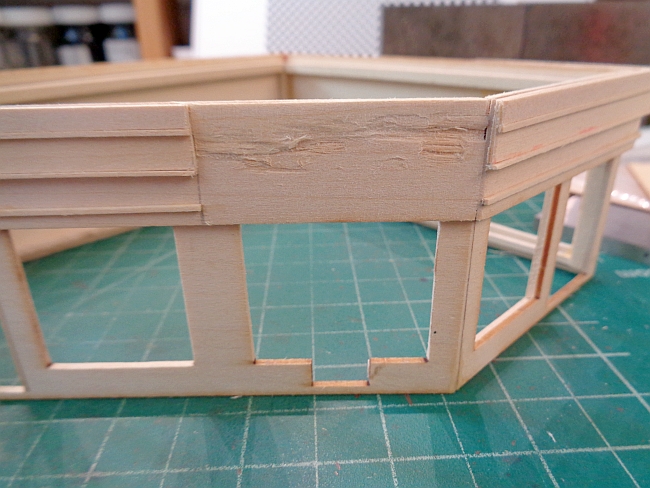

I was adding the upper detail trim to the service station. I got so engrossed in the trim that I forgot that a portion across the front was to be left off. This was to allow the canopy roof to be added.
The below photo shows when I had to remove a glued wood portion to the front. I was very careful but still cut into the upper portion of the wall.
Thankfully, this won't show as it is covered by the canopy wall as shown below.
This mistake was easily fixed.  :-[

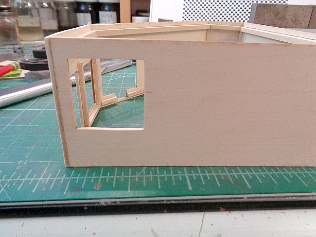

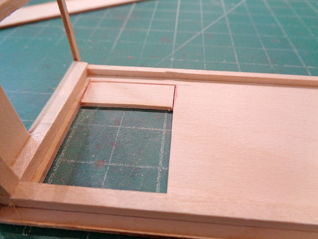

This next mistake was not as easily fixed. Refer to the photo below.
Looks normal as the window opening does goes on the left.
However, I glued the wall to the other two walls. This wall and window opening is upside down. The window is to sit lower in the opening.
Back in a few, I definitely need a Diet Pepsi to explain this one.  8)
I never considered trying to remove the wall and then re-glue it to the other two walls. I could see disaster all over that attempt.

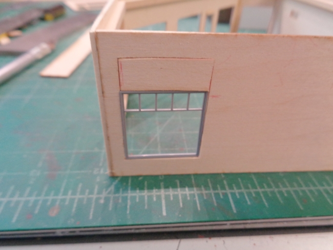

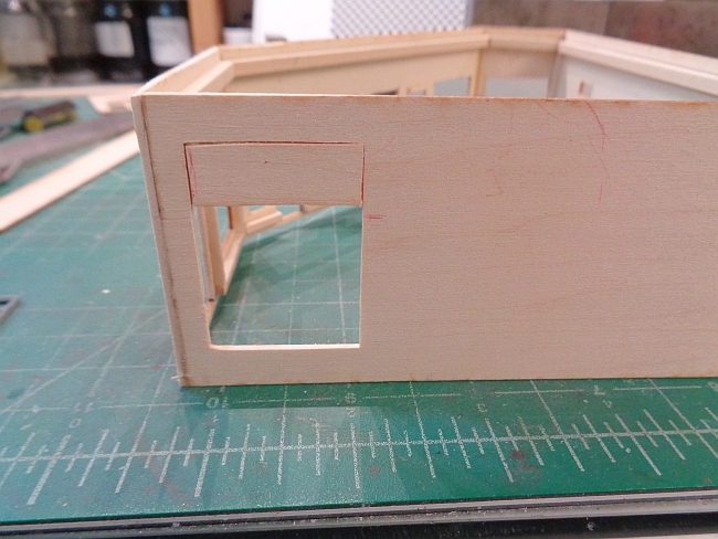

So, I measured, thrice, where the window is to set in the wall and how low. I then marked this on the lower inside of the wall as shown below.
I took the cut out wall piece and glued it to the top of the opening.
The window now is in the correct location on the wall.

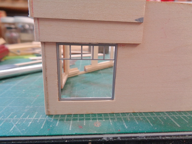

The trim board covers the new glued in wall piece.

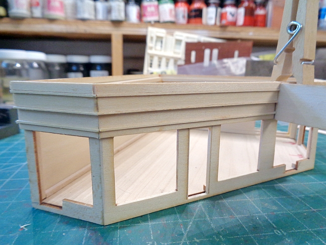

Here is how the trim looks on the upper portion of the building.
Trim will be added to the canopy sides that will match the other trim.

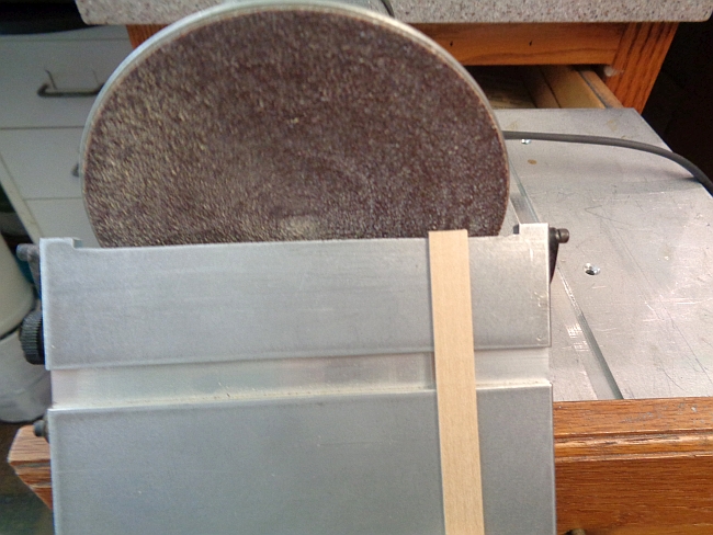

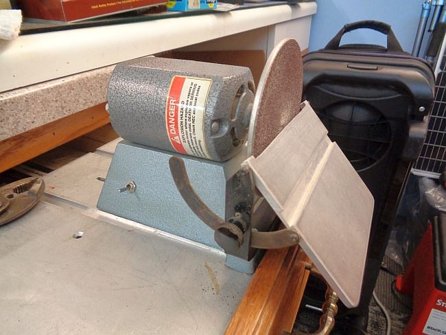

A side note on sanding the trim pieces at 45 degrees. I was using a sanding stick and eye-balling the angle. Test fit, sand, test fit, sand and so on.
After the first couple of angles. I pulled out my little Micro Mark sander.
I set the table at 45 degrees and used this to sand the rest of the trim pieces. It was much easier than the eye-balling.
