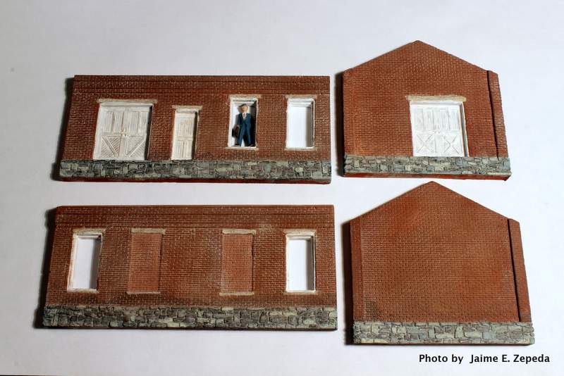

These are the four urethane castings that make up the picking house. Note how the doors are already cast in place, nice.
First step is to prime the urethane castings with a brick red color. I used Red Primer from a cheap Walmart spray can (which I can no longer get at my local Walmart). The instructions suggest a red auto primer.
Touch up the bricks using a brick acrylic color like Georgia Clay mixed with a tiny bit of Charcoal. I used Terra Cotta  acrylic paint from Craft Smart which I bought at Michaels. The lintels, sills and headers are painted with Sandstone from Apple Barrel (I used that). The stones are painted with different shades of grey acrylic paint.
Notice I painted the bricked-in windows with a different shade of the Terra Cotta.

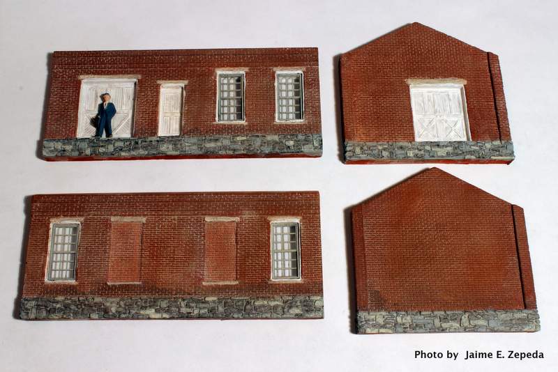

Next is an India ink wash on the stones followed by a white wash to simulate mortar lines. The brick mortar lines are simulated with grey pastel chalks. To mix it up a bit one uses some earth-colored pastel chalks to highlight some of the bricks.
Notice I painted the cast-in-place doors with a diluted white acrylic paint.
I glued in the windows which fit perfectly. It is quite a treat to have all the windows fit just right in the wood walls and the urethane walls. I did not have to sand anything to make the windows fit. Kudos to South River.
I fine tuned some of the brick by doing another white wash followed by more earth-colored chalks.

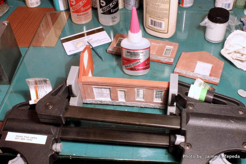

I used CA glue to glue the walls together. The instructions suggest clamping the walls for a tight fit. Try that with Hydrocal castings.
Notice that the walls bent in just a tad when clamped while the CA glue set. The instructions make a note of this and caution the modeler not to overdo it or else the urethane castings will break.
Once I had all the walls glued together I added a stripwood brace at each corner. I glued these in with 5 minute epoxy. This is not in the instructions but I wanted to have some peace of mind that my walls were going to stay put.
The castings are so well made that if the glue joints are real tight it is not necessary to fill in cracks and voids. I did  not need to fill in any cracks or voids. I merely blended the joints with more of the grey chalk used for the mortar lines.

Looking good. Nice job and photos. Maybe a couple of ⅛" square cross braces between the side walls, one at the top and the other at the bottom, would prevent the walls from bowing when clamped.
