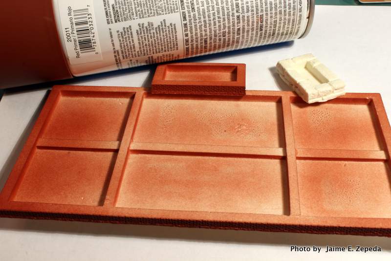

But, before I do that I need to get the building's foundation in place.
The kit includes a resin casting for the brick and stone foundation. It is a nice casting. I painted mine with red primer from a spray can.
Above I've placed an unpainted resin casting from the kit to show the difference between the painted foundation and an unpainted casting.
I glued all the walls together.
Next I painted the rock portion of the foundation with grey acrylic paint. I used grey pastel chalk to simulate the mortar for the brick portion of the foundation casting.
