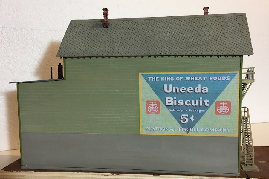

That big blank back wall just screamed for a large painted sign.  Uneeda Biscuit signs seemed to have been everywhere so that was my choice.
I used my regular printed sign method.  For a large sign it is important to pull the layers apart carefully around all of the edges before moving to the middle or unfortunate results can occur (I tore a couple of large sign prints to learn this lesson).
Once the paper is split all the way around the middle separates easily.
The sign was applied with thinned canopy glue and a stiff brush was used to work it into the wall's texture.

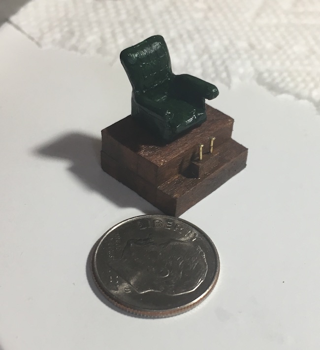

I needed a shoe shine bench for the space next to the newsstand.
I built up a platform from stripwood and attached a casting of an old leather chair.  I'm sure the owner found this chair tossed out by the road by someone who failed to see its value.
The foot rests were made from another small block of stripwood and two tiny brass brads.  I filed the heads of the brads to make a narrow angled surface.

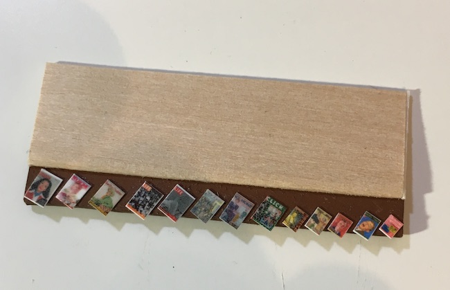

The newsstand suffered from too much open space above the counter so I made an upper frame from which I hung more magazines.  The initial board did not extend low enough so I had to add and extension (not yet painted in this picture).

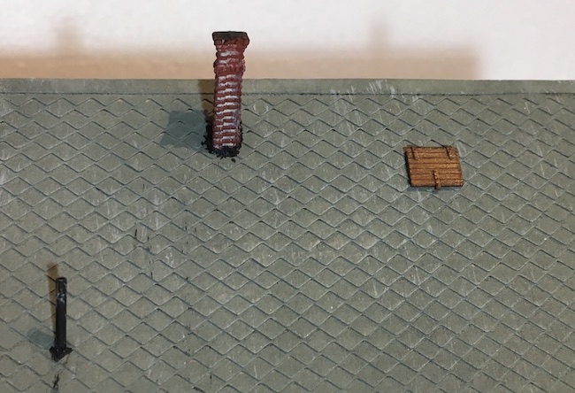

For the roof hatch I went to my scrap box and found the hatch from an ice reefer.
I went into my bins of cutoffs and found small "sticks" to prop up the open windows.

Moving to the back wall we have the large advertising sign.  This wall is intended to face the tracks, thus the lack of windows. (No rail-fan special rooms here.)  The owner would probably love to sell some more ad space.

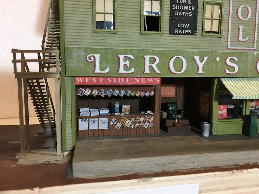

And now we move to the front.  I added a few details on the sidewalk and a gentleman working the newsstand.  I also treated the awnings to an ink wash to take the newness away and  add a touch of wrinkle.
Finally a closeup view of the newsstand and shoeshine stand.
