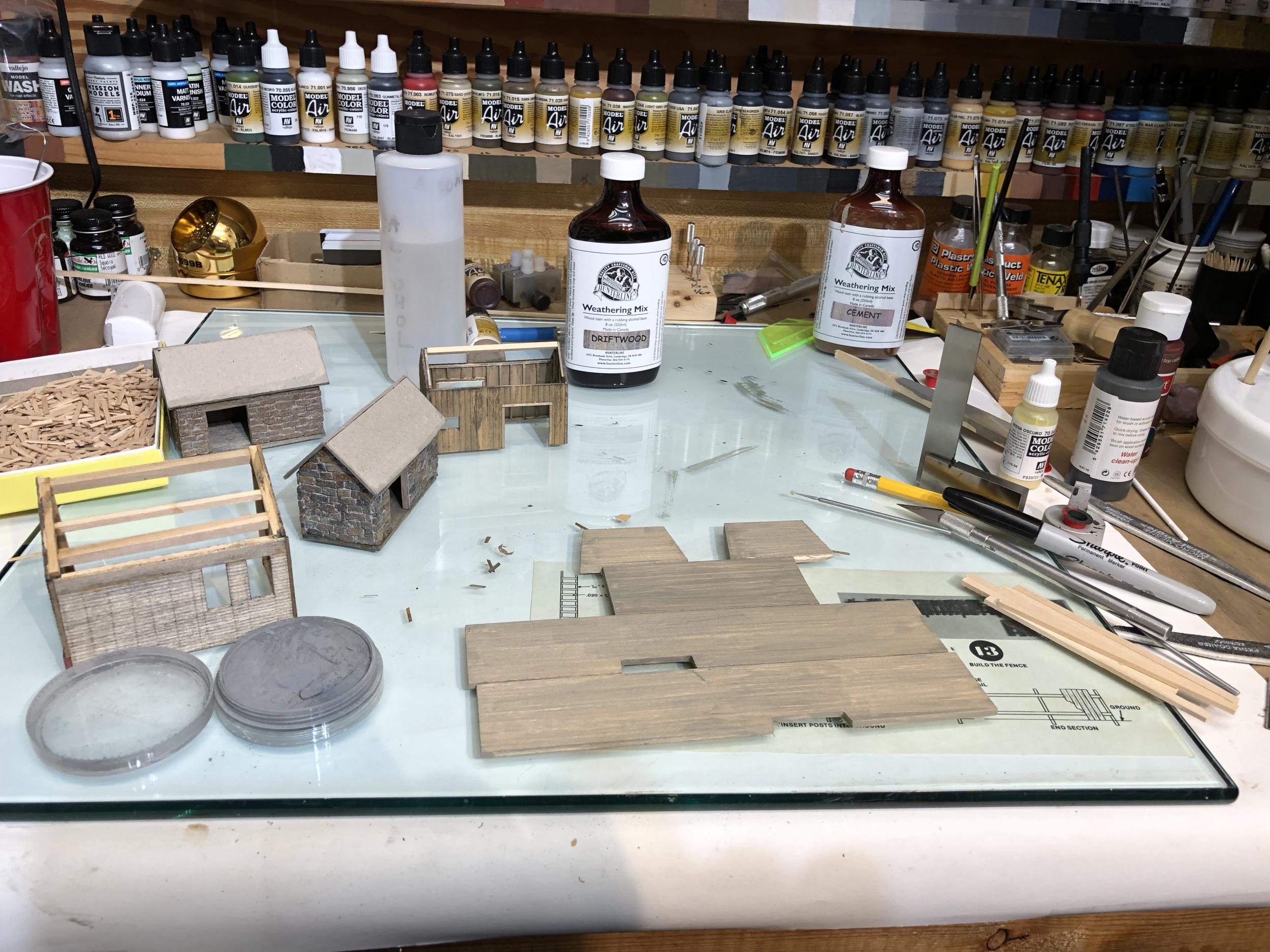

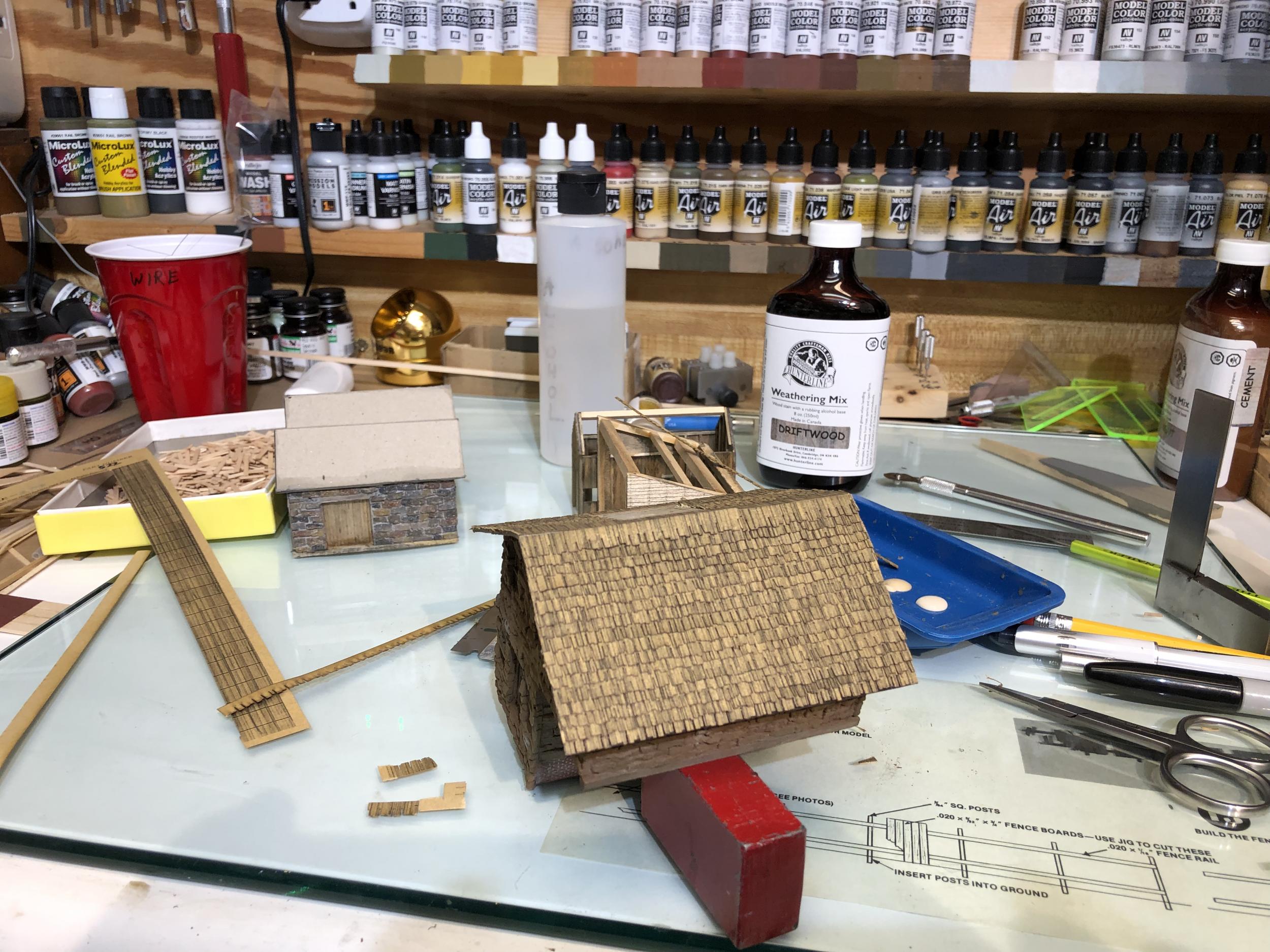

Today, I made some more progress on this build.  The buildings B and C got a coat of Hunterline Driftwood.

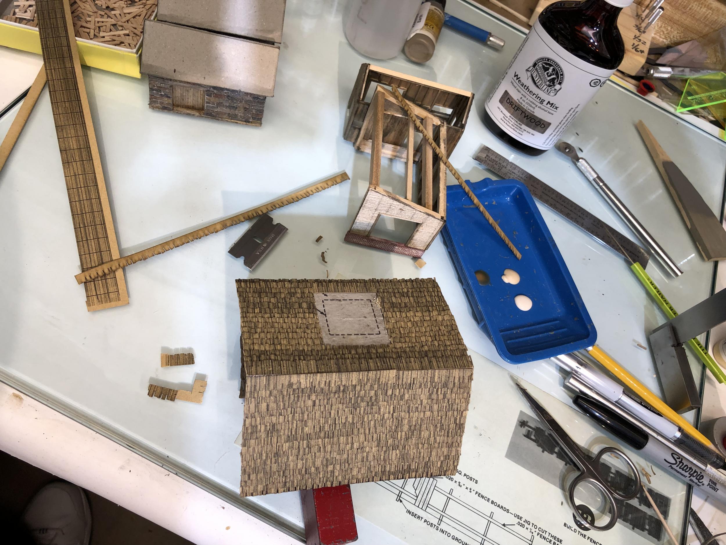

I also added the shingles to the main A building. There is a lot of detail to add to this roof.

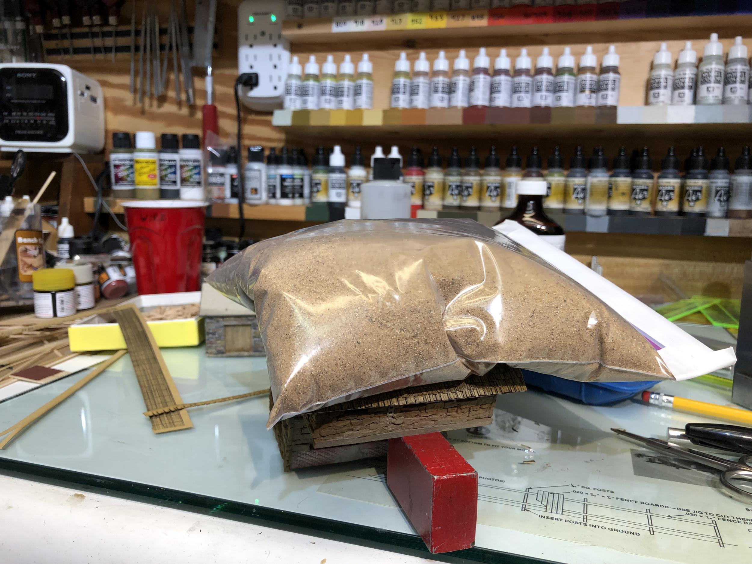

I used Jan's sand bag to hold the shingles down while the glue dried.

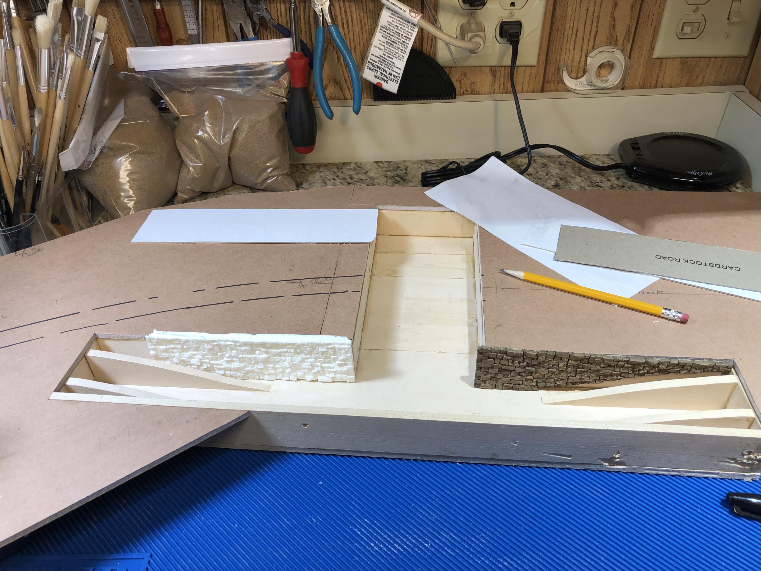

As soon a I get the rafter ends installed (not my favorite part of the build) on the main building,  it will be time to start gluing the structures to the baseboard. I spent some time getting the baseboard read, including finding a wall casting for the other side of the pit area.  I will need to do some cutting but I found one in my castings box that will match the one supplied by George with the Fox Run kit. I just have to cut it to size and paint it the same way I did for the Fox Run Casting. The part that I have to cut off to get the right height will work to extend it the length of the pit. It headed for the ban saw.

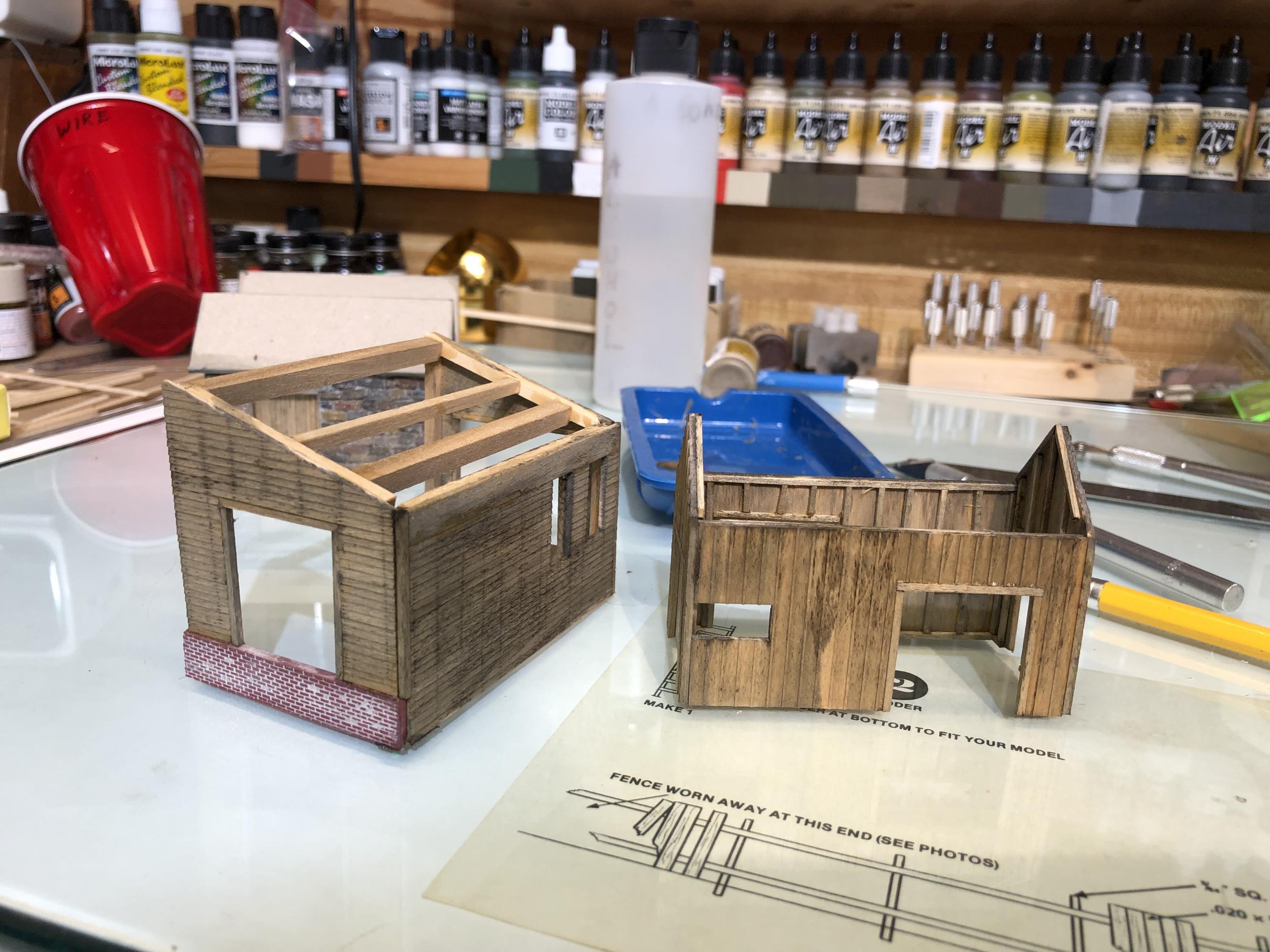

On the building with the bricks low:  Shouldn't the wood overhang, the bricks, rather than the bricks sticking out below the wood?
Quote from: deemery on February 11, 2019, 08:31:00 PM
Dave
The short answer is yes for proper drainage - but the dozen or so builds that I have in my library off the internet and from layout visits built it like I did.  The stack-up of the walls would require some trimming to the walls to make this happen.
Dave
Thanks for pointing it out - I'm not going to change it because  it will never be seen on the layout.  It will be on the back side of the building under the loading dock.

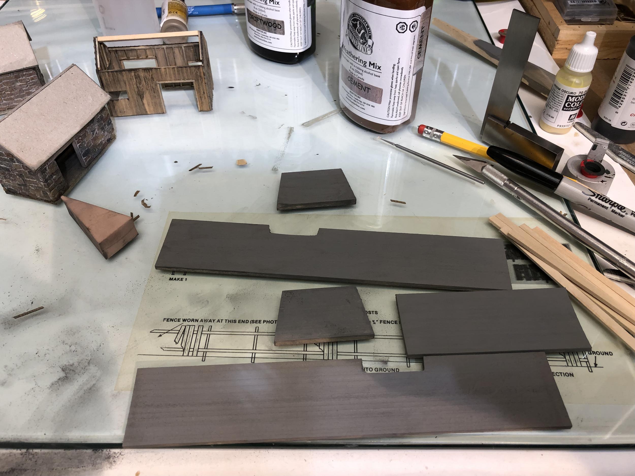

The base pieces have been test fitted and are ready for painting.
I painted the cement walls with Hunterline Cement colored stain.
After two coats of the stain, I liked the color, but I just wasn't getting the coverage I wanted.  So, I added grey pan pastel chalk, my old standard for cement, for the final coat.
