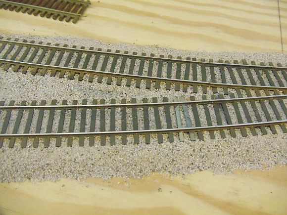

All the track on the second level is now painted. The rails were painted with Floquil Rail Brown and the ties were painted with Floquil Railroad Tie Brown. I follow Greoge Sellios' way of weatheing the track. When the railroad tie brown is still wet, I paint a few ties at random to simulate older weathered ties. You can see this in the photo below.
In the past I used Woodland Scenics ballast. WS ballast is some sort of crushed walnut shells or something like that.
For this layout I'm using Arizona Rock & Mineral Co. ballast. It's crush granite, rock or something better than walnuts shells. The ballast is about 50 complete finished. I'm using #138-2 ballast which is the CSX, SP and Wabash ballast. I also have several bags for the HO scale #105-2 Pennsylvania ballast. To be honest, I can't tell the difference between the two.

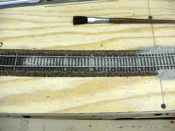

I pour the ballast into a small Dixie Cup, pinch one side to form a small pouring spout. I use the spout to help control the flow of the ballast to the track. Once on the track I use a 1/4" soft bristle brush to move or spread the ballast.
When the ballast is in place, I use "wet" water and mist it on the ballast. My wet water is one pint of regular tap water and 5 drops of Kodak Photo-Flo 200. I then use a plastic pipette to glue the ballast in place. For the glue I use the  Ready Mix Matte Medium from Scenic Express.

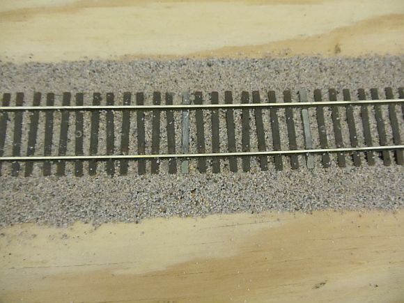

After the matte medium in dry, you'll notice little pieces of ballast on the ties as shown in the photo below.
I use my forefinger and lightly rub the inside of the rails and the tops of the ties to remove the pieces of ballast. The photo below shows the track after I rubbed the ties.

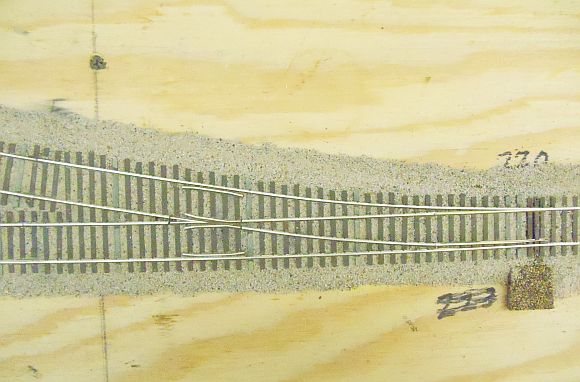

Again following George's method of track weathering, I apply rust to the outside of the rails and A&I to the inside of the rails.
For the rust, I use Floquil Rust in a 10-1 mixture of rust paint and thinner. Ten parts thinner to one part of rust.
For the insides, I use Hunterline's Weathering Mix. The mix I use is Creosote Black.
The next photo is just an extra one with the ballast and without the weathering.
