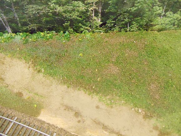

In the photo below, you can see a few cracks in the dirt. To me this looks natural and occurs in Mother Nature. Let's call this a little erosion crack.

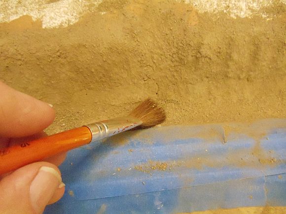

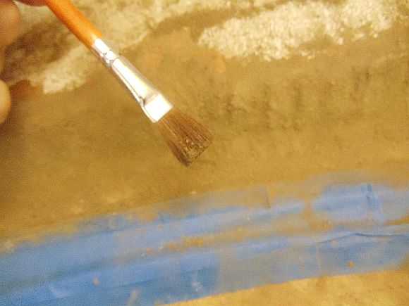

To remove the crack, here is what I did.
I sprinkled on some of the fine dirt at the bottom of the affected area. I then used a soft bristle brush to pull up the dirt onto the cracks.

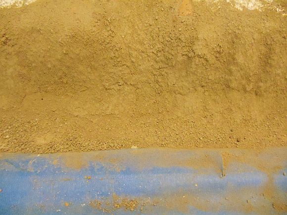

This is a photo of the same area. You can see the erosion cracks are filled in and the darker color is also gone. Basically you could say I dry brushed the dirt after the glue thoroughly dried.
The darker spots in the eroded area is light shadow.

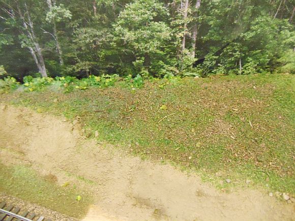

The cracks can also be covered with weeds of some sort of other type grass. In the photo below you can see weeds growing on the slope and the eroded cracks in the dirt/clay.

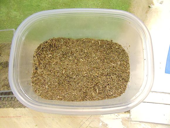

The photo below shows some ground up oak leaves and stems from the yard.
This next product is sort of from Mother Nature by way of Midwest Cork. I sanded the cork and kept the shavings. It makes great forest rot and looks good. Combined with the leaves it looks very natural.

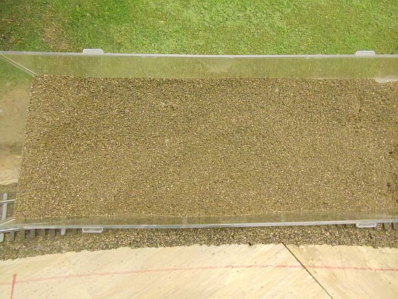

After applying the initial ground turf, I sprinkle on some of the cork shavings or cork saw dust.
I then add the oak leaf mix. By adding these two by products, I get a nice textured ground surface.

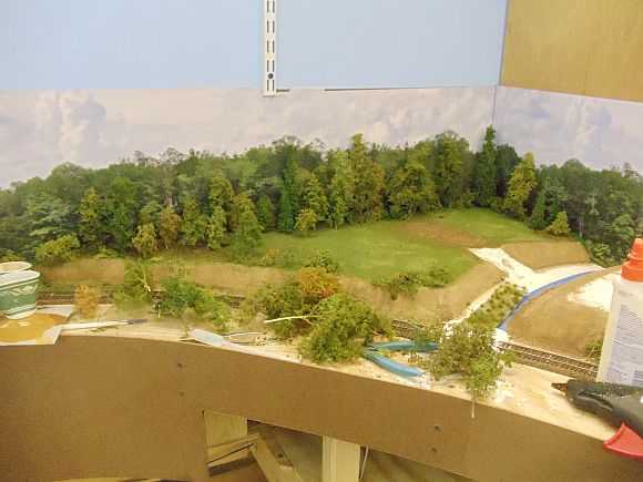

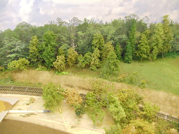

In the next photo you can see where I've added many more foreground trees around the photo backdrop.
The two open areas are where the two Cracker Houses will be placed.

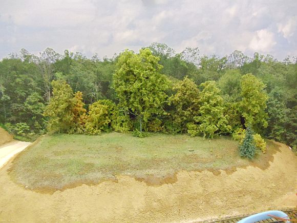

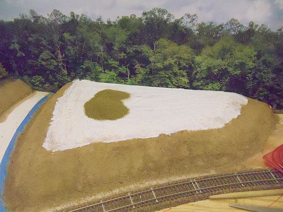

I moved on to the next sand hill and painted some white glue on the top. I then piled some Woorland Scenics Earth Fine Turf in the middle and spread it out over the white glue.
When the glue dried, I saturated the area with matte medium and started planting more trees against the photo backdrop.

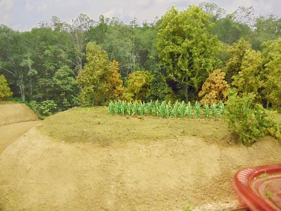

While the second sand hill was drying I planted some corn for the Cracker House folks. Notice there is no access to the corn field. You see, the Cracker's don't have the owner's permission to use his land for their garden.

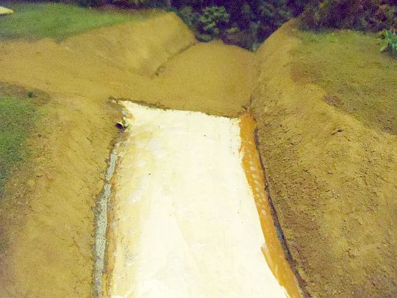

While the turf was drying and the corn growing, I turned to the dirt road.
The dirt road was built pretty much the same as the sand hills. I used the vinyl spackling over the blue foam. I again used white glue to paint the road and then sprinkled on the Fine Scenic Express dirt.
I put the dirt on heavy and let the glue absorb what it could.
